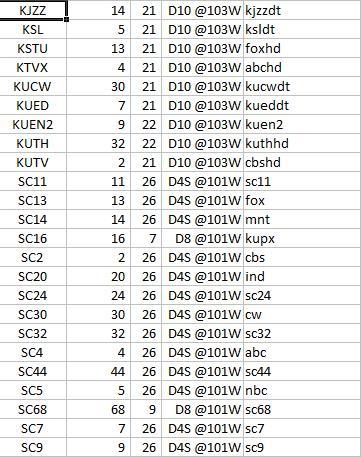

SLC spotbeams are
103W TP21 (most of HD)
103W Tp22 (PBS HD)
101W Tp26 for SD
here is the chart
1st column is callsign (the ones with legit callsigns are HD...the ones that say "SC" are SD)
2nd is channel #
3rd is TP
4th is satellite

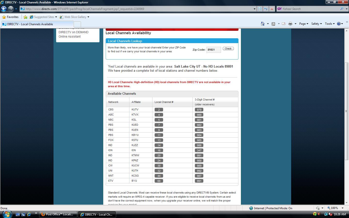

Elko city zipcodes 89801, 89802, 89803 show SLC HD locals available on their web order page.
really? You must have some magical page on DIrectv then. I pulled up all 3 zips and all show the same thing
SLC locals-NO HD
SLC locals-NO HD
I cleared my cookies and went to directv.com. I clicked packages....english. A box popped up for me to enter zipcode (89801). I clicked on "view" under the premier package. It showed all SLC HD channels available.
