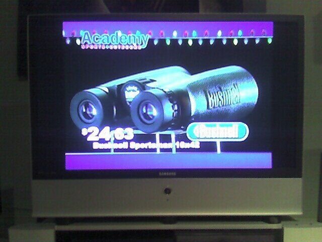

Simply put, I receive channel 27.1 KDFI in Dallas, TX (their HD broadcast), however, though the picture is wider than 4:3, it does not fill my 16:9 screen (see image attachment).
I am using an attic antenna connected to my DirecTV H20 HD receiver. Note that I do receive other OTD broadcasts in HD that do fill my 16:9 screen.
This may come down to my lack of knowledge on the subject. I guess my other question would be...can a digital signal be broadcasted that is not full 16:9/1080i?
Thank you!
Scott

A digital signal doesn't have to be HD at all. Most stations aren't capable of local origination in HD, they have to send an SD image for commercials and many programs. They usually add a black bar on each side so the picture doesn't stretch out too much on widescreens. Watch for a network HD program to see what happens.
To add to the above as well, a widescreen program doesn't have to be HD either, or 16:9 aspect ratio for that matter; there are other aspect ratios and also many SD channels that air movies not in the 4:3 but in their original aspect ratios that are other than 16:9
I assume you were hoping the Star's NHL program was HD (its not on 27). Check after the game on 27-1 for a show called "Desire"; it is in HD so you can check your setup. Post back after it starts and let us know,

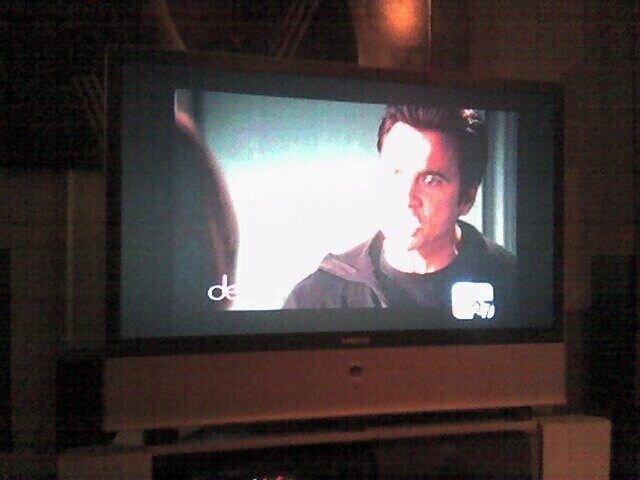

Desire- the quality is much better, however, it does not fill my screen (see attached pic). To make certain that I have everything set properly, here's a bit about my H20 receiver setup:
TV Type: Wide screen 16:9
Native: Off
Screen Format: set to Pillar Box
Resolution is set @ 1080i
Thanks!

Although the local guide and EPG say tonight's eps on 27-1 is HD, it does not appear to be so. So my bad on that one, sorry.
Check your same setup with 11-1 or 5-1 for Letterman and Leno, both 110% HD and yell back; FYI commercials will not be HD or 16:9 aspect.
Check Leno, he has Kristin Davis on right now. And if you miss these two shows, Conan on 5-1 is also in HD.

Correct. They can also upconvert as well.
See above. Odd. Fashion House is also listed in the guides as HD but not showing that way either.

I am setup 99% same, except I choose stretch mode; for all the SD DBS channels.
Letterman is in perfect HD. With that said, someone appears to not be spending money on HD equipment. Would that be KDFI in this case, or are they simply buying the rights to present the Stars with another outfit doing the actual filming?

Desire and Fashion House won't be in HD if they are delayed because of a game. 65 in Orlando shows both shows in HD, but if a Magic game is on, they show the shows afterwards. In regular format. I would assume they can't record in HD, so they are stuck showing the regular version.
