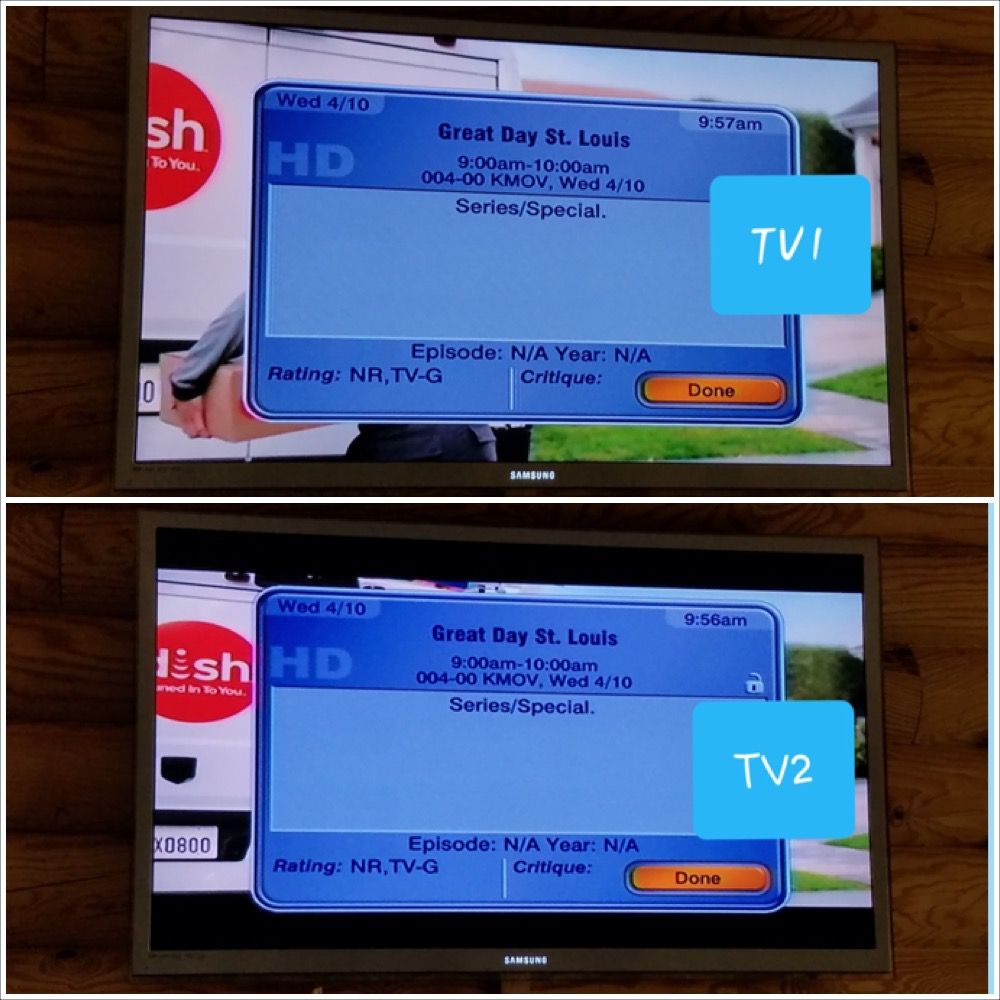

I do have a HDMI cable from the ViP722K to the living room TV and I did assume that I was seeing HD throughout the house through the coax when I had a full screen when mirroring TV1 that had a HD channel on but when I mirrored TV2 watching the exact HD channel I don't have a full screen, black bars show top and bottom. Here a pic of one of my TVs showing the same HD channel on both TV1 and TV2. Thus the reason I've been assuming I'm getting a HD picture on all my TVs via TV1 and afraid that with the Hopper and using the RF Modulator for my many TVs, the SD pic will be like what I'm getting now through TV2. But if you are verifying you are seeing a full screen, then I won't have any reason not to go with the Hopper and RF Modulator.

That's not possible unless you are running HDMI cables with a splitter, or you are using an expensive external HD modulator. Just because you are looking at 16:9 video, does not mean it is HD resolution. Both RF outputs from the VIP722K are SD. I had VIP722Ks before I went to the H3.
The H3 and a modulator (or H3 and a Joey and a couple of modulators) would be no worse that what you have now.
Joegr, thanks for the reply and letting me know you had a ViP722K. Any idea why my picture sizes are different on TV1 and TV2 (same channel and same TV settings, just paused at different times)? Don't know if you saw my reply to HipKat but using the coax from the ViP722K, the picture size on the same HD channel is different and being told I'll only be getting a SD picture using the RF Modulator, that is why I have been assuming all the HD channels will look like the picture on TV2.
Bars or not are a combination of settings on the TVs, the receiver, and the channels. You can get rid of the bars on your existing VIP setup with the right settings.

Yes I can make those changes but the picture shows the same TV, the same HD channel but one is from TV1 and the other TV2 which has the bars.
Are you saying that the format button (#, I think on your Dish remote) has no effect on the display? You would have to use the TV2 remote to change that output.
I had a 722 and I know what of I speak. The TV2 output is SD only and furthermore (in dual mode) restricts the setup so that you cannot, without zooming your TV, show the proper aspect ratio on a widescreen TV. When you do zoom an SD picture with bars, it looks like ca-ca even if the aspect ratio is correct and there are no black bars visible. What Dish never implemented is a TV2 output mode that was formerly called anamorphic widescreen such as that done for widescreen DVDs. The TV2 output can actually do that, but only if you put the 722 in solo mode.
