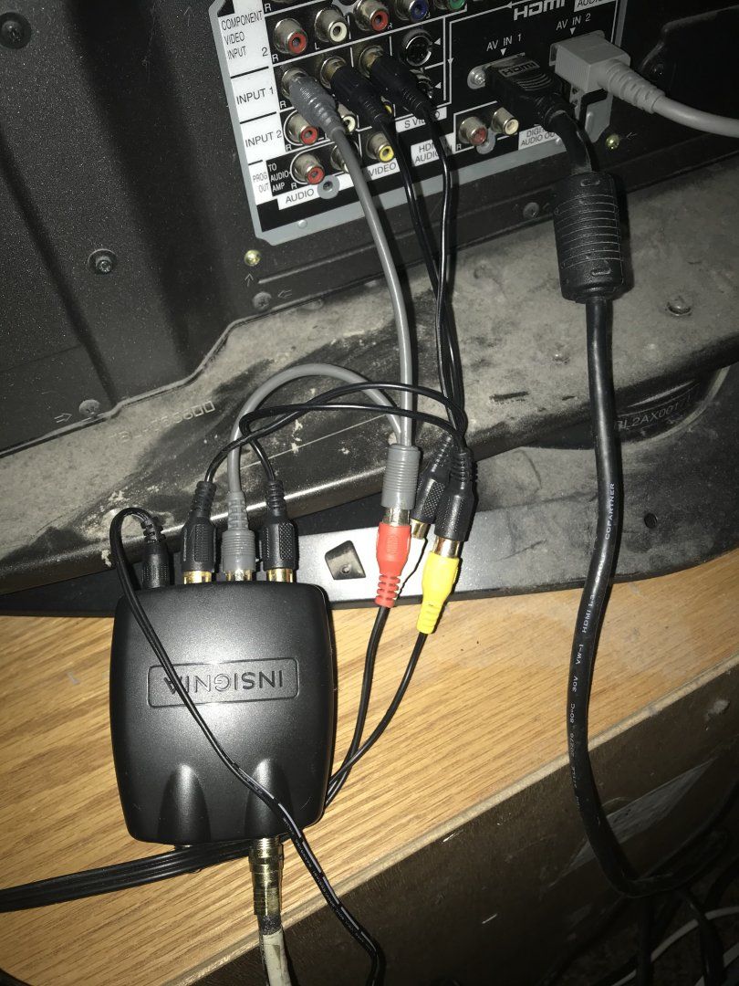

Here is the setup before I re-wire it. The HDMI and composite BOTH worked (5 mins ago) on the main TV - but not the remote TVs - unplug/replug the HDMI and the remote TVs work fine. This seems super odd because, as you can see in the attached pic, the composite feeding my main TV works fine which is the same thing split to the RF modulator. I am going to turn things on/off a few times to see if I can replicate the failure before I test another device.
If it HDCP related how in the world could the Hopper "stop" the signal on "1/2" the why splitters, but not the other half?
Does it work without the composite video splitter? You're not supposed to split composite video, you're supposed to use an amp/distribution device.
It did not work without the Y. I added the Y so I could monitor the output after it stopped working.
I just rewired it with the HDMI being split, converted to composite, than RF modulated w/ Y going to main TV. Again everything was OK on all the remote TVs but slowly they started to crap out after about 50 minutes, including the composite on the main TV which slowly got darker.
I removed the Ys from the attached pic and know it seems to be working OK on one remote TV.
I wonder if the original Dish splitter that feed each Joey which i know have feeding both remote TVs is part of the problem?
It's almost like the signal slowly degraded until the remote TVs can't find channel 4 anymore.

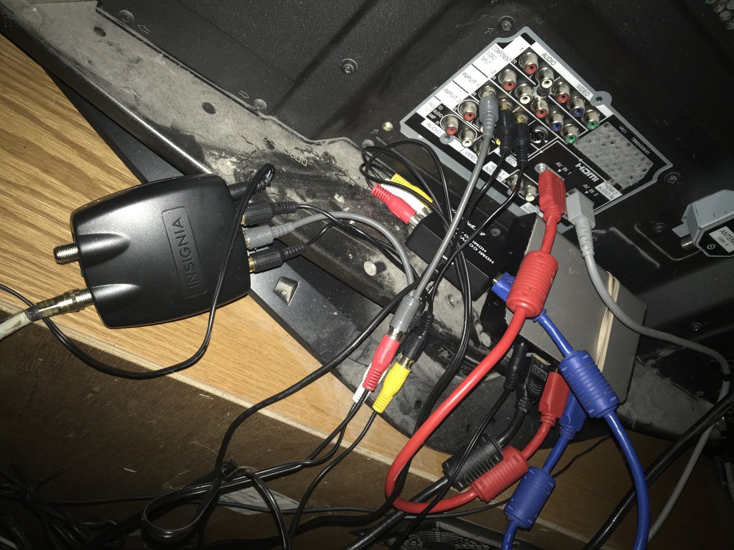

Ok. So I have had the HDMI->Splitter->converter-->RF Modulator-> 2 remote tv's hooked up for about a full day.
Last night, everything worked. Wife watched shows on remote TV in MBR, kids than watched a show using the other remote TV in Basement - no issues.
Get home for work, NO signal. Unplug/replug each of these one at a time, checking the remote TV in between: HDMI in TV, HDMi into splitter, HDMI into converter RF modulator power - each time no signal to remote TV. Reset hopper nothing.
Seems like the HDMI->composite converter is no longer an option.
Tonight I will hook up a WDTV and see how that works over the next 24 hours.
Ok. I figured it out. I am an idiot. After several days of troubleshooting, plugging/unllugging, moving the tv stand back/forth, running up/down the stairs, and a fair amount of cursing. I figured it out. I hooked up an old WD TV box one evening last week and the RF modulator and it worked fine, sending signal to both remote TVs. Come home from work, at 3:30pm, the next day and NOW the WD TV won't power on.... and of course! I have one of those six outlet doohickeys that plugs directly into both of the outlets on the wall. I plugged the WD TV and RF modulator into two of the top three plugs. Of course, in our family/living/bedrooms the top outlet of all the outlets are wired to a light switch.
