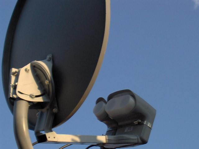

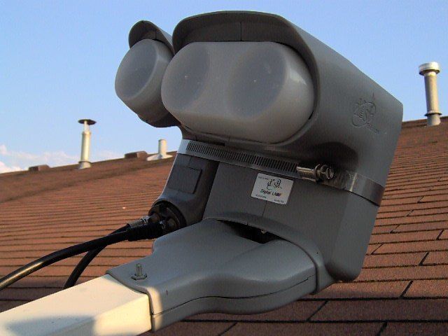

Heck if he wants to ghetto rig a LNB next to the Twin he could. Simple setup of a D500 with 110/119/129...I did that a few years ago when 129 first came online :)
poor mans dish 1000.....used to do it with 300's and offset the lnb's to make the poor mans dish 500 and like you when 129 first came online hose clamped the single to the twin on my 500...worked pretty good...

hey whats wrong with a "ghetto rig?" ;)
I have a theory in the FTA area....if you aint using hose clamps, zip ties, wood or duct tape ya aint trying :)
.....but now that I think about it my setup (2 KU dishes, a D* dish, 6 foot C-Band dish) only one has zip ties on it....use to be every dish had hoseclamps and wood to space out the LNB's properly ;)
