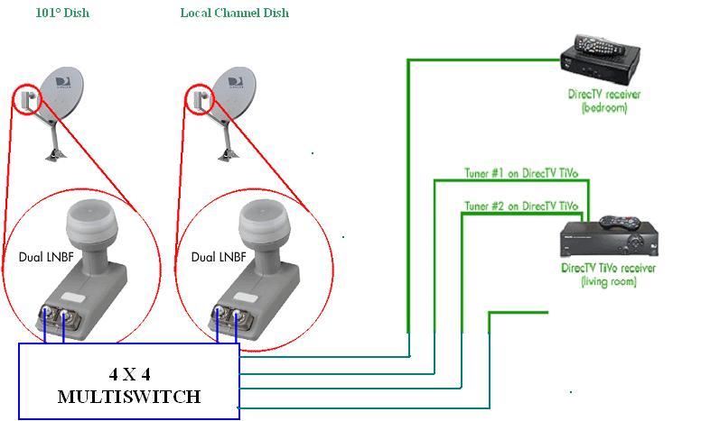

My current system is SD Direct TV, I have two satellite dishes one for SD Direct TV programming pointed at the 101° satellite, the other is for local channels I don't know what satellite this is pointed at. It's pointed about 15° east of the 101. Both dishes have a single dual LNBs. The four leads from LNBs go into a 4X2 switch with two output leads going into the house and are connected to 2 receivers.
I want to replace one of the receivers with a HR10-250 DVR to view and record OTA HD programs and Direct TV SD programs. I'm not interested in upgrading to full HD until the new DTV TiVo is released.
I think I need to replace the 4x2 with a 4x4 switch and add another line to the house. I have attached a diagram of the hookup I think I need to make. Is there any other way to do this without adding an additional line to the house?

Locals usually come from the 72.5 sat, which a bit further east than 15° away.
Anyway, to make it easy for future upgrades, I'd get the WB68 multiswitch which will support the KaKu 3LNB (99, 101,103 sats) dish used for HD. You'll need four lines from the dish for this.
