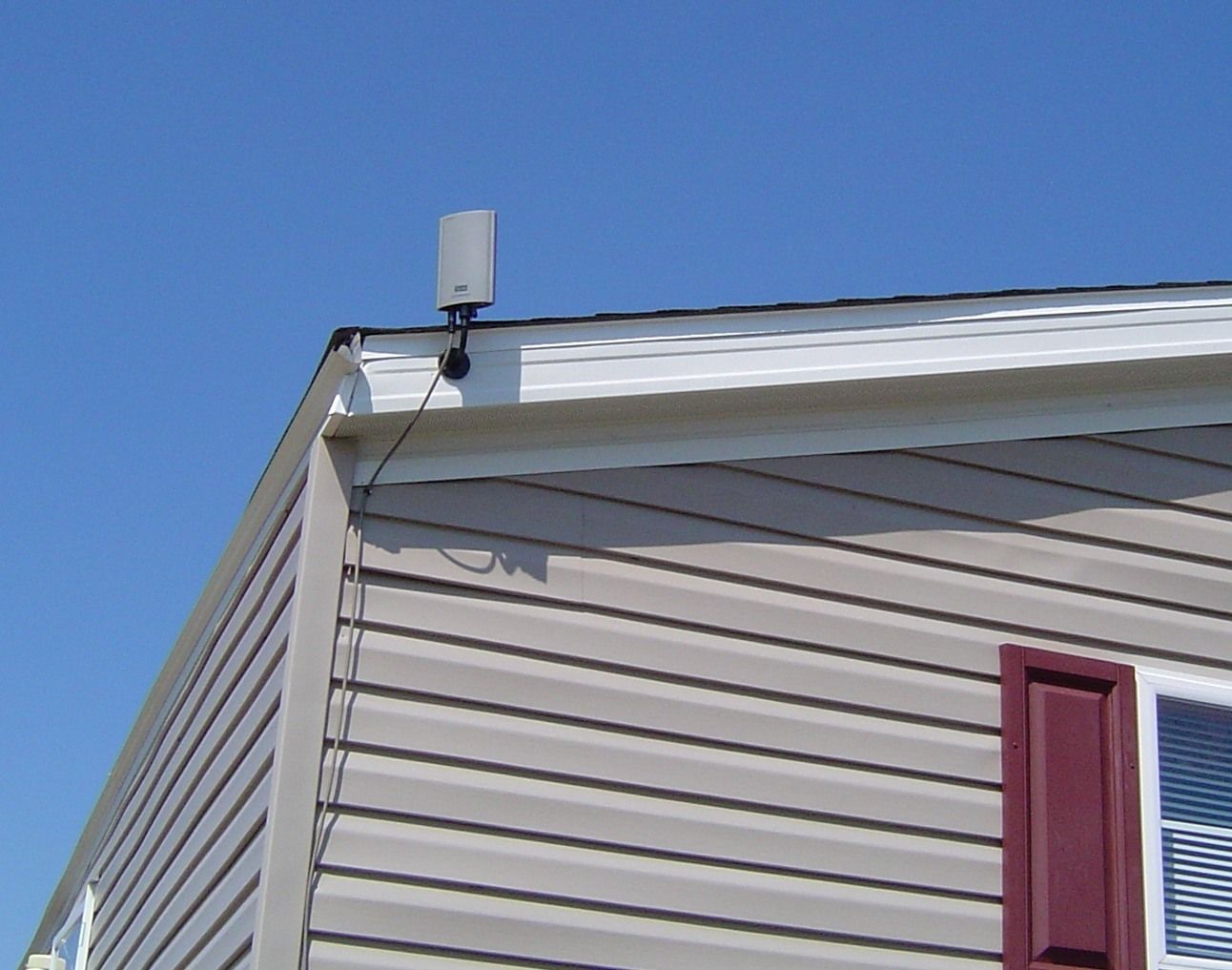

I put up my new postage stamp size OTA antenna
for receiving all the local channels in HD. It's not very big, and I am 25 -30 miles away from the towers, but it has a built in amplifier, and does an outstanding job for me.
I hooked that up the next morning after I moved in, and got my TVs all hooked up to it, and hooked up my computers and my original HDHomerun tuner for recording that I have always used.

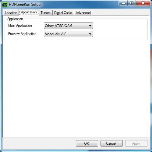

1. The setup in the HDHomerun. Part of that entails a registry setting.
2. Backup your registry, close all open programs, open regedit, navigate to:
HKEY_LOCAL_MACHINE\Software\Silicondust\HDHomeRun\Tuners\XXXXXXXX and set the BDAPIDFilter entry to "Enabled" (no quotes, case sensitive). Repeat for the -1 tuner. I got that off the silicon dust forums.
3. To get the normal ATSC OTA channels to come in, you need to set the main application in the HDHomerun setup to ATSC Remap and scan in you channels there.
4. Set the tuner in DVBViewer options/hardware to only have two boxes ticked, and they are the has CI module, and open whole transponder.
5. Scan in your OTA channels inside of DVBViewer using ATSC and the ATSC transponder list.
6. Go back into the HDHomerun setup, and change the main application to ATSC QAM remap.
7. Go into DVBViewer, and set the tuner assigned to your QAM HDHR tuner as preferred, and tick the two boxes as above.
8. Scan in the channels within DVBViewer using ATSC as the source, and using the ATSC Cable Std.
At that point, everything should work.

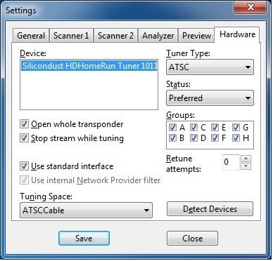

Final post with tweaked settings:
I followed Griga's direction above, and unticked the CI Module, and unticked the Open Whole Transponder box.
I did however tick the box by the Stop Stream While Tuning.
I did not change the registry setting that I had enabled in the previous post.
DVBViewer will not scan in channels with the tuner being used is set to normal. I had to set the other tuners to "Do Not Use" in order to get the channels to scan in, while setting the tuner being used to "Preferred".
DVBViewer will change back and forth between OTA and QAM with both tuners set to normal, but the channel switching is very slow, and sometimes only the audio comes in. I get much better performance with setting the tuner that I am using to Preferred, and setting the other tuners to "Do Not Use".
Part of that may be due to the speed of this computer. It is a P4 3.2Ghz with 2GB of RAM and SATA hard drives. It does have an Nvidia GeForce 6200 video card with 128Mb of video RAM running Windows XP SP4.
DVBViewer scanned in all the clear channels, but scanned in a few with audio only. I used the channel editor and set the Video PID to be the ame as the PCR PID, and the channels came in and displayed fine. :biggrin:
I am very pleased to have it working in DVBViewer.

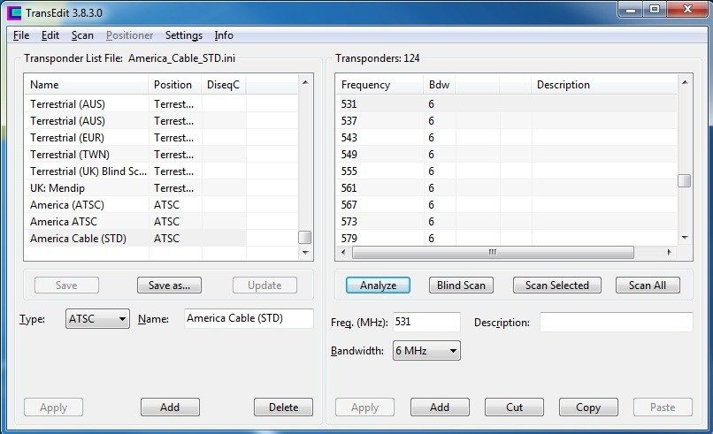

I used the same Transponder list, and set the tuners the same way in Transedit with no results.

I got Transedit to work and scan in the channels for both OTA and QAM as well.
