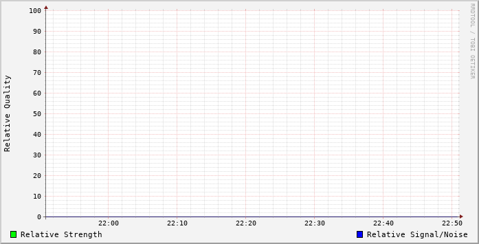

Channel 19 graph:
https://www.rabbitears.info/tvdx/render_graph/109018A2/tuner0/19/-1hours/now

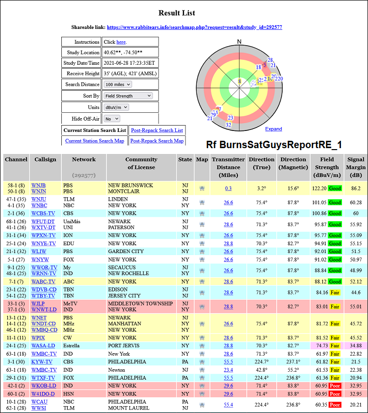

Based on your TVFool report image, here is a rabbitears.info signal report:
RabbitEars.Info

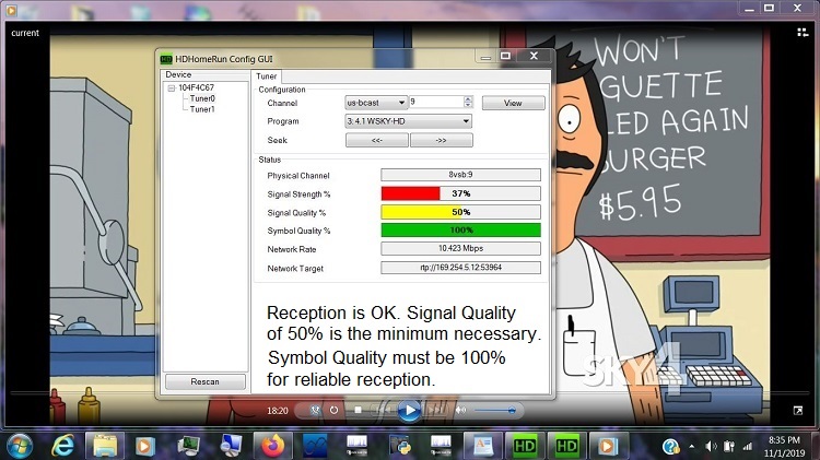

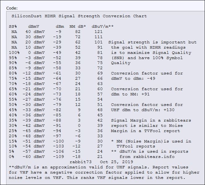

The HDHR GUI only gives Signal Strength up to 100%, which is about equal to what a TV wall outlet should give. However, TV set tuners can tolerate signals much stronger. But, SiliconDust support has a tendency to say you have overload if you call them with a reception problem.

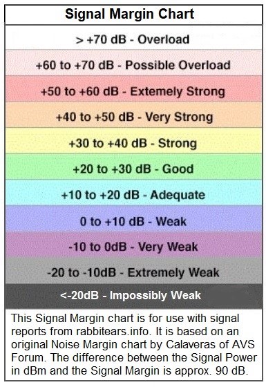

To the Signal Margin on a rabbitears.info signal report you must add the antenna gain and the preamp gain for the above chart.
