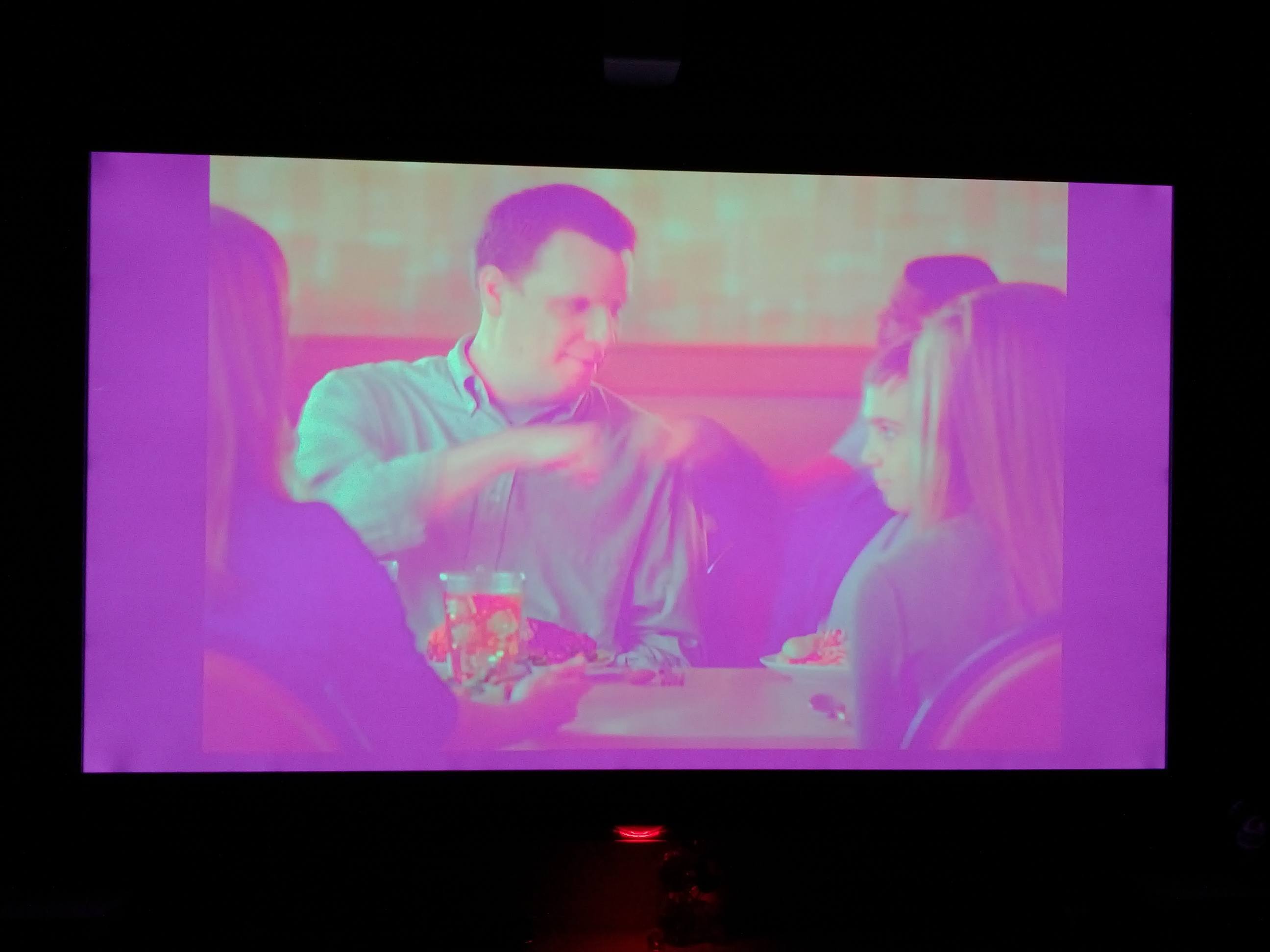

Hello,
I have the hopper for several weeks now. Everything was working OK, but now every time I turn on the hopper the picture has a lot of pink color and no audio.
The only way to get rid on it is to reset the receiver. My other devices that connected to the TV via HDMI display correct colors.
Has anyone have seen similar issues with their hopper?

Thanks for the suggestion. That did not worked for me. I can also switch the TV aspect ration from 1080 to 720 and back and that should fix it, but honestly I should not need to do this at all. It should work in the first place. Most likely I will call dish and request a new receiver.

I had this happen to me the other day (for the first time)
I changed the HDMI input via my remote control then back to the Hopper HDMI input and all was fixed. No reboot of the Hopper was necesary.
