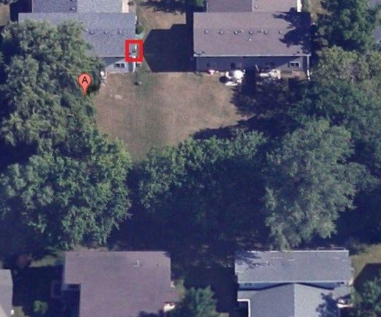

Picture of my location. I believe this already shows my satellite dish installed on the corner. I circled it in red. Right now for 61.5 its aimed SE, but not to the coordinates that dishpointer.com gives. 110 and 119 would be aimed to the SW. Are those trees an issue? Dish not mounted up high enough on house?

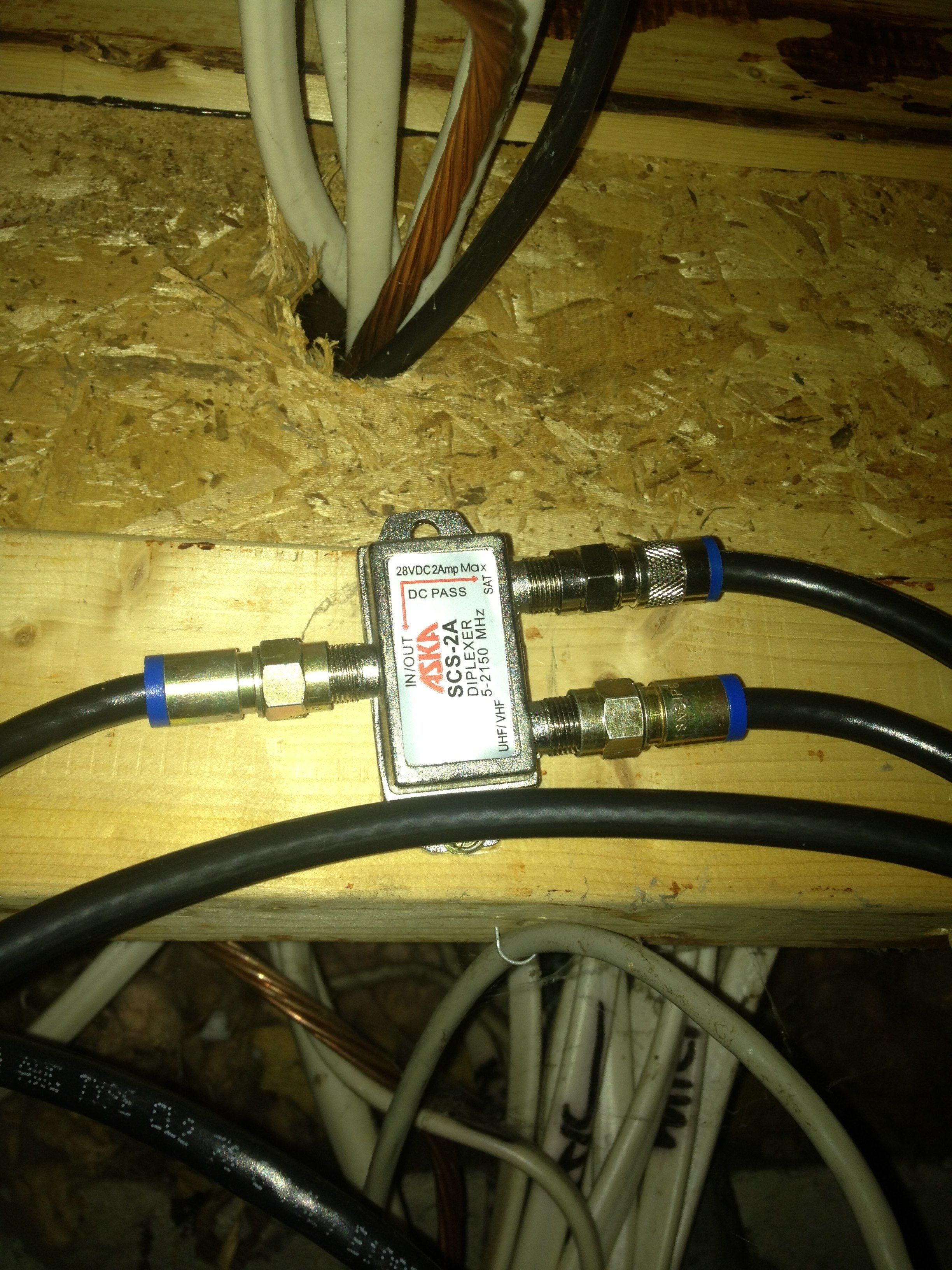

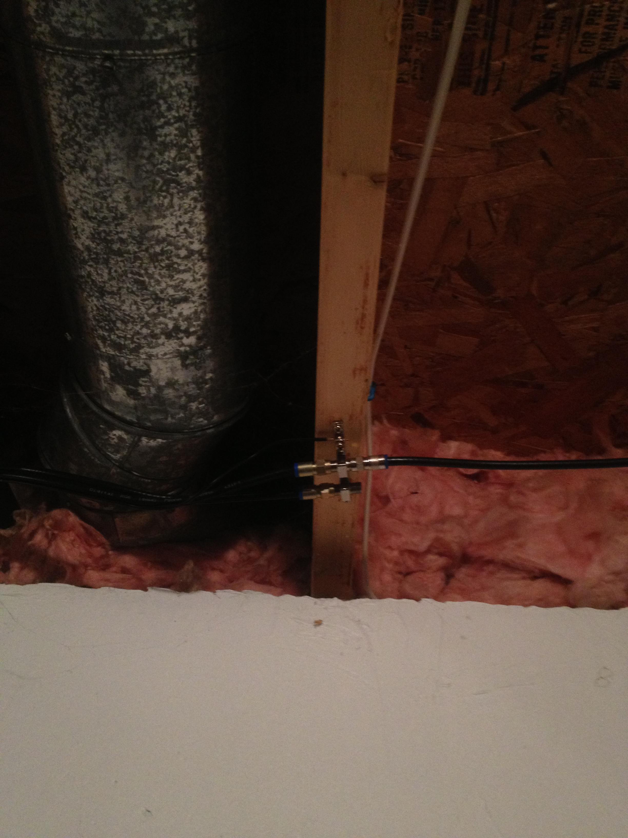

The 2 coax lines from the dish run to this splitter point

From their only 1 coax line runs to this next splitter point. Might be a switch?

To the OP, what you're calling a splitter is actually just a ground block. The other (bottom) picture is almost certainly a diplexer to backfeed the TV2 output to your upstairs TV. There should be another thing that looks like a splitter, but is actually a "separator", which takes the bandstacked signal from the dish and feeds it to the two sat tuners in the 722. Is that still there and connecting both tuners?

The bottom "splitter" is actually a diplexer. It with the triplexer at the receiver is how DISH receivers backfeed a second tv.
The second to bottom "splitter" image with two lines in and one out is a ground block. It helps DISH ground the system from lightning, provides an easier to access service point, and makes it easy to feed additional receivers if you ever added rooms.
