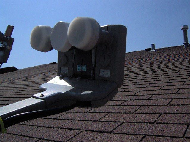

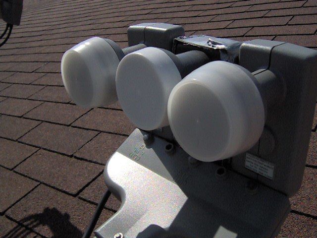

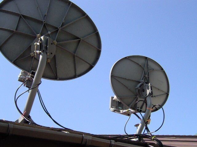

The LNB is wrong but it is possible to get 3ABN on a Phase 3 type dish. The signal wont be the strongest but will work. You need a KU LNB
I use to have 101 on a Phase II (which had 3 removable LNB's) The other 2 were for 91 (when it had a couple freebie channels) and 110 (for the dish sub)
