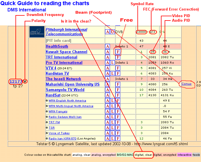

PSB On vacation Nov 5, 2003 3 5 Aug 28, 2006 #3 This should get you started! http://www.lyngsat.com/freetv/South-America.html Guide to reading the Lyngsat charts....... http://www.dmsiusa.com/charts.htm Pay particular attention to the satellite "Footprint or Beam" See below picture! Attachments t5rc.gif 46.4 KB · Views: 183 Last edited: Aug 28, 2006
