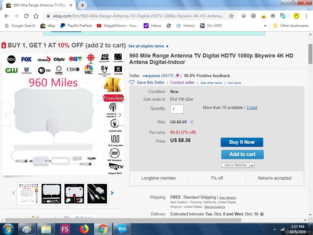

On ebay I saw a indoor antenna that you stick on the wall, and plug
right into the HD-TV set. Or into a STB. The indoor antenna, they say
has 960 miles range.

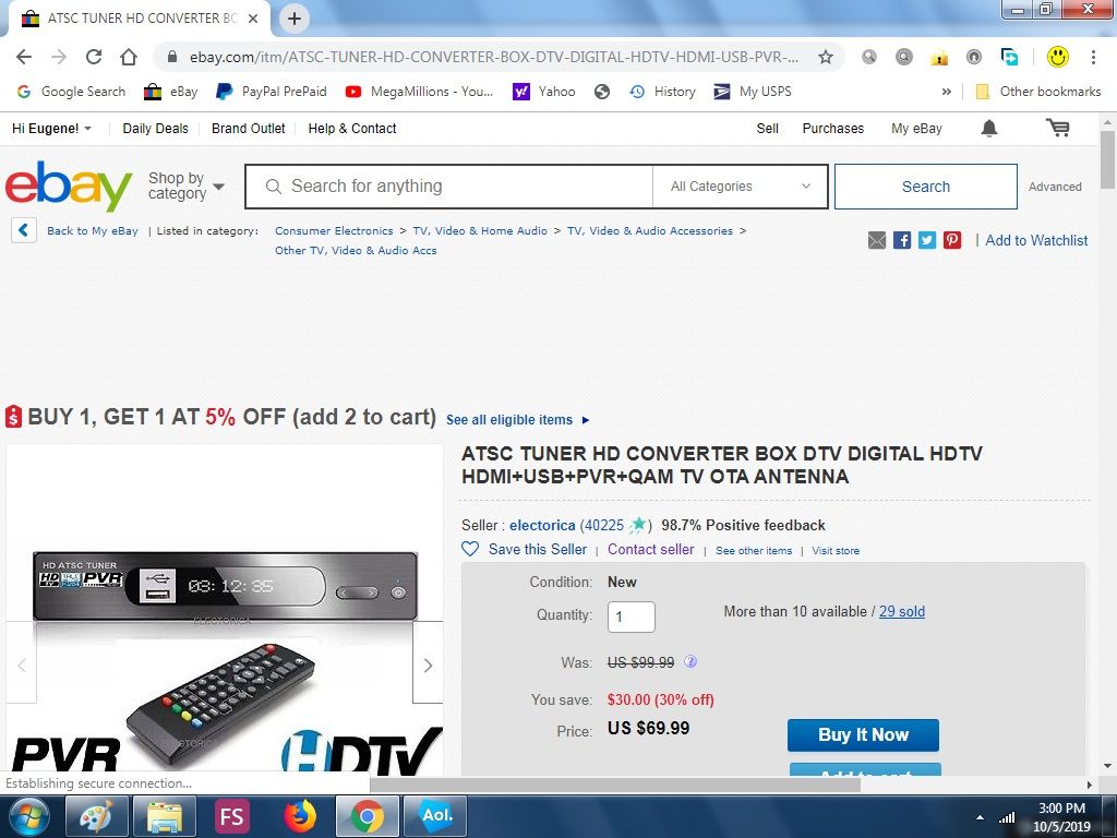

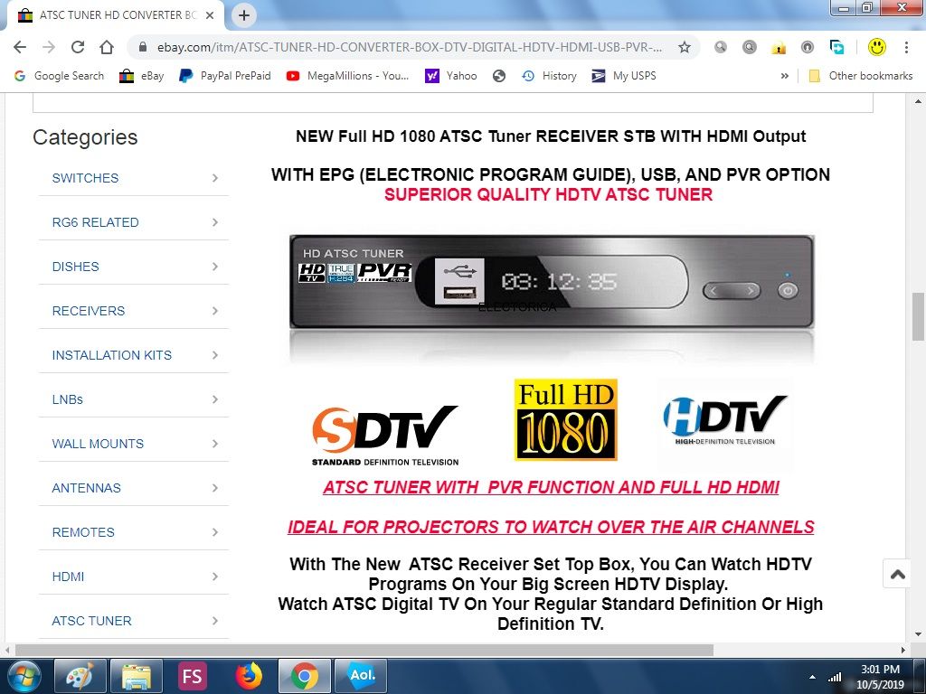

And the STB on ebay is the
ATSC Tuner HD CONVERTER BOX DTV Digital box.
ebay item number: 222981262407

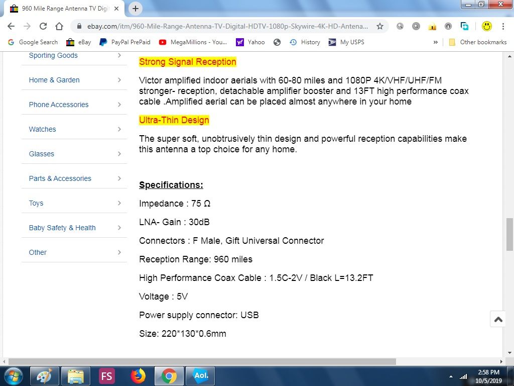

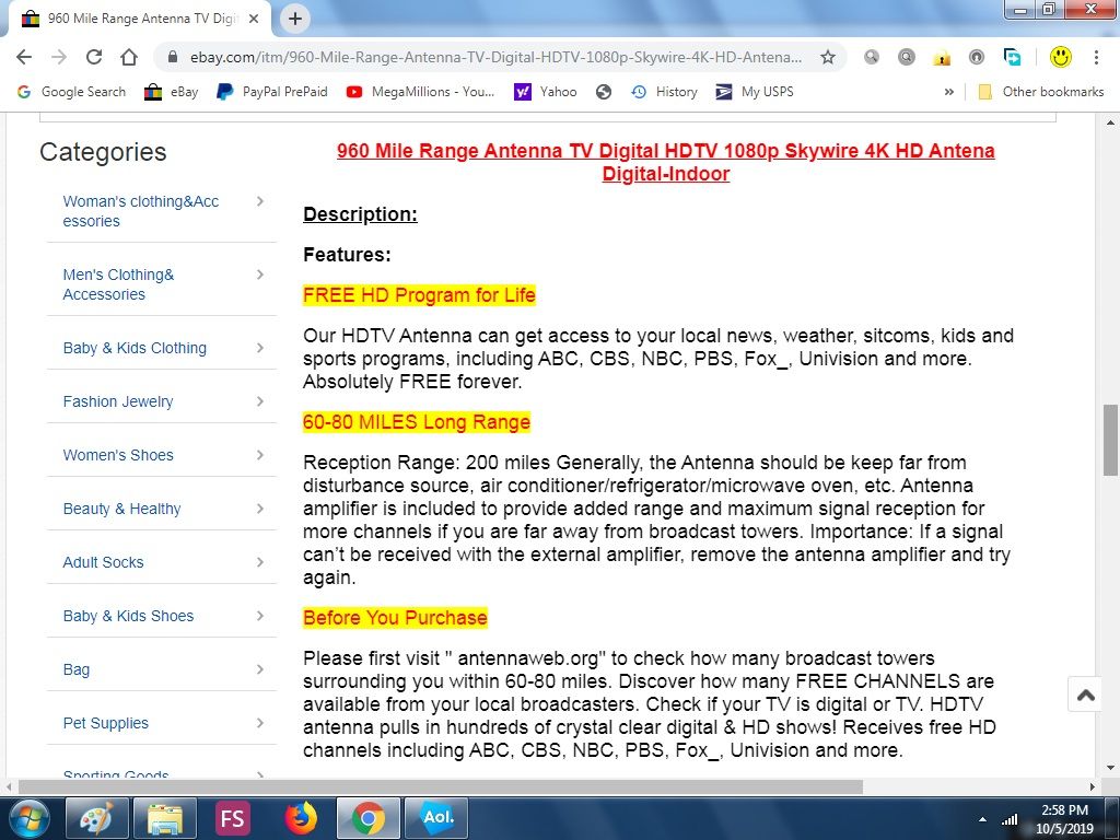

There is no 960 mile range OTA antenna. Indoor or outdoor. 60 miles is considered good. Outside antennas are generally better than antennas inside attics, which are generally better than set top antennas.

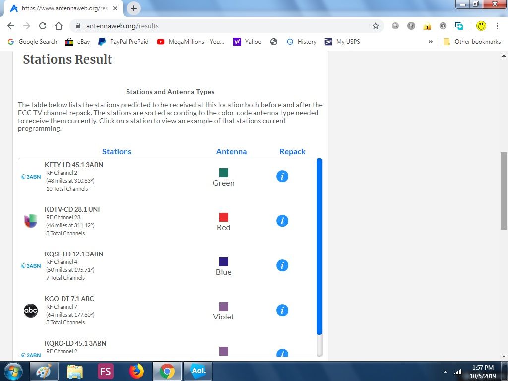

You need to check their address with antennaweb.orb and see what stations are available and in what directions. Post that image here and we can help you.

Here's the screen shot from Antenna site that I looked up for Gerry in Napa.

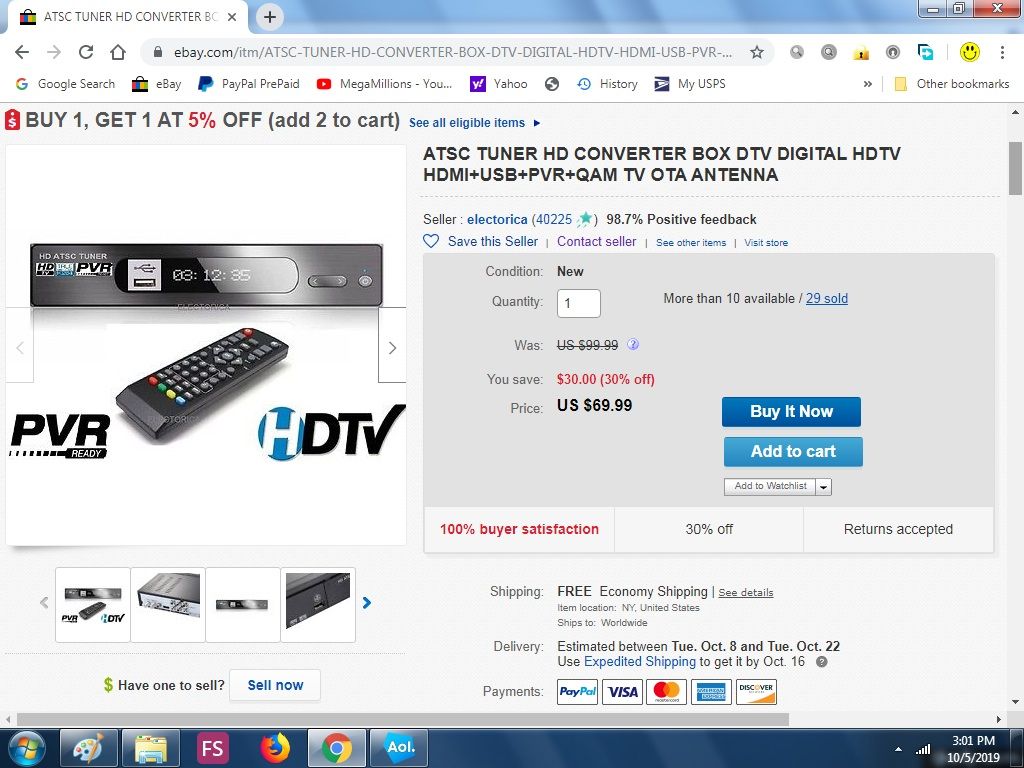

Here are screen shots from ebay that I mentioned in my FIRST Post.
Did you notice that 960 mile antenna also states 200 miles range and 60-80 miles range in the same auction listing? o_O:D

The antenna is crap.
You probably don't need that STB. Get them to photograph the connectors on the back of the TV. If you see a coax connector, especially if marked "ant in" then just connect a decent antenna to it and they will get OTA.
Now, as to which OTA, I'll have to study your antennaweb results. Can't right now.
As to a DVR, that's another discussion after we determine what if any OTA stations you can get. That "PVR" is probably not the best choice. And we need to determine if an omni will work or if a rotor is needed.

Yes, I am from Central PA. Agree with navychop that there are no 960 mile antennas. The curvature of the Earth simply won't allow a tv signal to travel that far under nornal atmospheric conditions. Also agree you need to get the model of your brother's tv and post it here. Likely it has a tuner capable of viewing ATSC OTA channels and he would not need a stand-alone box at all unless he wants to DVR. :) Is the zip code 94558 correct for your brother's location so we can get a rough estimate of what stations may be available?

Since most stations are line of sight and under 40 miles from Napa, that antenna might actually give him enough channels to make him happy.
As Navy chop said, it's not a very good antenna and is UHF only and 40 miles might be near it's max range.

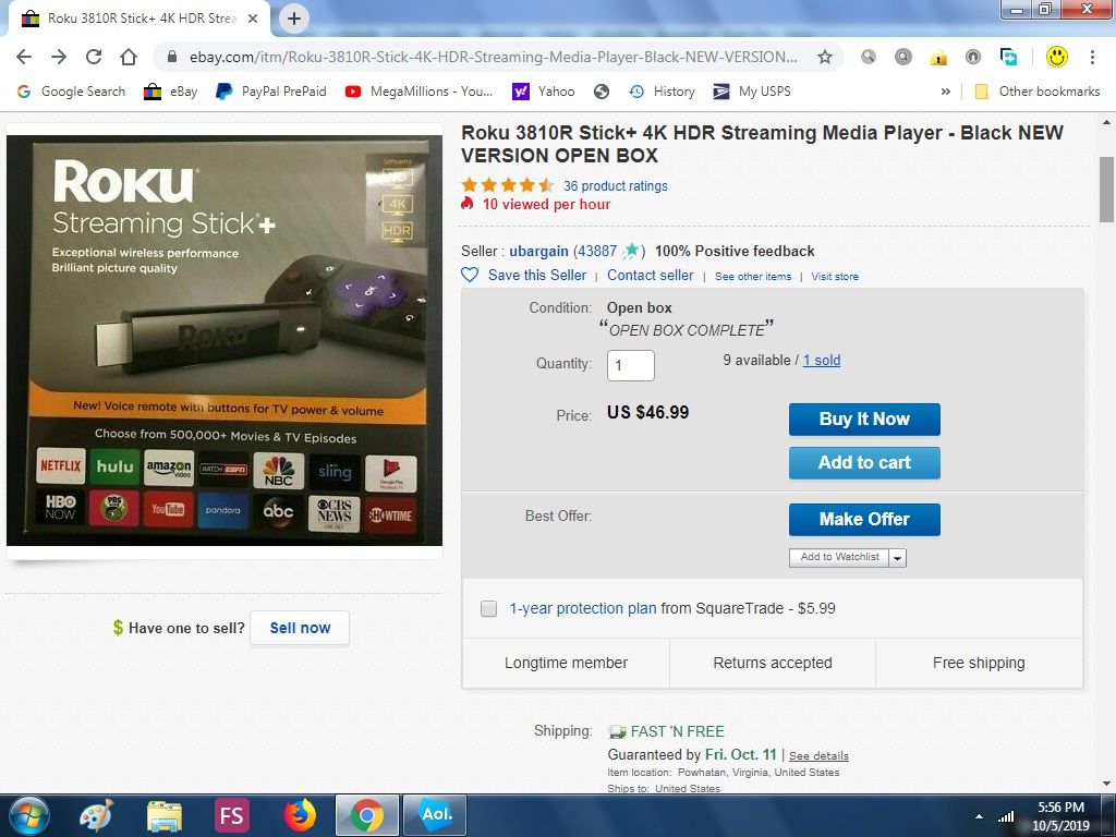

How about this roku??? It's NEW as a USB stick.
Would he only insert this into the USB port on his HD-TV????
And go-and-play from there???
See screenshot below from ebay.

I doubt he will be happy with cell Internet for Roku. But without knowing speed and caps, we can't tell.

40 miles for an indoor $8 antenna? I'd bet against it.

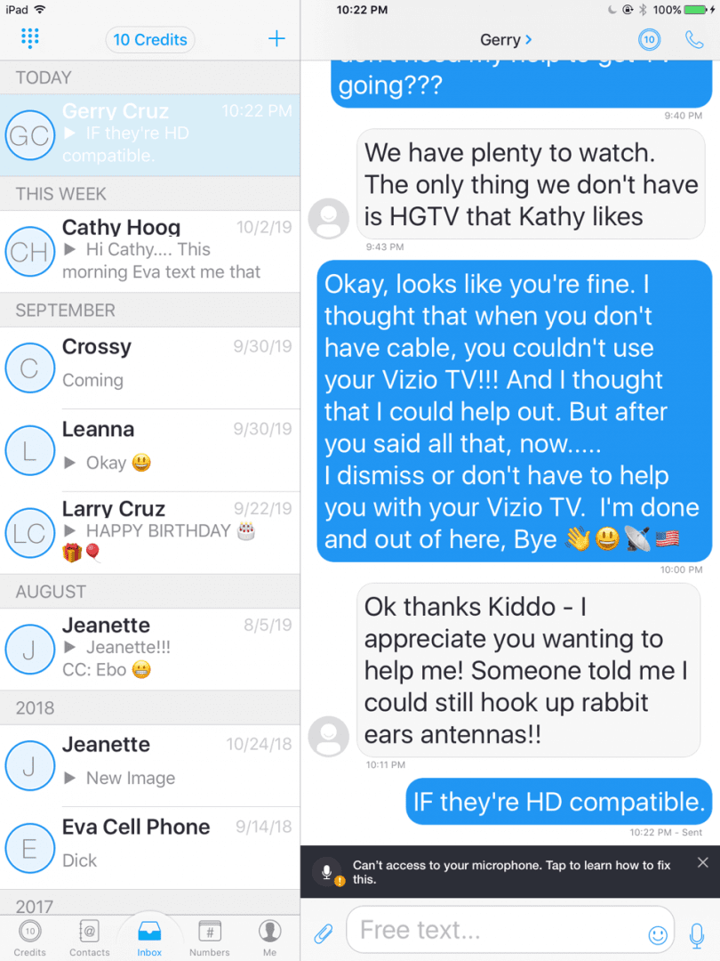

Hi Folks,
It looks like, and I found out that my brother in Napa, California is fine.
I do not know what he's using but I'm showing you a screenshot of his
text message, and you can see it yourself.
You might think that he's alright and don't need to help him.
Waste of time. I thought he needed help when he said
"NO COMCAST CABLE TV", made me thought that he can't
use his Vizio TV. But apparently he does for other channels.
My text message to my brother is in BLUE
My brother 's text message in Napa is in WHITE.
Thanks,
Eugene
