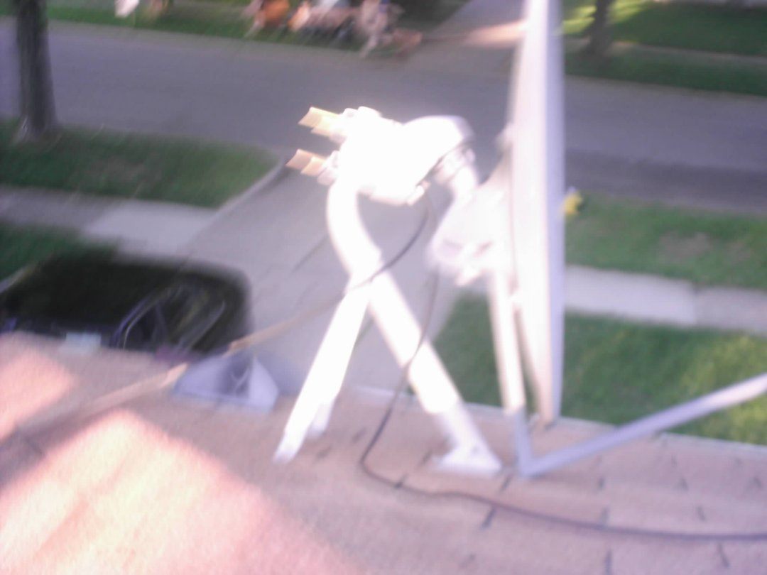

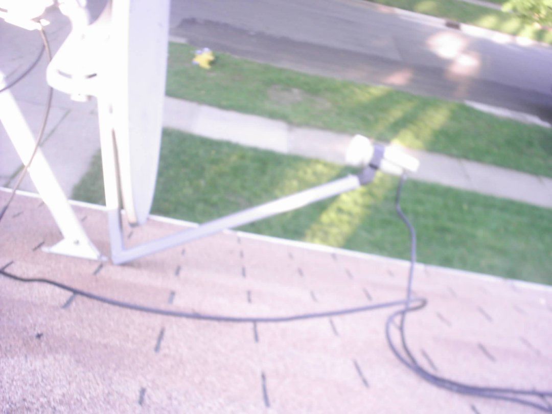

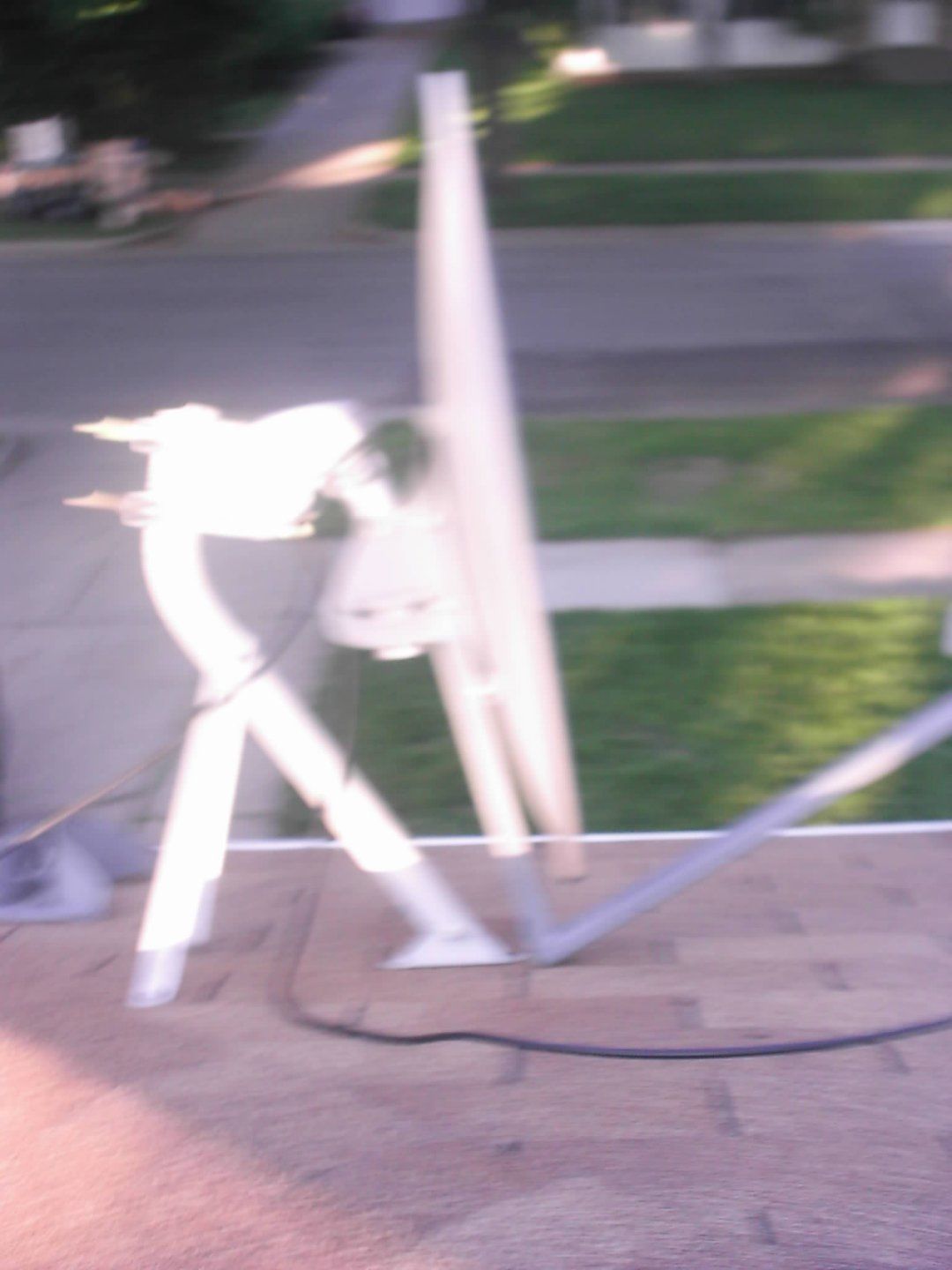

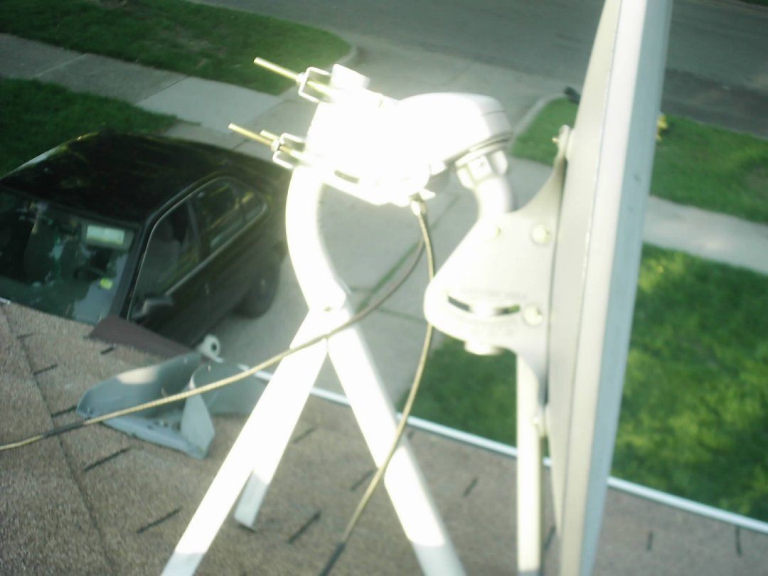

Hello again guys,hope u all doing good.
some of you might know, but i am trying to install my motorized dish on my roof, and by the ways thats the only way i could hook it up because on my backyard. trees all over the places, and in front yard,. i have to put it right in the middle of my yard, which would be so gay, and i think my neighbors would make a big fuss about it, but any ways, see i think on my roof, i can't have my dish every whhere either cuz of the trees, but i figured that i can only have a stationary dish on my roof, because the dish its on the roof, it won't move around i think, so it can be only stationary, unless some one can tell me where i ccan get a long pole mast for the roof, i just got a universal mount from sadoun, i thought that might help, but its short also unless i am doing some thingng wrong, here is a couple of pictures,
i would really appreciate any help, for poling mast or any thing like that, i don't wnat to get any thing that passes 50 dollars
so what should i do guys, here are couple of pictures
thanks in advance
Abas
look at the pictures?? this is my problem i think
do you agree with it??
what's my solution. is there a long pole i can put on the roof, because the one i have, i like it, but my roof you know its not leveled.
any ways, what should I do now
A.M

There are larger pole mounts available so that you can clear a roof (sloping up). I think Iceberg had the same problem over the weekend.
sorry i did what u said with the pics??
IceBErG how did u solve the problem
thanks??
The mast is not plumb! The mast should be rotated 90 degrees. Use a level to make sure the mast is plumb and level all round or you will never get any where.
The mast supports should be on the lowest part of the roof (towards the edge), then the mast will be higher up the roof, thats your problem!
You may still need a slightly bigger mast to ensure the dish clears the roof when it motors!
If you have a look at the grey satellite base you have on your roof right now, it will show you the direction the mast will have to be!
I would mount it on an eve if you could, and agree with last post, arm should be as plumb as possible and turned around. Don't worry about trees if they are a ways away i.e., 100 to 200m, you should be fine.
