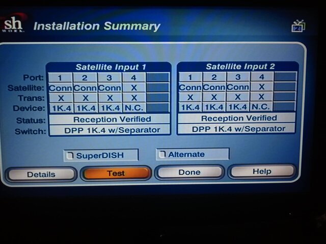

The problem lies in when I set my DISH at the recommended settings (47.8, 217.7 and 121.8) I'm not reading any signal at all on 110 or 119.When I test switch I am getting CONN on Ports 1,2,3 for Satellite "X" on Ports 1,2,3 for Transponder Status "Reception Verified" Switch DPP 1K.4

I hate to say it but your numbers are way off. You are running numbers for Western Arc (110/119/129). The issue is you are on Eastern Arc (61.5/72/77). I assume you have Lake Charles locals? Also in the pic you provided it says Dish 1000.4 which is Eastern Arc

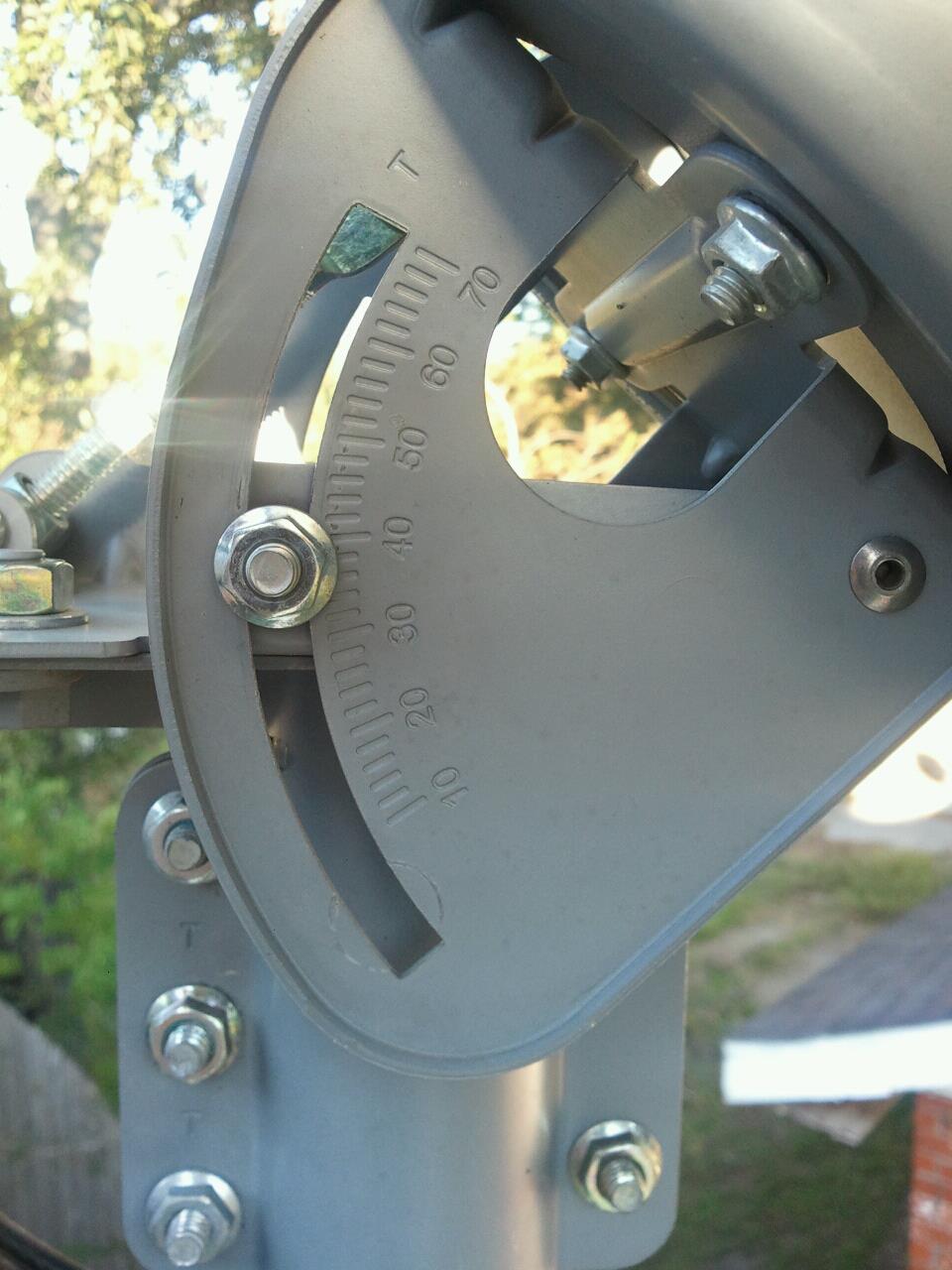

On the elevation, do you set the angle with the screw or with the brace line that comes across the gap?
(I attached a pic of what I THINK to be 48 degrees)

as for the pic yes that is right for 48 elevation...its usually the edge and not the nut

Test Switch came back with the same results I posted in my first post
OK, when my son got home we worked together and adjusting it as finely as I could and managed to get a signal of 38. (10 stronger than when I first started this fiasco)
TV started working again, but my local channels are not there.
When I test switch I get
1 2 3
72 conn conn
OK X X
What should be my next step?
