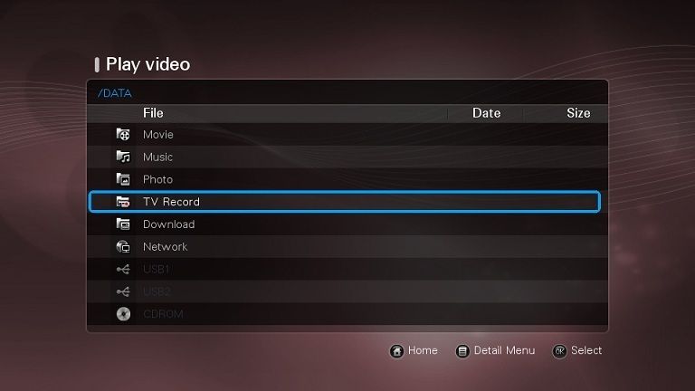

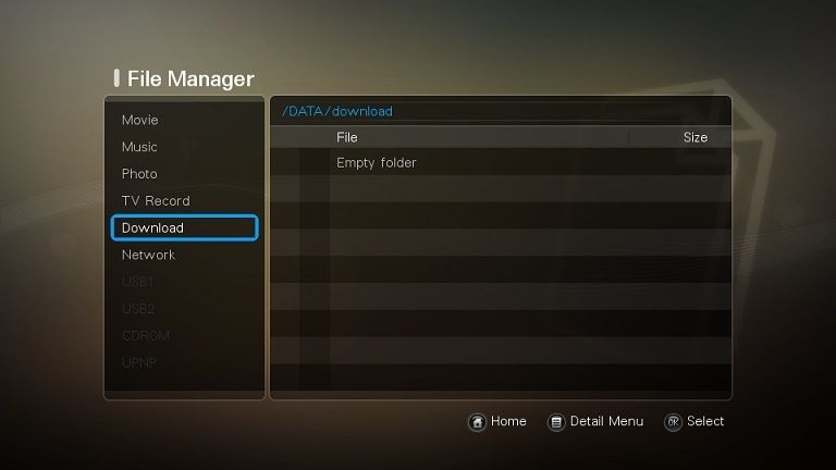

You know I've used Maz for awhile now and saw that camera screen but could never make it do anything before.
Now with your explanation it makes sense.
I was able to take the pics but trying to upload them here I get some incorrect extension error, something about png file being called a .jpg file or something.
Ok now according to your pics posted Radar at one time you had something attached to the USB drive (Screen 2), while you have an internal HD.
Once you took the USB drive off the receiver you should no longer be able to access this feature on the receiver. (screen 1) according to your pics.
So I hope you now see what I am trying to say all along here.
ok I had to try this again, had to use another program and save them differently.. I hope it works this time.
as you should be able to see, nothing attached to USB so I can not even access that area, the receiver will not let me, unlike what was posted by Stan.

Thanks Radar,
Stargaze,
When I use MaZ to take screen shots, I save the pix to my desktop for quick and easy access.
If you right click on the image and select properties, it shows that it is a *.PNG file, which is not supported by our attachment manager.
I double left click on the image to open it and down at the bottom, in the images tools menu, there is an ICON to the far right (next to the [?]) that opens Microsoft Paint to edit the image.
It closes the current image and opens Paint, then all I do is SAVE AS and rename it as I desire and select *.jpeg as the file type.
It took me a while to figure out that the image MaZ generates was the *.PNG type.
As for Stan's setup, I was under the impression that he did NOT have an Internal HDD at all, just an External Maxtor HDD with USB cord. Stan will have to confirm this.
