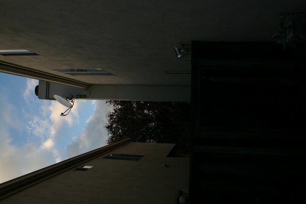

I had pointed my DirecTV dishes (TV & DirecPC) in the past, but that didn't really prepare me well enough for mounting a motorized 36" dish 21 feet in the air on the side of my house. Unfortunately that is the best spot to get most of the arc.
Start out on the ground and with just the fixed dish setup if you can. Finding your true south satellite from the top of a ladder is tricky the first time you do it.
