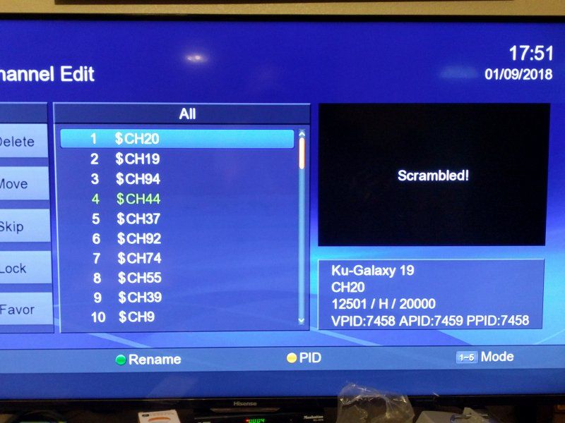

They just have numbers such as $CH20.

I think that might be 110W Dish Network, but that VPID (7458) on that frequency does not match with your location (based on the info on Lyngsat, might be outdated), so i'm not sure. Also I'm a bit surprised to see 2-digit channel names, usually DN channels come up as 4 or 5 digit numbers

With the transponder you are showing on the one channel highlighted, I think you are aimed at 91w, Nimiq 6.
