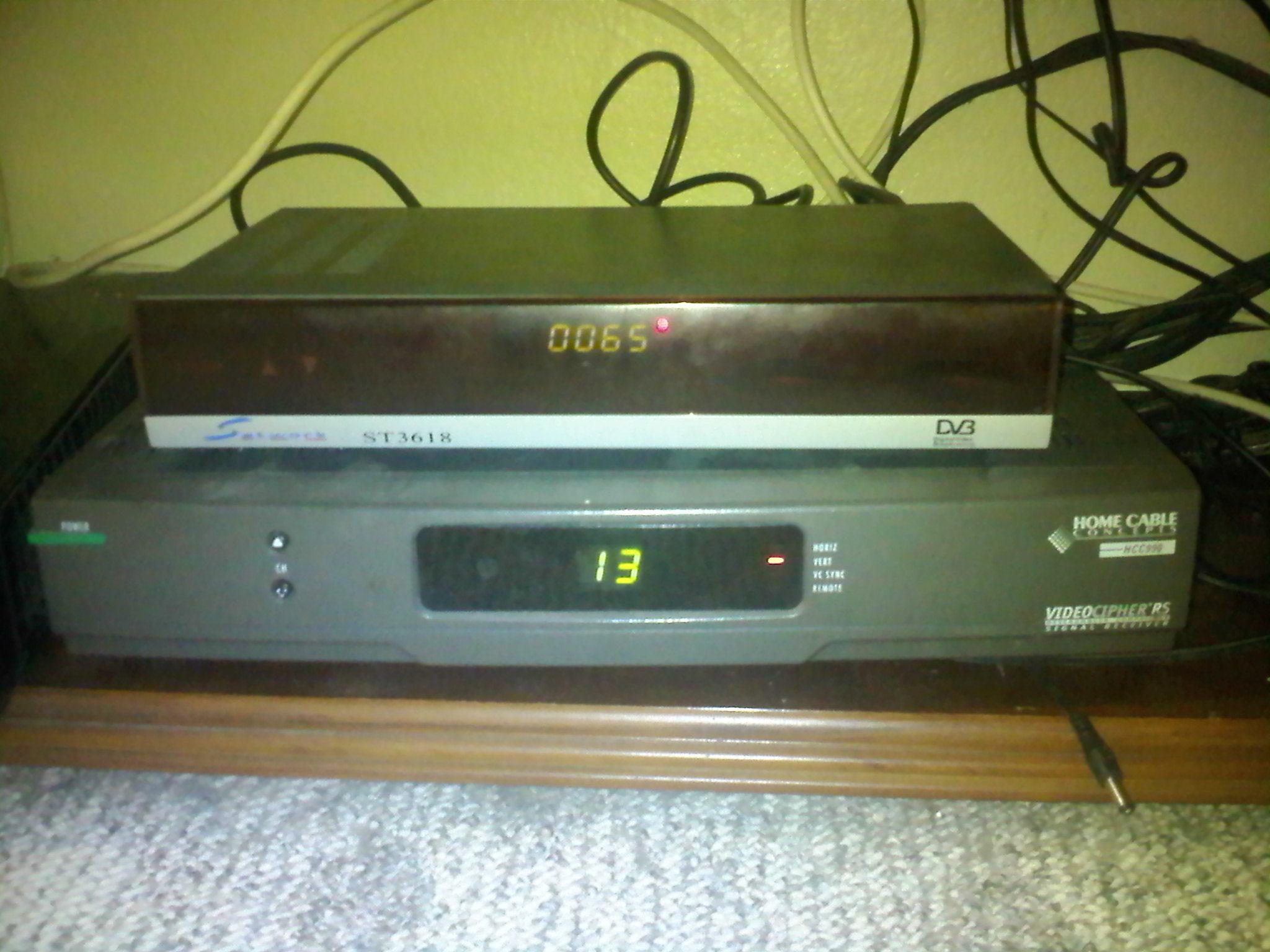

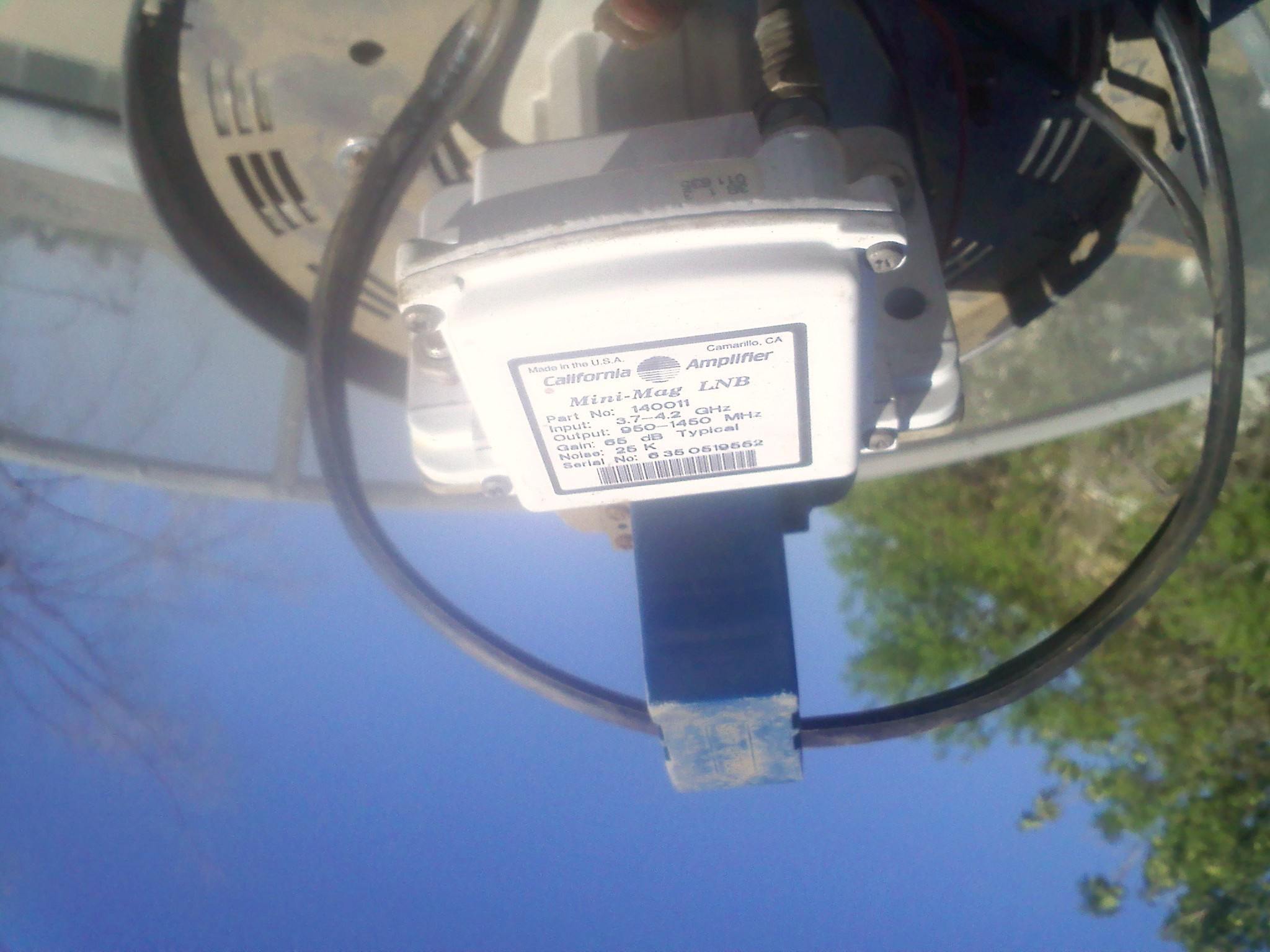

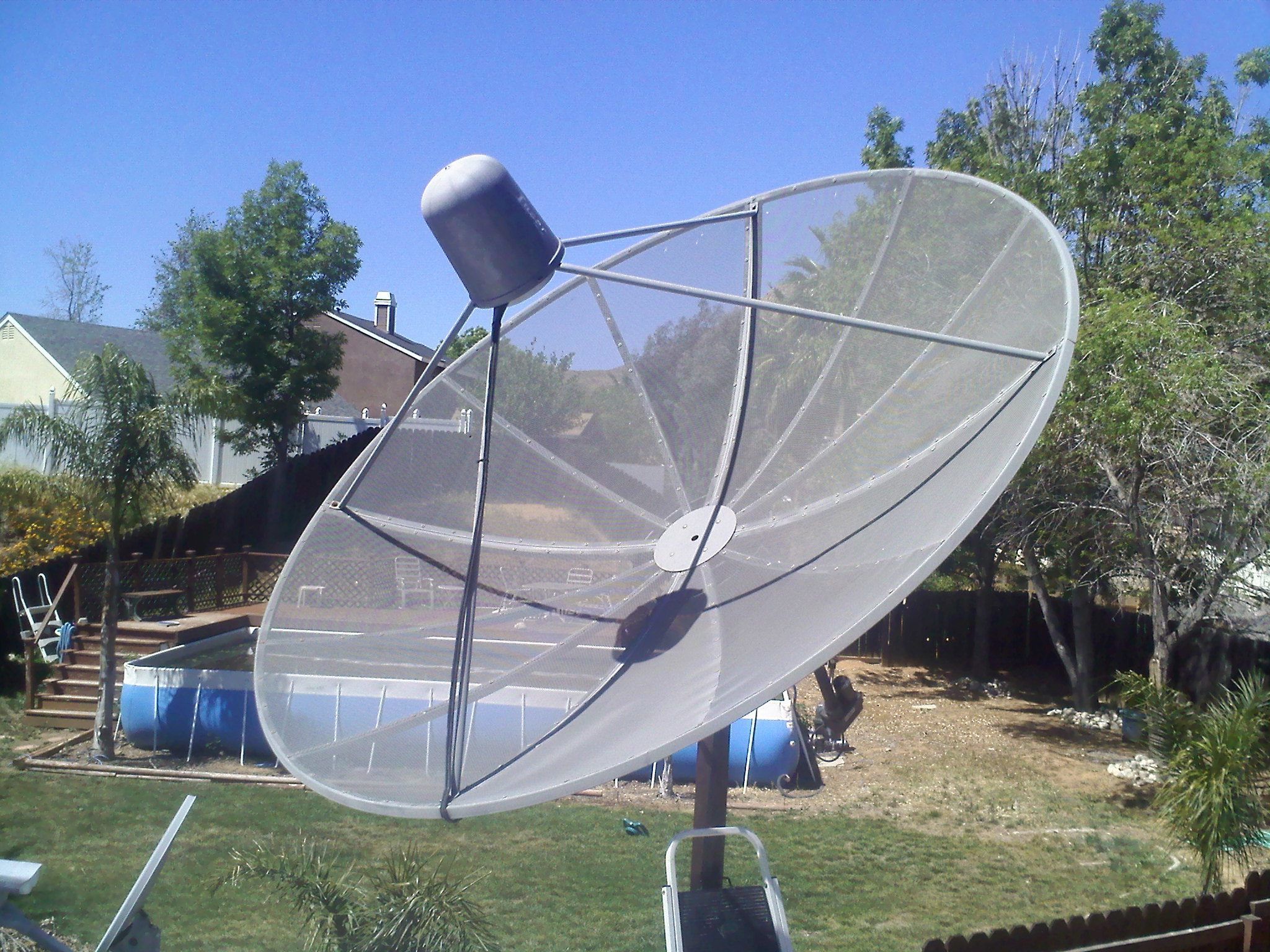

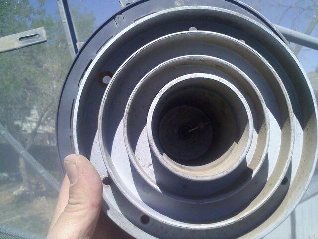

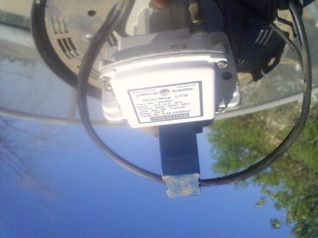

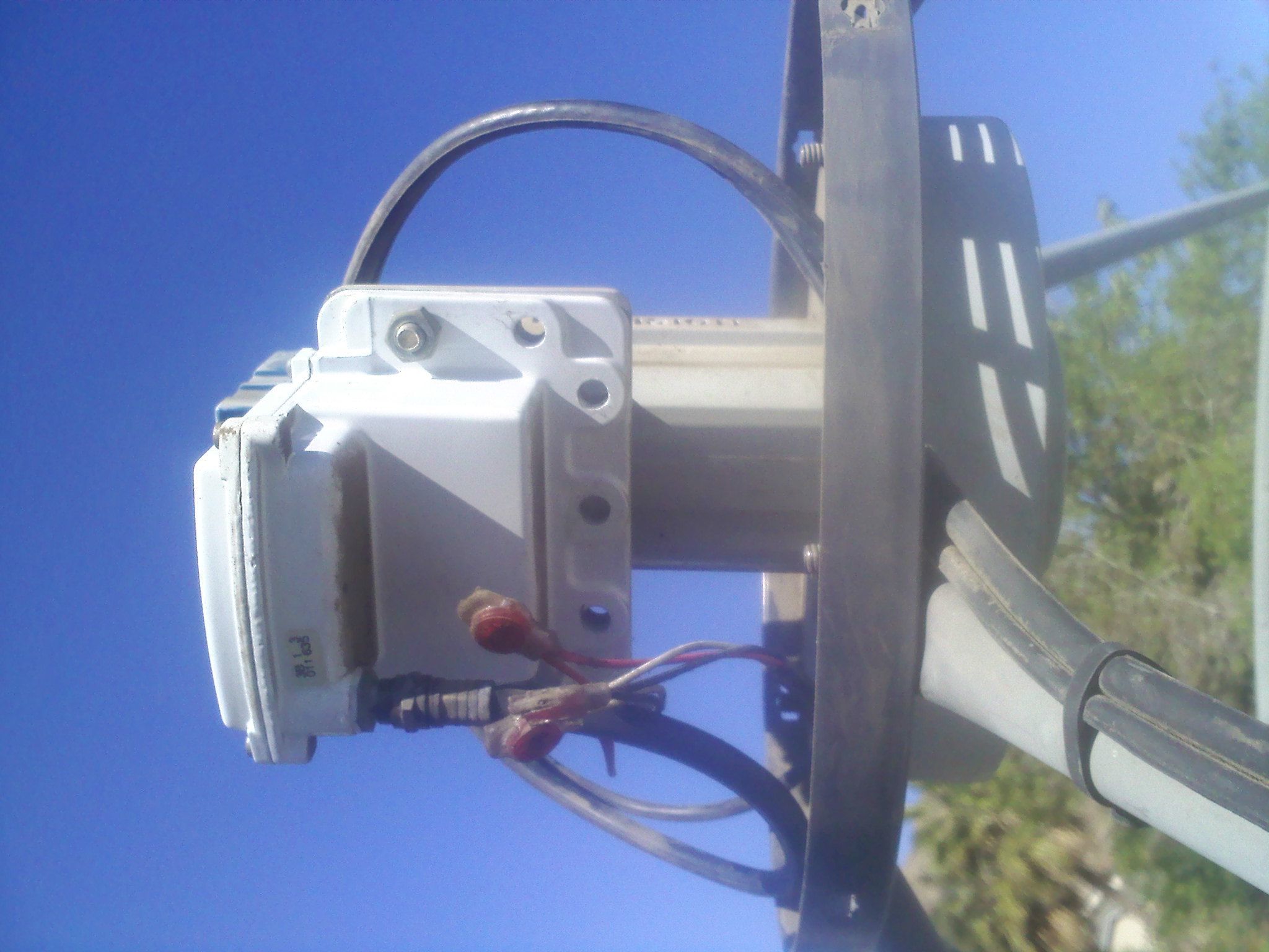

Hi gabshere, thank's for the welcome :) and the advice, I tried what you recommended it really worked, I was able to point to some satellites and voila!! I got some signals being that my analog tuner(I think HCC990) only gets a few signals and most of the time is just a noise signal on the screen, this is like shooting to the air or fishing, you never know what you gonna get:D, I like it although I would need more time to do all the scanning, Is there any receiver that you recommend for faster scanning? here I'm adding some pictures it might give you an Idea of what I'm working with. Thank's a lot

Thank you for the quick response; In fact the equipment is operating great!! I believe it just takes more than I can imagine to operate, so far I have invested some time reading threads, and some websites that provide technical info. I was able to find AMC6 Nasa channels with perfect broadcast, some spanish programming wich I believe is Satmex6, my next step will be find all the satellites manually, it appears as if the receiver I have doesn't have any option to find satellites. I uploded some pictures maybe you know something about the equipment I have and give me some help:eek:
thank you again!!
well it sounds like your in business :)
you can use the home cable concepts to move the big dish and use the satworks to display the digital channels.
now there is a drawback to that the analog receiver will control the polarity and move the big dish. do you have a remote to the home cable concepts receiver (HCC)? the HCC receiver is just a rebranded General Instruments 350i ( there are others i think crosses to a GI 450i)
so with the remote you can program your HCC receiver with satellite locations and change the polarity. then with the satworks ( and i'm not very familar with the satworks , don't know if you can use a channel editor with it or not. if you can that would be the easiest and add all the c-band satellites and channels from the list) from what i can see it looks to be a c-band only feedhorn.
