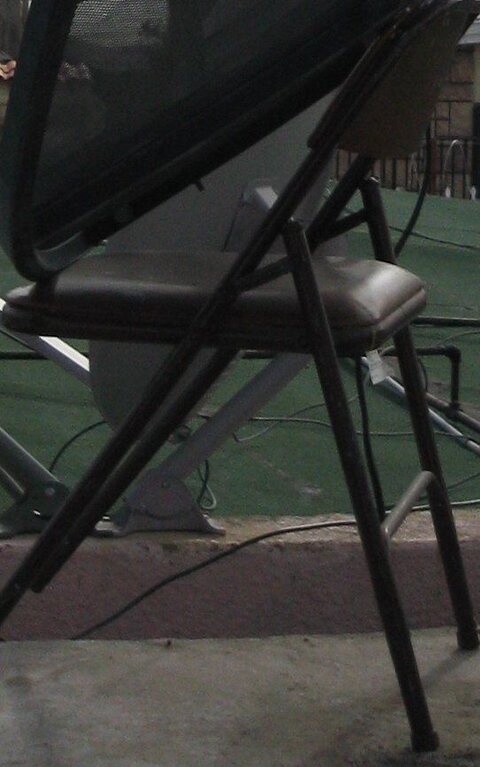

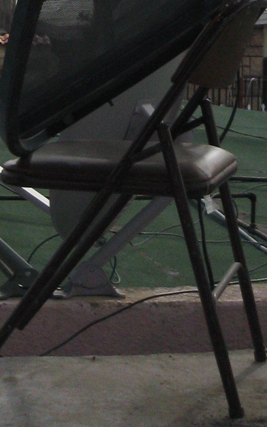

My motor broke and I have order an actuator arm from Sadoun, but until it gets here im getting some atlantic satellites manually, Im using a chair for dish support , but its not sturdy for high winds
what does anyone recommend I use.

nope its broken and it cannot reach to the atlantic sats im watching right now
Flat piece of steel with holes drilled in the right places would work. Holes, or long slots in it would be even better, that way you can just tighten down bolts when you hit the right sat. I have one I'm doing that with now but it only goes to 91W. , lol (short piece of metal was all I had)
Hi, I would think that if you can use the chair to support the dish then you should be able to mark the spots to drill holes in a 2x4 and mount it with large (same dia as the motor used) lag bolts. That should make a quick and sturdy temp support for your dish. Later, DC
