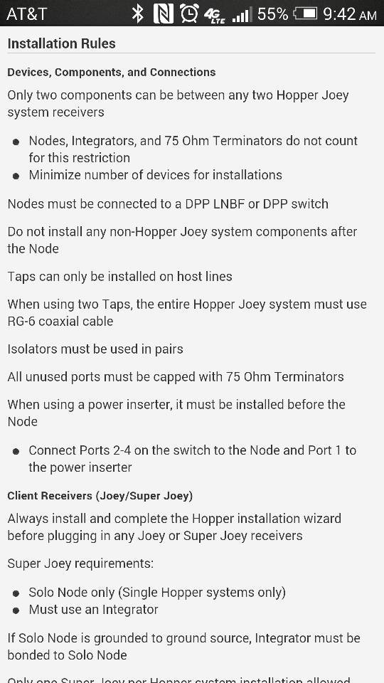

Using 2 taps and a splitter is 3 components between receivers. Either use 1 tap and one splitter or 2 taps and no splitters. Here's a screen shot of the installation rules.
If someone says "I've used more than 2 components and it worked" count yourself lucky.
