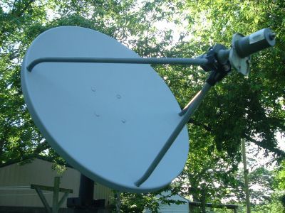

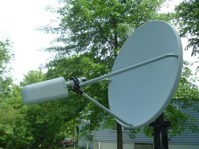

Thought I would add this for anyone trying to use the Channel Master for FTA.
Simple Green and a soft brush works real good for cleaning up the dish.
The Hughes LNB works great. It bolts up fine and it seems to be very sensitive.
The Elevation scale on the 3040647 was off 4 degrees (high). I really like the elevation screw on top. Makes elevation easy to adjust.
To my suprise signal strengths are almost identical to my Winegard 2076.
The dishes are about the same size though. I used the Mercury II on both dishes.

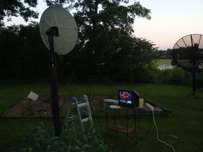

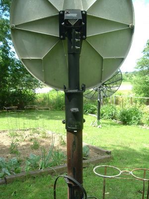

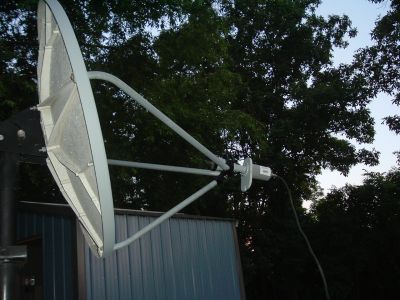

I am adding pictures for anyone interested.

. . . and I'm always a sucker for a nice picture of one of the molded commercial dishes!
Damned nice post ya got 'em on, too!
Thanks to ACradio for supplying the LNB!
You're a gentleman and a rascal! - :up
Glad you got it all up and running! The Channel Master dishes are great. Nice of ACRadio to send the Hughes!
If you had used the Dish FSS LNB from a Superdish, you would have needed to do the math for a stacked LNB (or use a blind scan receiver). If you ever want to connect multiple receivers, I would suggest that LNB, since you can split the output and have both horizontal and vertical transponders on all connected receivers.
