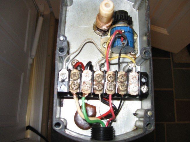

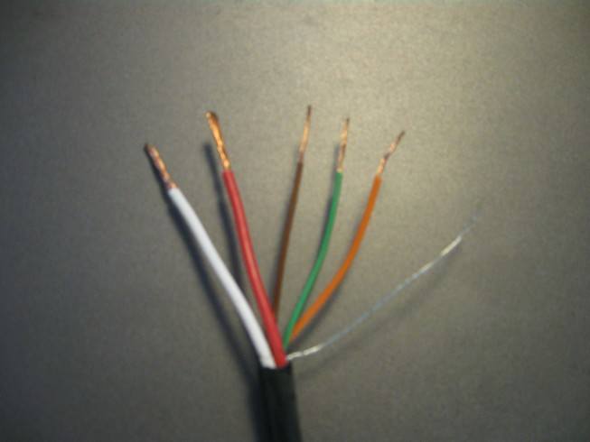

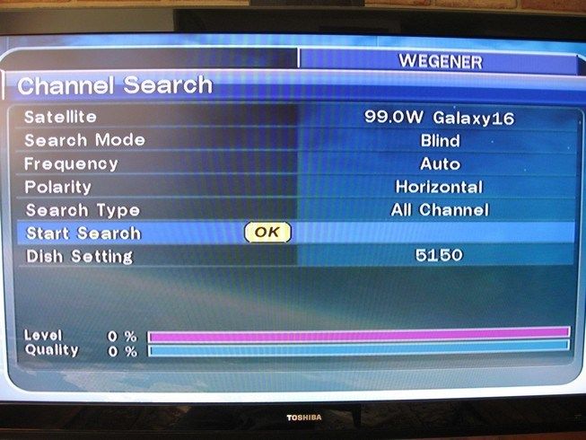

Ok everybody, I've got the bud temporarily up now, but unfortunately the actuator isn't working (no big surprise there). Without it my GI 550i just keeps telling me I need to set east/west limits whenever I try to get into the setup menu. Now I know I can manually move the dish if I remove the actuator motor (I already did), but it doesn't seem to be much of a help if I can't do anything with the GI 550i. Earlier today I remembered that I had another actuator in a shed. It's a Prosat 118.
So, would I be able to hook up the Prosat to the GI 550i or is it too old? I cracked open the Prosat and the wiring is different than what I've got in my cable.
I've attached a pic of the wiring on the Prosat and my cable wiring.
Thanks again everyone for the continued help with this. :up

From what I can see in Pic #1, the Motor Wires are the White & Green and the Pulse wires are Red & Black.
Is that an extra Actuator? Is that why the wires do not match Pic #2?
That kinda' what I was thinking based on the wire gauge. So you think it would work alright (assuming it is functional)?
Yup, I remembered there was another out in a shed and dug it out.
I've been braving the elements (it's been raining here for the last three days :rant:) to try and manually get the bud parked on G16. I dialed it in the best I could using my $10 satellite finder and I'm getting good ol' Pastor Arnold Murray coming in pretty clear right now, so I know I'm in the right place. I haven't hooked up to my Coolsat yet to scan for the networks, I need to dry off and eat some dinner first. :) I attached a picture of Sheperd's Chapel.
Thanks bubba108 for telling me to look for it. :up

On your pic of your LNB there are three wires coming out of the blue box- black, red & white. On the back of your GI 550i hook the red wire to the +5, white to pulse and black to ground. Then you can set the polarity anywhere you want. On the menu of the GI 550i hit 4- Sat Adjustment then 5 Skew and you can adjust the polarity. If you want the Island networks you only need flat horizontal for now.
I would use an Armstrong motor (by hand) to move the dish to get G-19. Then get as fancy as ya like!

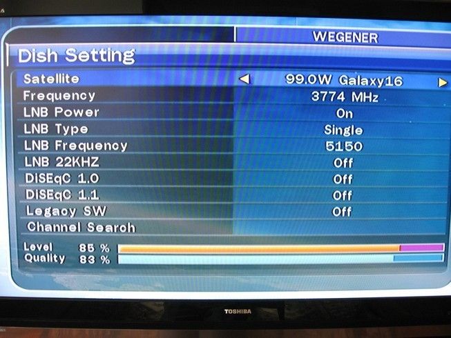

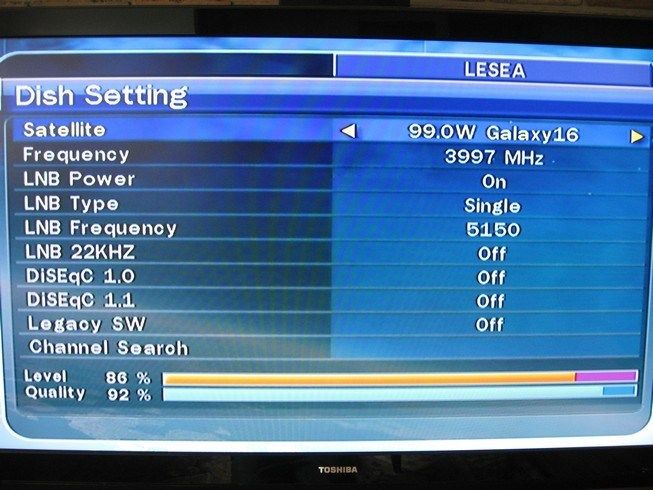

I decided to not try and get the other actuator hooked up right now and instead focused on zeroing in on G16.
I switched the polarity over to horizontal on my 550i and then I disconnected the cable from the 550i and ran it inside to my Coolsat 7000 and hooked it up directly (no switches) into the lnb in. I posted some pictures of my settings and results. When I did a blind scan I came up with 10 channels. I get KCWY, Living Faith TV, LESEA, What I'm guessing is WAPA, TSMA. 3 Mexico. I also scan in G16/19 SD, G16/19 HD and E.E.CEA 2. Those last three lockup my Coolsat :rant:so I'm guessing (also based on the HD clue) that these are some sort of HD channels my receiver can't handle.
So, the big question is why aren't I getting the island networks? I seem to be getting decent quality so I hoped it would pop in on the blind scan. I deleted all channels for G16 on my Coolsat (from my Ku setup) before I blind scanned, but I still only come up with these 10 channels.
Any ideas on what I'm doing wrong? Could there be an issue with dish alignment or perhap the lnb isn't set right? I was thinking I should probably get a newer voltage switched lnb like Iceberg suggested.
I'm getting closer, but for some reason those networks seem elusive. You should all probably be praying I don't get the island networks, since the last time I managed to get an ABC station it was KTWO...and it went dark the next day. I must be cursed. :eek: :)

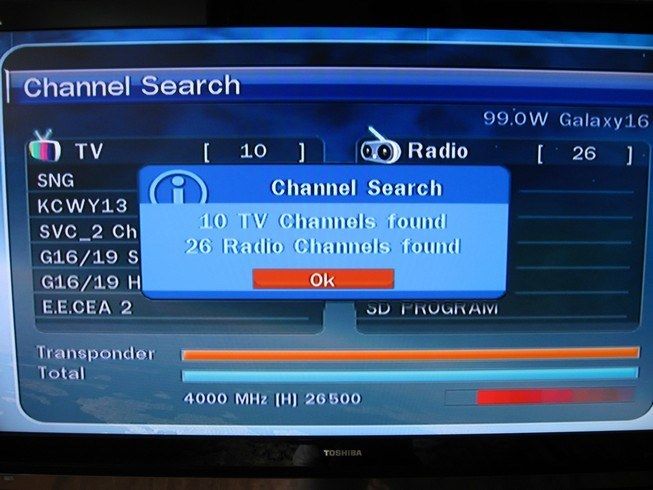

I would manually add the transponder and scan. Sometimes the blind scan misses it
3845
H
15030
They will log as "SVC 1" through "SVC 7" or something like that
3845
H
15030
I was just about to edit my previous post. I tried another blind scan about an hour 1/2 ago and they all appeared. @party I'm getting 91 - 94% quality.
Strange nothing from that transponder showed up before :confused: but it makes more sense now that you tell me that blind scan can miss things. Yeah, they showed up just like you said SVC 1 - SVC 7. The blank screen on ABC HD makes me really think I need to join the Azbox club! :D
