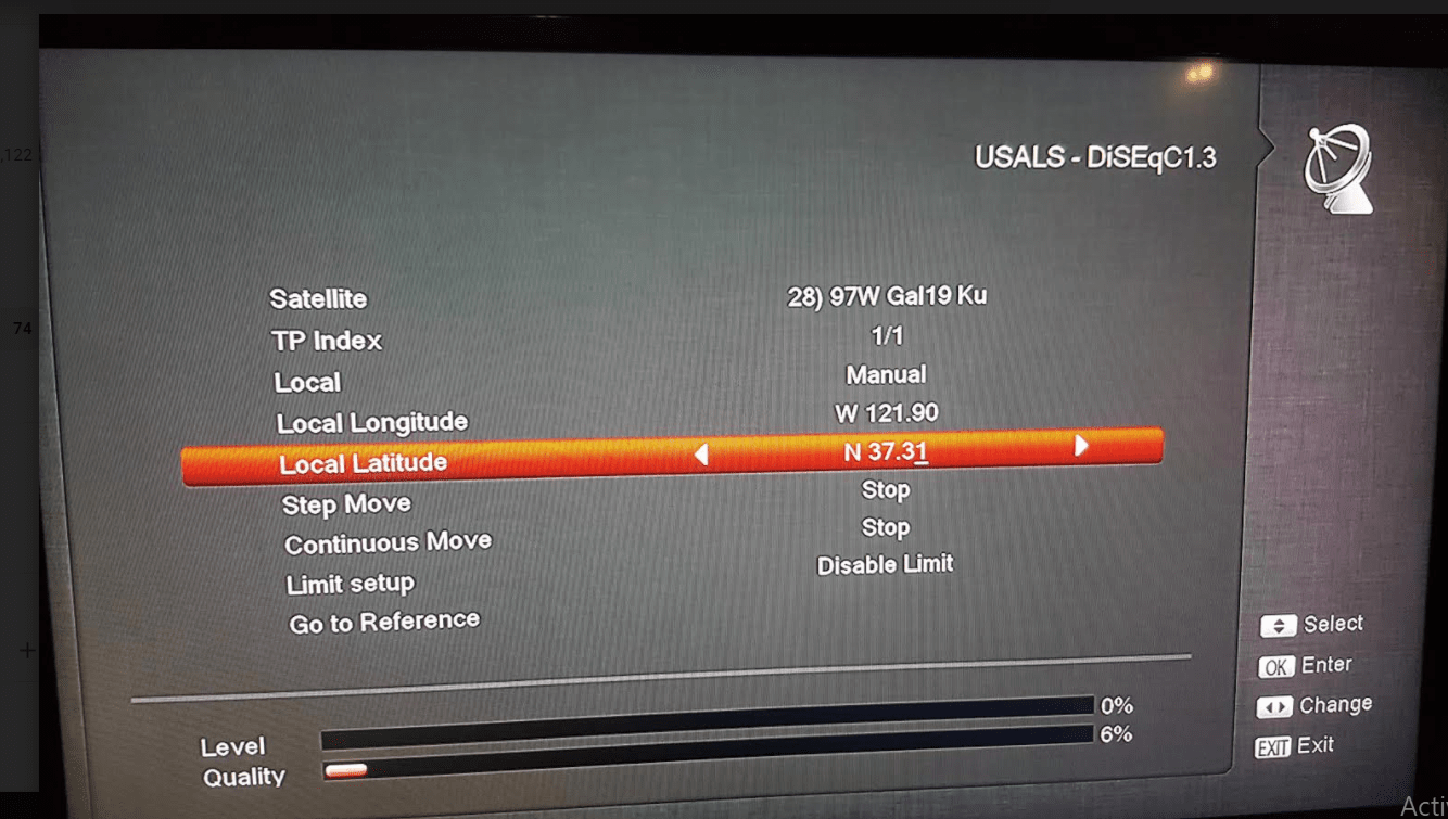

I;m having a problem filling the part of Local Longitude under USALS, See picture below.
My location is Negative number, Longitude ( -121.90)
The system doesn't allow Negative Numbers
someone here posted before that I should substract 360 - 121.90
that would be = 238.1
when I enter 238.1 in USALS it gives me a message that says INVALID DATA
Right now I have it as a Positive number but I don't feel comfortable that this is correct, Please HELP
What is the correct number that goes here in Local Longitude under USALS?

That picture you posted shows your Longitude as W (west) so you don't need to convert anything as your box supports E/W designation. You have it set correctly, no need to change it. :)

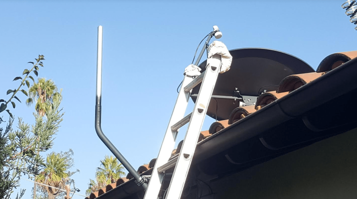

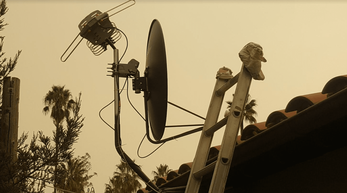

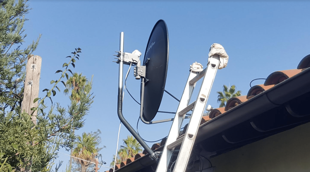

here is my Satellite Dish installed.
I had to welded a pipe extension because it was hitting the roof, now its ok
I put my local antenna on the top to use that space, it works like a champ.
and also you can in this picture how much smog we have here in San Jose,CA. due to fires around.

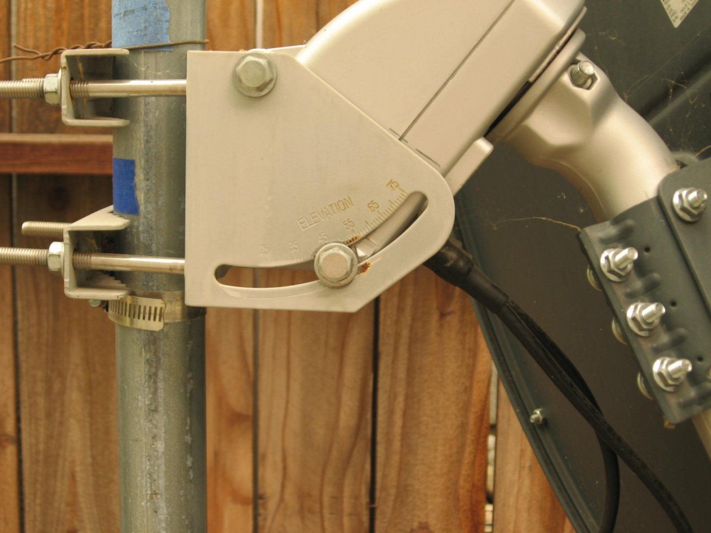

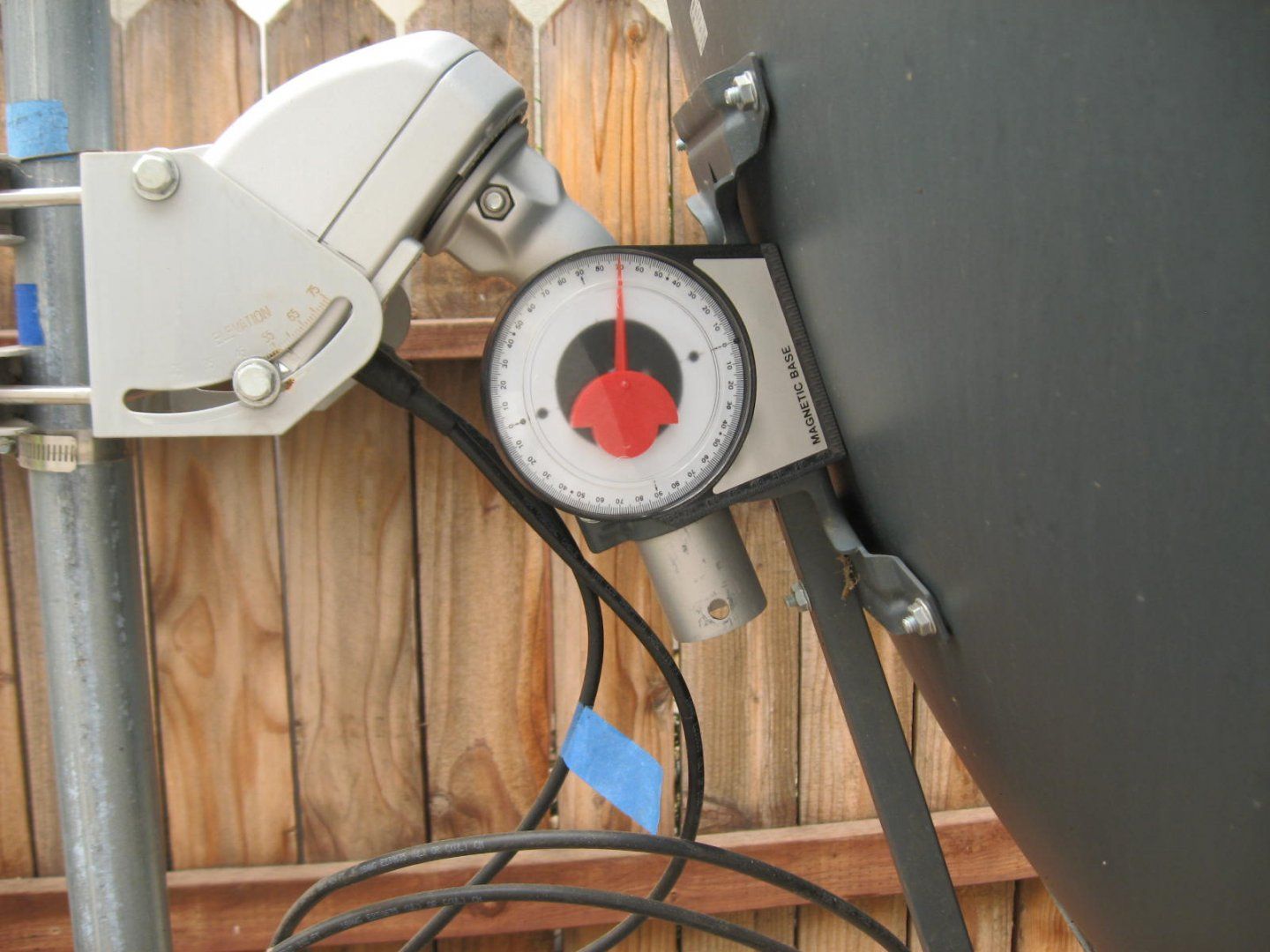

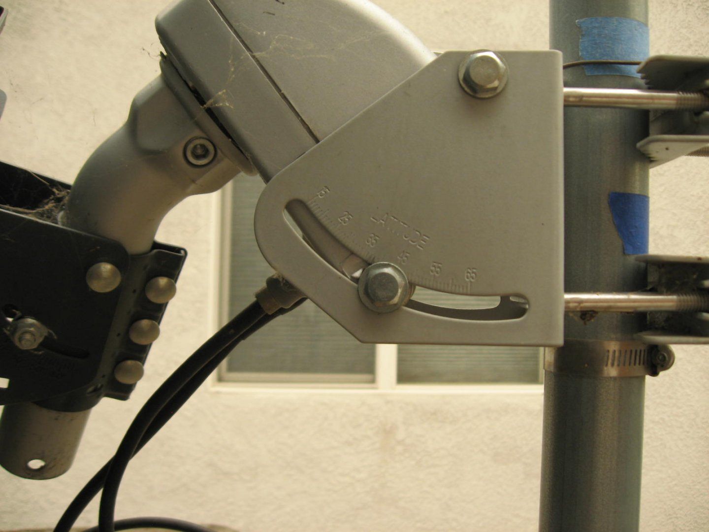

Freddy here are two pictures of my Dish and motor. I live 60 miles east of you. This should get you very close. I have a 36" Geosat dish and a SG2100 motor(not a Stab).
you might try the trick in the first photo of putting a hose clamp on the pole to allow easier adjustment side to side wont slide down the pole on you when loose)
Good luck

Sorry Freddy I took the picture of the elevation side. Latitude is on the other side of the motor. YES 37 is correct. The indicator on that side reads 37.

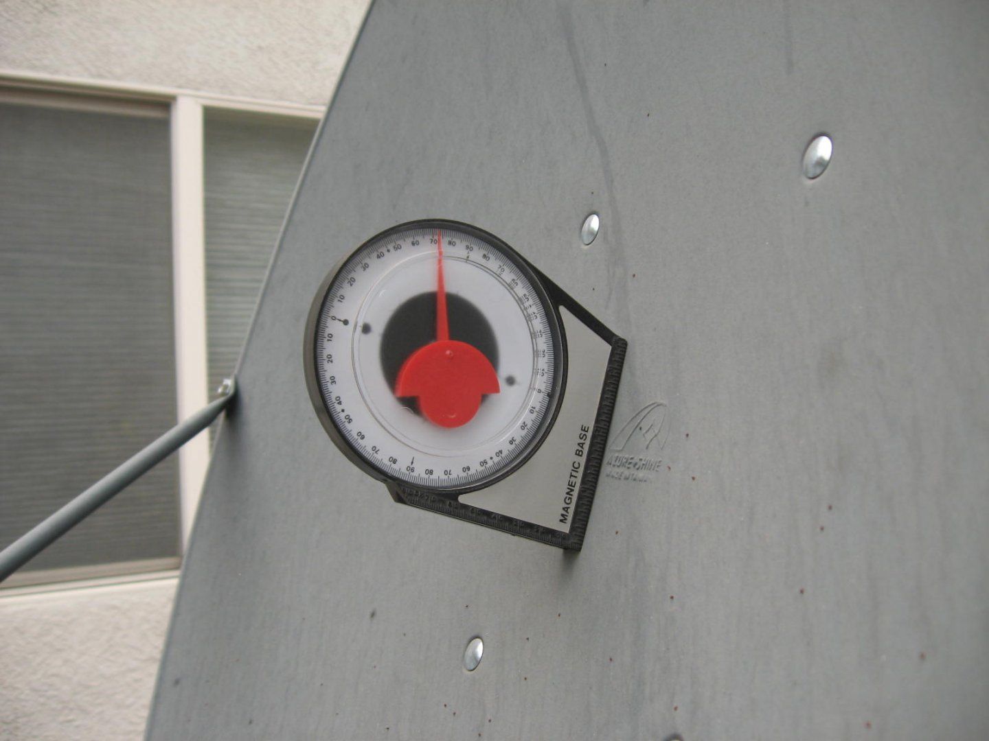

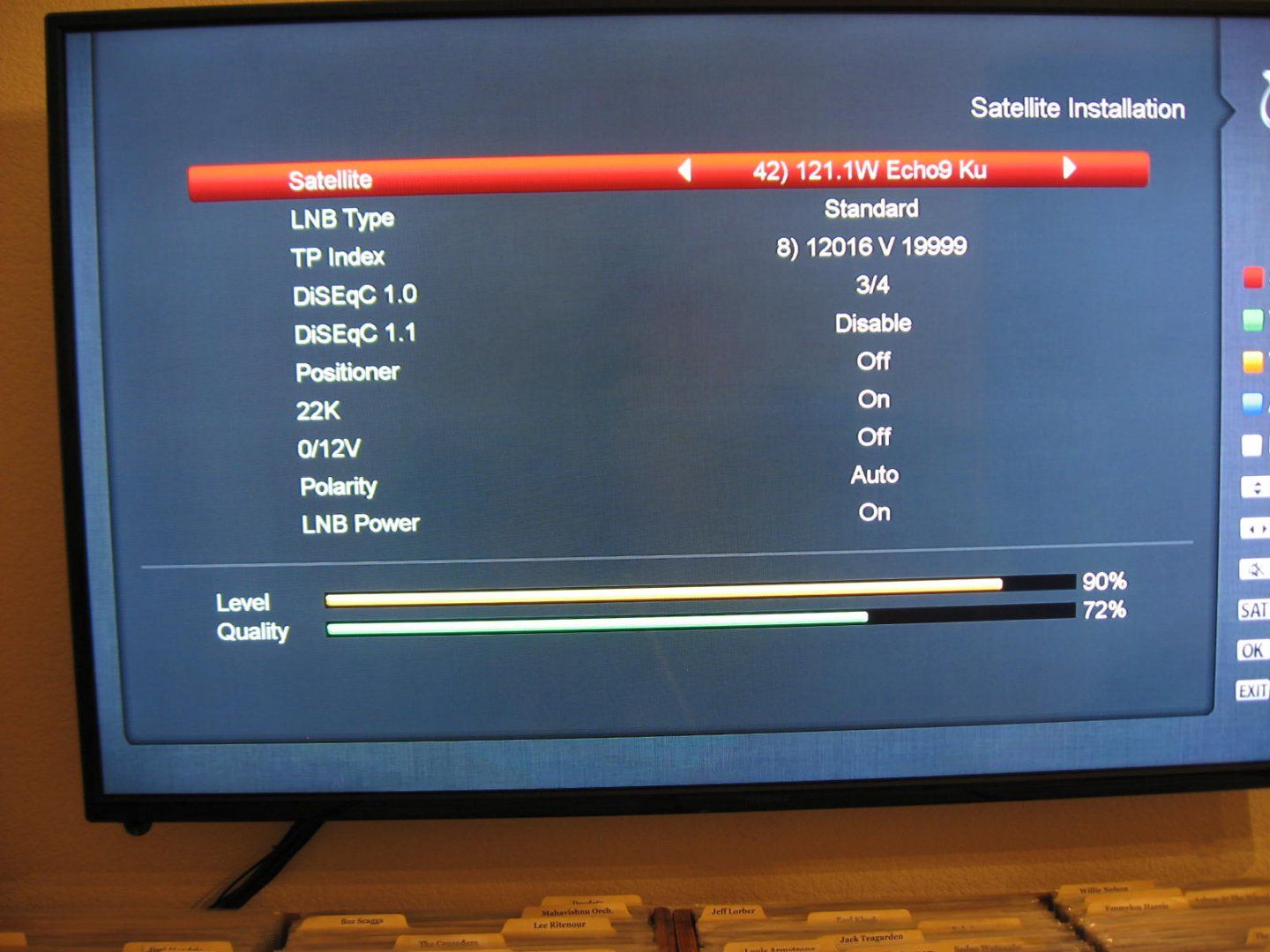

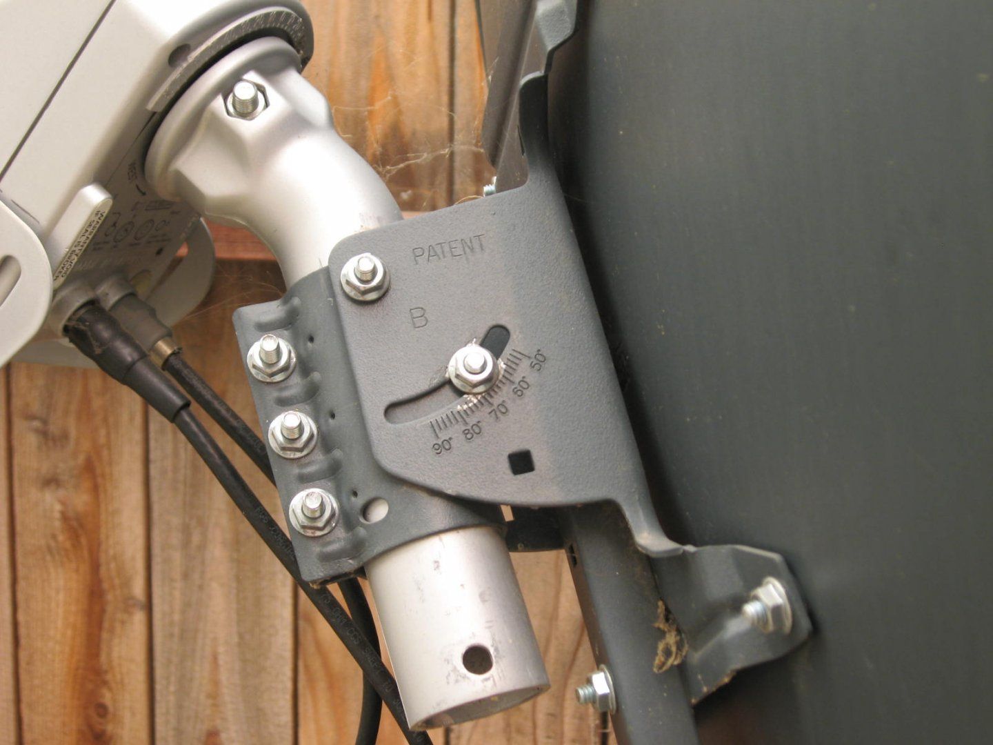

Freddy, I can't read the line on the dish. This is where you are going to fine tune anyway. Here are a couple more pics. If you have a magnetic angle(slope) thingy like in the pic set your dish at 70 degrees to start. I moved the dish to the satellite at 121 for the pic(your true south sat.) Take a tv and your receiver to your dish. Put your motor on "0". Set your lnbf for no skew"0"
Set your motors latitude to 37. Lightly tighten the dish close to where mine is. Go to menu>installation>then set you receiver to match my Amiko's pic. (I don't have the positioner on in mine) set your TP to the same numbers. The Diseqc does not have to be on for you. This is a DISH test channel. It will be a very strong signal. Now SLOWLY turn the motor on the pole till you see Level and Quality as close to mine as you can. Then tighten down the motor. Watch the signal levels as you tighten. The motor may shift as you tighten. Now you can move the dish up and down to fine tune. When you have got your best quality you can now blind scan free only channels.
Then you can move on to setting the numbers in for your positioner(motor). After that USALS will move your dish to the satelite you select in your receiver. Try 87w SES2 ( LPB PBS channels there and about the farthest east you will go satellite wise) Then try 125 AMC21 .
