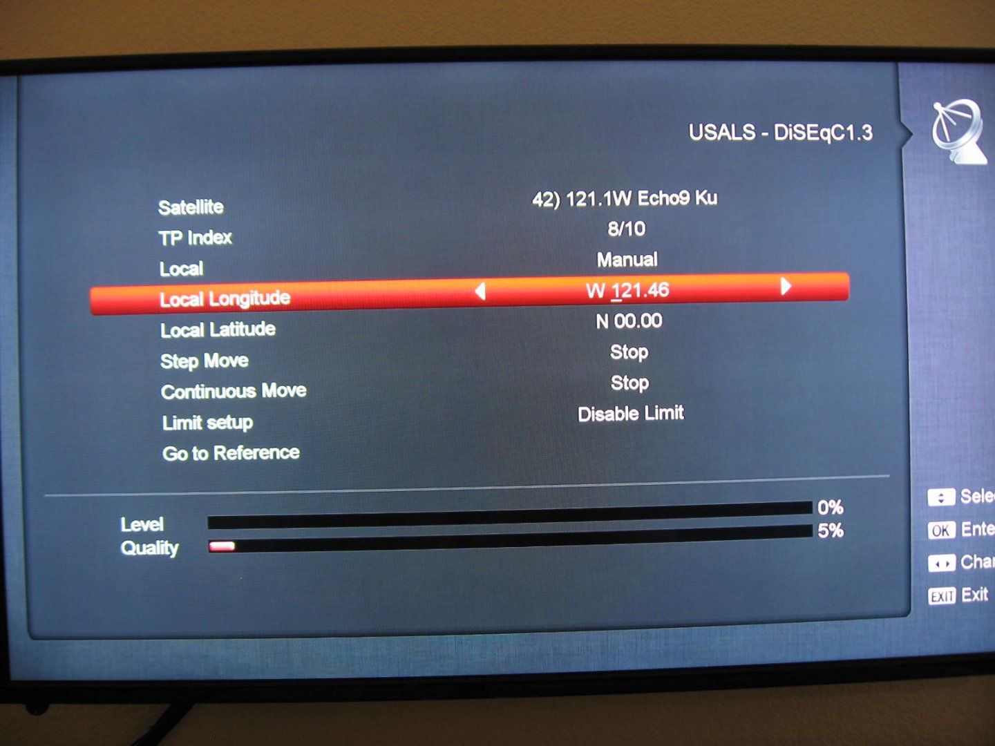

Freddy , click menu>installation>satellite installation>down button till you highlight Positioner and click till you see USALS>hit center button and this screen appears. Doesn't matter what satellite your on. You will see a underline under the first #. push the #1 on your remote. Then with the left-right button you can move to the numbers you want to change.
BUT no matter what satellite is at the top of the page it will always be the Latitude you originally entered.
USALS only knows to move so many counts from satellite to satellite. So you start by putting the motor at 0 (and leaving it at zero) If you have the dish nearly at the setting I provided all you have to do is slowly move the motor on the pole to dead south till you see on the signal level that you found the satellite. Fine tune left and right till you have the best signal. Now before loosening the adjusting bolts lightly pull back on the bottom of the dish if the signal improves adjust the dish down. If it gets worse adjust up. Now do a blind scan to confirm you are on 121. Now that you are on 121 tighten bolts on the pole and on the dish. I hope you put a through bolt locking the dish to the arm.
Now USALS can work because it knows where it is. "0" and 121.88
If you select a satellite and you get a so-so Quality signal # on that satellite you have more adjusting to do. Read how to determine which way to go. Since 121 has such a strong signal you can be off good amount. If you had a weaker signal to adjust to you could fine tune it a bit easier.
Now if you still can't find 121 or the motor moves to a satellite like 97 and you get no signals you may need to remove the motor and start at the beginning like most of us. Put the dish on the pole. Use Dishpointer to get a landmark for your selected satellite. Put a known transponder in the receiver with a tv connected. move up and down and then left and right. When you find that first satellite you will feel great. Then read and read some more about this hobby. Baby steps
Good Luck!
