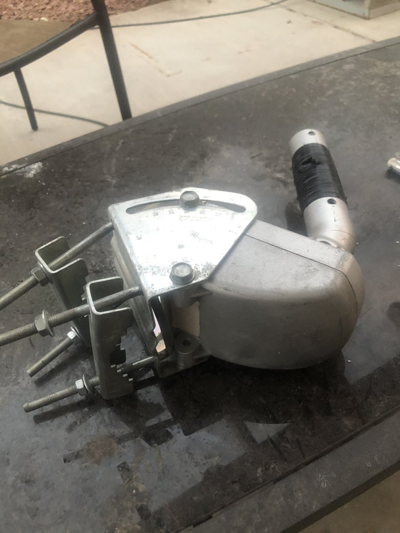

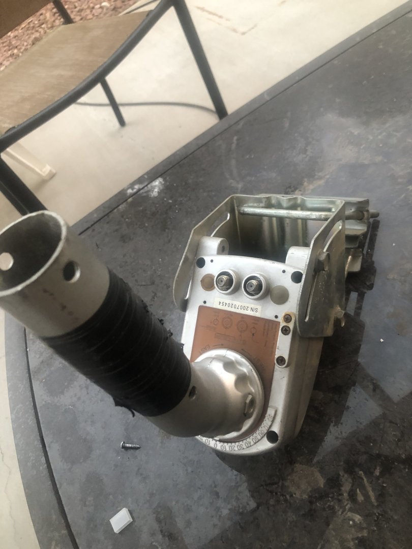

Hello everyone. I have an old, unknown to me, ku rotor that I can't identify the make/model nor get working. I was hoping someone could provide some insight to what I have.
The manual east/west buttons work, but no matter what settings I put into my gtmedia v8x box, it doesn't respond/move. Thanks

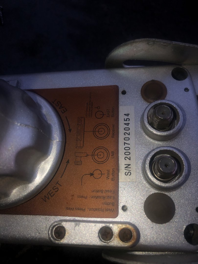

It looks like an SG-2100 or similar. I think I can just see the small hole beside one of those rubber grommets. One grommet hides the manual west-east button. The other one that has the small hole is where you insert a paper clip. With the cable from your receiver connected and the receiver on (power applied to the motor), press the hidden button with the paper clip to reset the motor. Do it a couple of times. You will see the light on the motor flash yellow and then revert back to green. Doing this has brought my motor back to life in the past.
I looked up SG-2100 and I think that's the exact same one that I have. Thanks for helping me identify it!

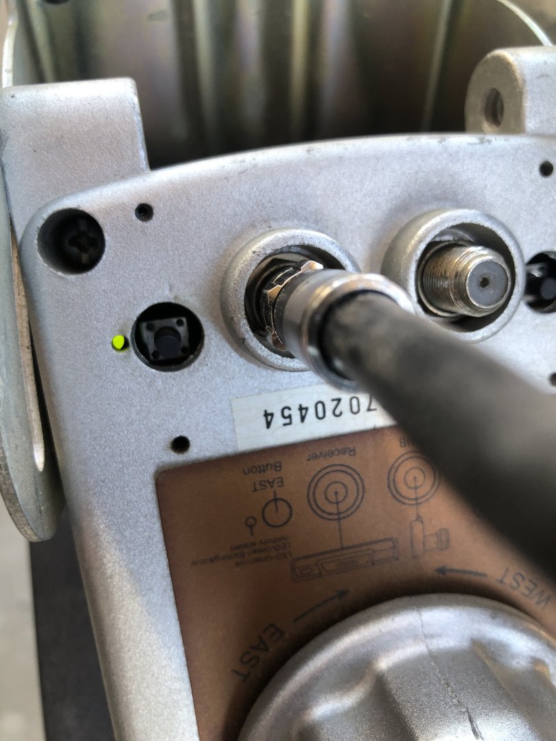

I popped off the rubber grommets and looked for a reset button, but couldn't find one. A green LED lives down in that little reset hole.
Not sure what else to do except maybe take it apart and look for obvious damage to the circuit?
Thank you everyone for your responses
I'm not familiar with that motor, but there really should be a reset button inside? Have you tried, with a small metal pin?

Not to belabour the point, but is it possible that light IS the reset button? I've never removed the grommets so I'm not sure if my light is in that hole. Its illumination may shine sideways so it appears the light is behind the grommet with the grommet in place.
Many motors without manual reset buttons allowed the user to perform a reset at the motor using the East / West buttons.
Drive the motor to the centered "zero" position.
Remove the motor power.
Press and hold both East and West buttons while restoring the power.
Continue holding both buttons for 5 or more seconds until the LED flashes multiple times, indicating that the motor has been reset to factory settings,
Note: some motors require a STB or programmer to issue a "Reset" command. Most STBs do not issue this reset command, but a PCIe or USB DVBS tuner with PC software can issue the reset DiSEqC command.
