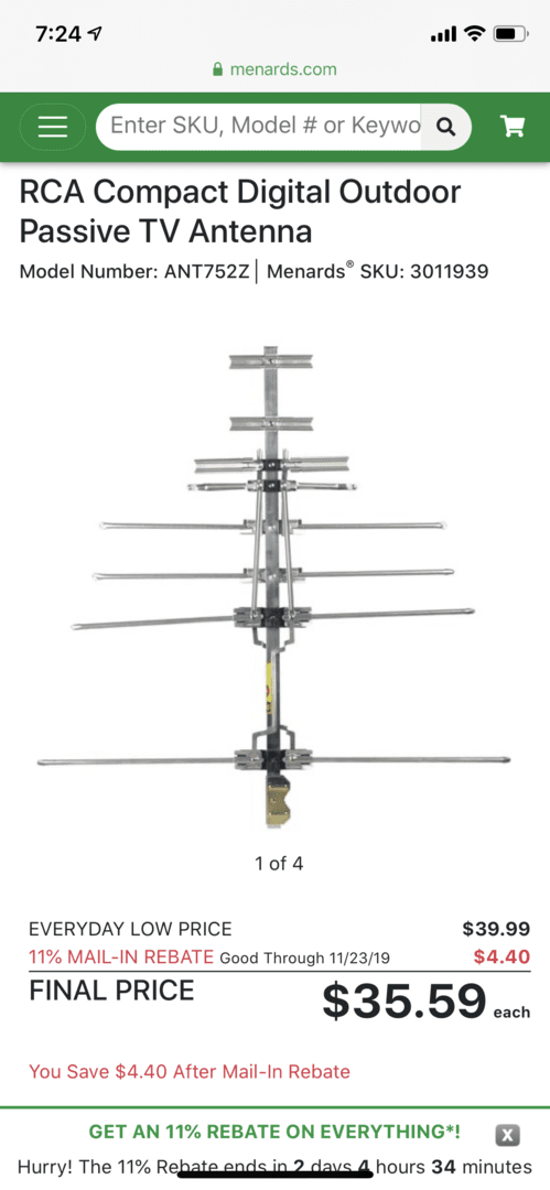

Huh. Well that is good to know. I guess I could fight em but I'm good for now. Oh, and I now realize that I bought a ANT752Z by mistake as that's what Menard's showed me when I searched on the 751. It seems to be working for me so I'll roll with it for now .
I think the 752Z is the successor to the 751. Looks identical to my 751R. Price listed is $14 cheaper than Home Depot.
