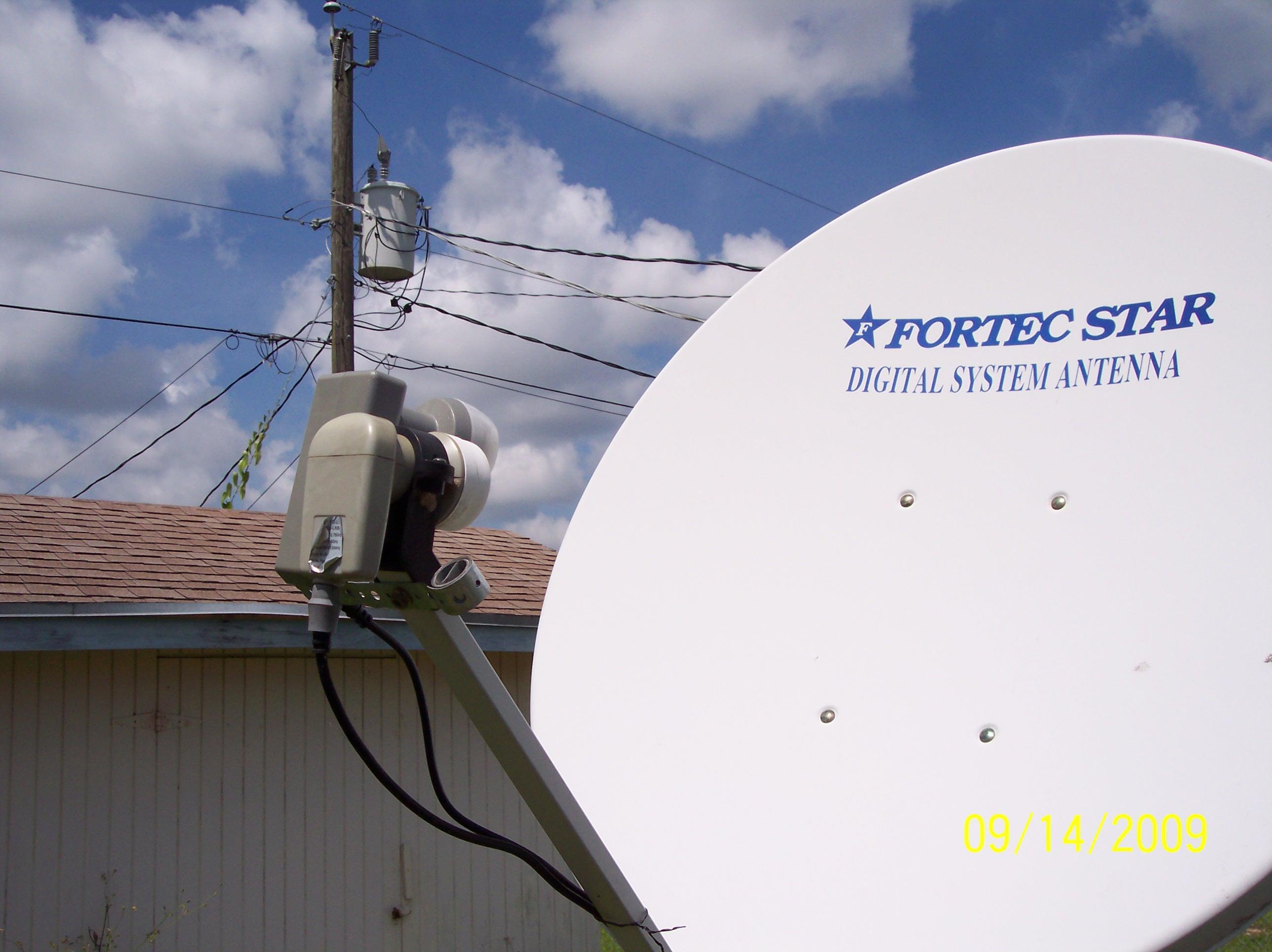

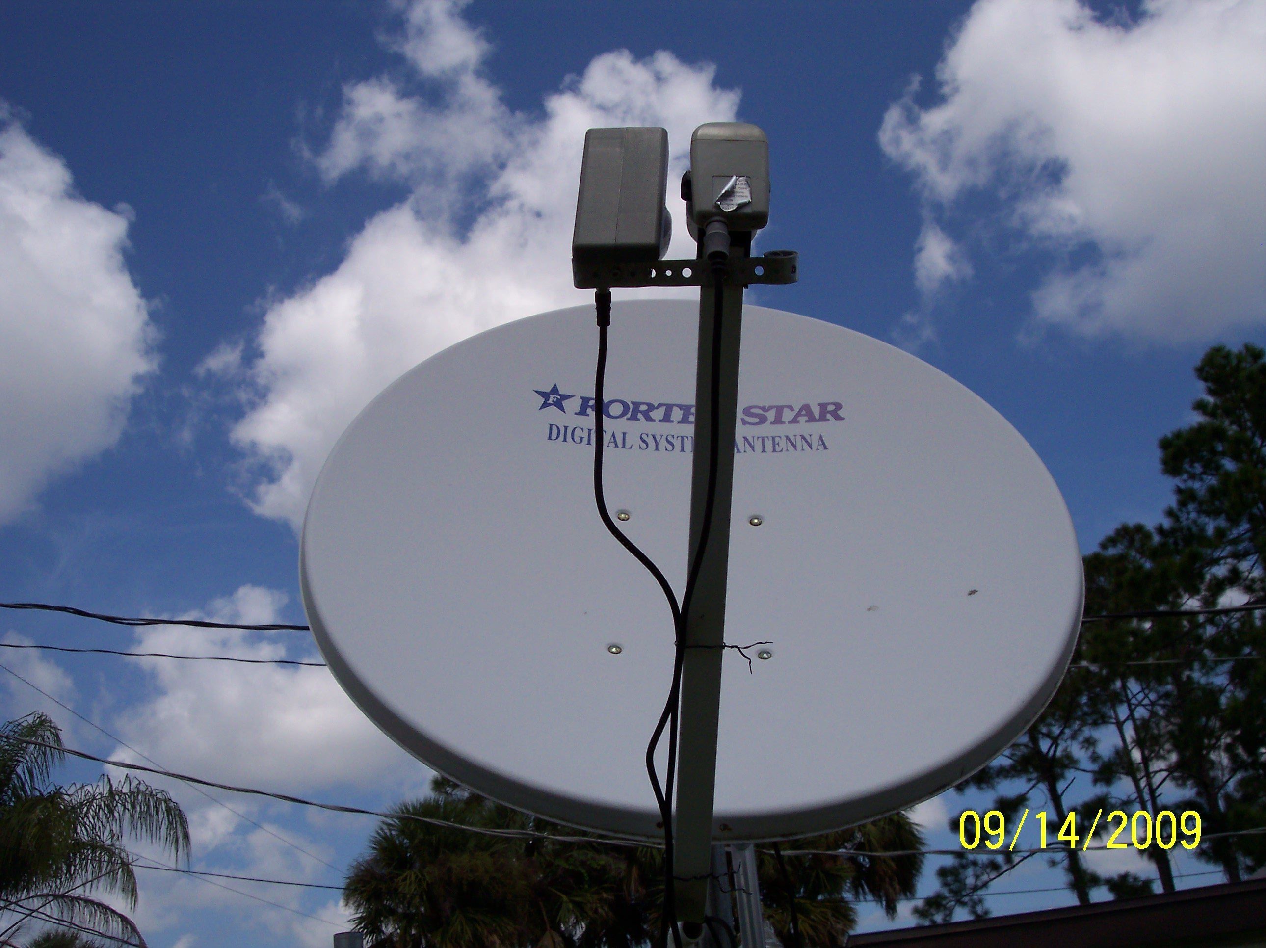

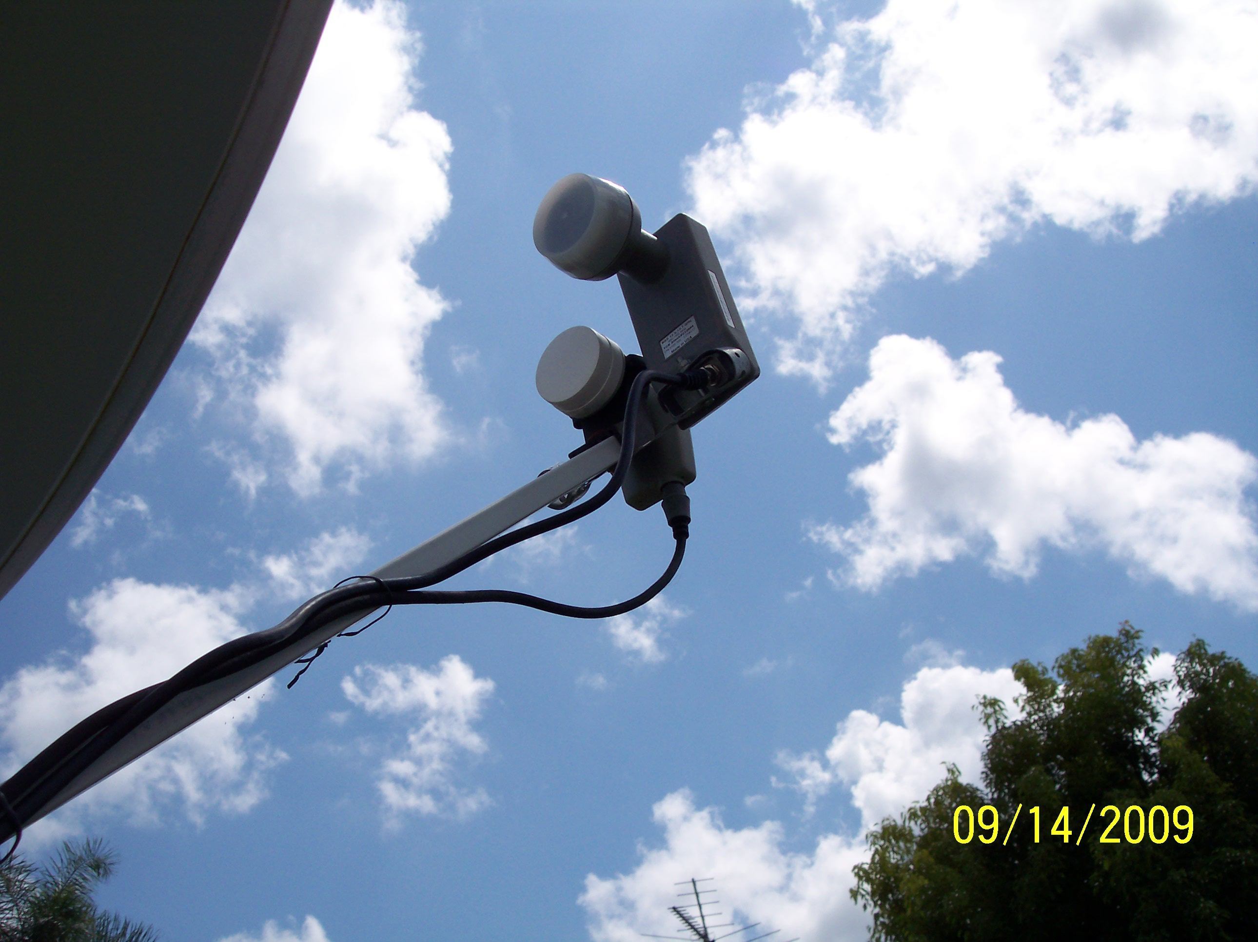

Ok so after about 3 years of enjoying my system I have decided to add a dbs lnbf to my setup. I have a system I have a fortec 36" dish with motor and a fortec lifetime classic things work well. I wanted to get the NASA channel from 119w .
The dds lnbf I found on garbage day attached to a small 18" dish and is a single connection TCE# 232594 so not sure if it even works but just would like the experts to tell me if have something wrong with the set up almost forgot also have a new diseqc switch that seems to work as I change from 1 to 2 my universal lnbf goes on and off.
I am using
lnbf type 11250
power 13/18
22khl auto
diseqc 2
transporter 12370 V (for R) sr 20000
When I move the dish there I get signal on the ku side so I think I am on the right satellite I can scan from 30 to 123W .
Thanks in advance
turn off the 22k on the settings for the DBS LNB...the rest is fine
Did you attach the LNB to the existing motorized setup or added the whole dish? I'm confused on that part. If its added to the motorized (attached next to the KU) then it will be off by 5 degrees and you have to either change USALS or use Diseqc 1.2
My DBS LNB I have to -5 degrees due to being on the one side (if facing the dish its to the right)
Iceberg
I attached it to the motorized system . Forgot to mention is this a problem with the skew on the dish?
Thanks
Here are some pics

OK then where that DBS LNB is you need to add degrees to it. Since the LNB is not right next to the KU I'm thinking maybe 5-6 degrees you have to add. (so to have the DBS at 119 you need to have the dish move to 125)
Also it should be the same level as the KU LNB. The motorized part will take care of the elevation and there is a little room for error with DBS but not that much as you have right now ;)

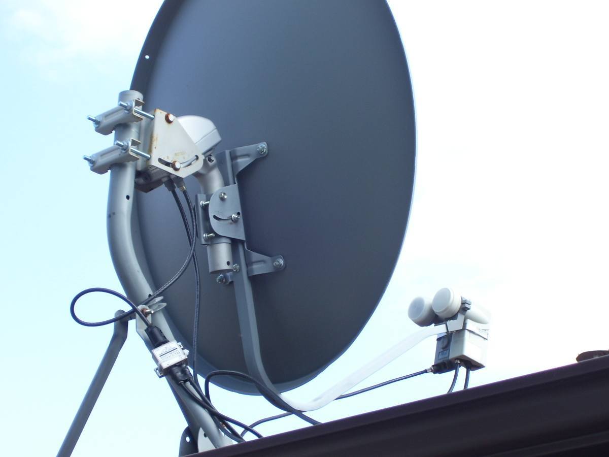

Here is an older pic of mine. Notice the DBS is level with KU

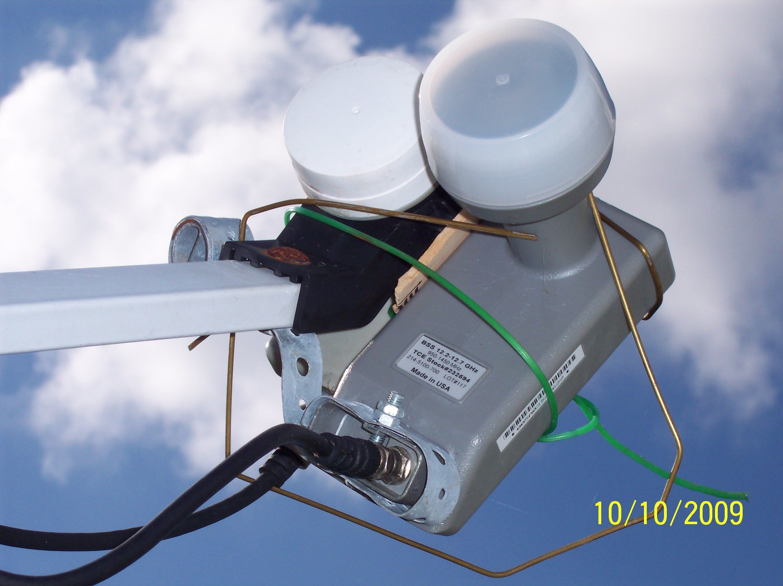

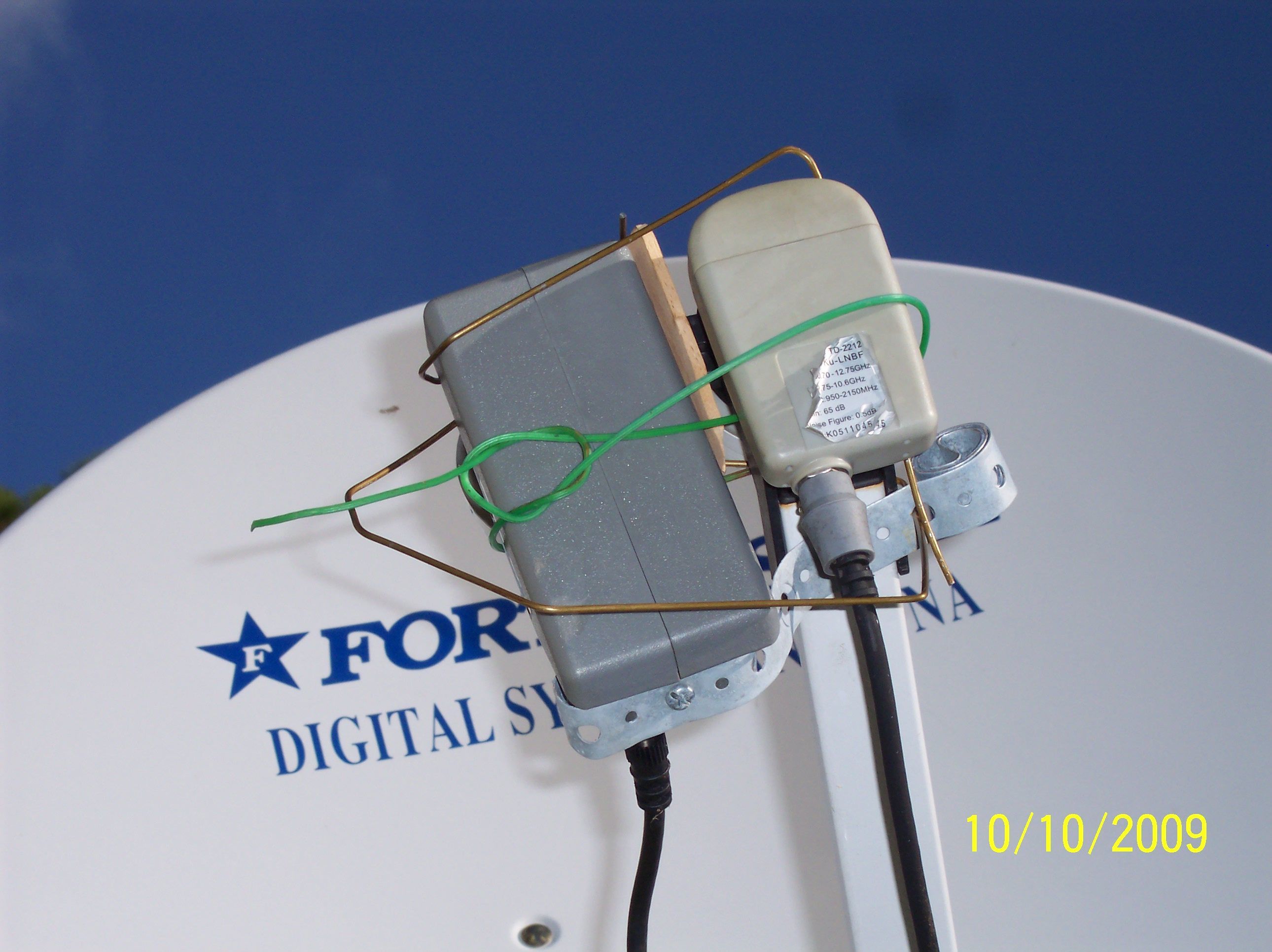

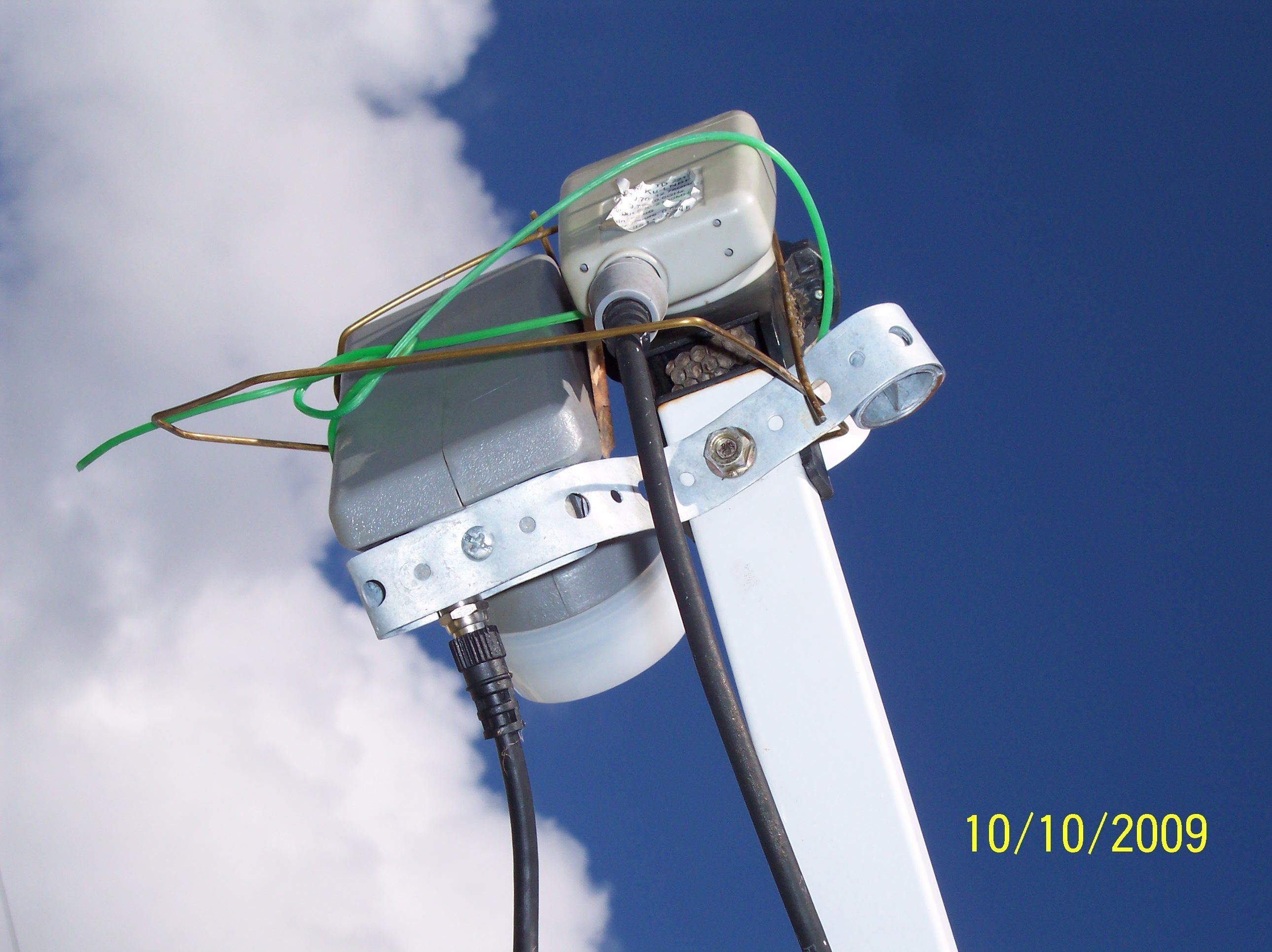

Well I can now get NASA so the dds lnbf I found on garbage day works . I have "improved" the stability and the mounting of the dds lnbf thanks to some wood and coat hanger wire ;) The weed whacker line was the "temporary holding.

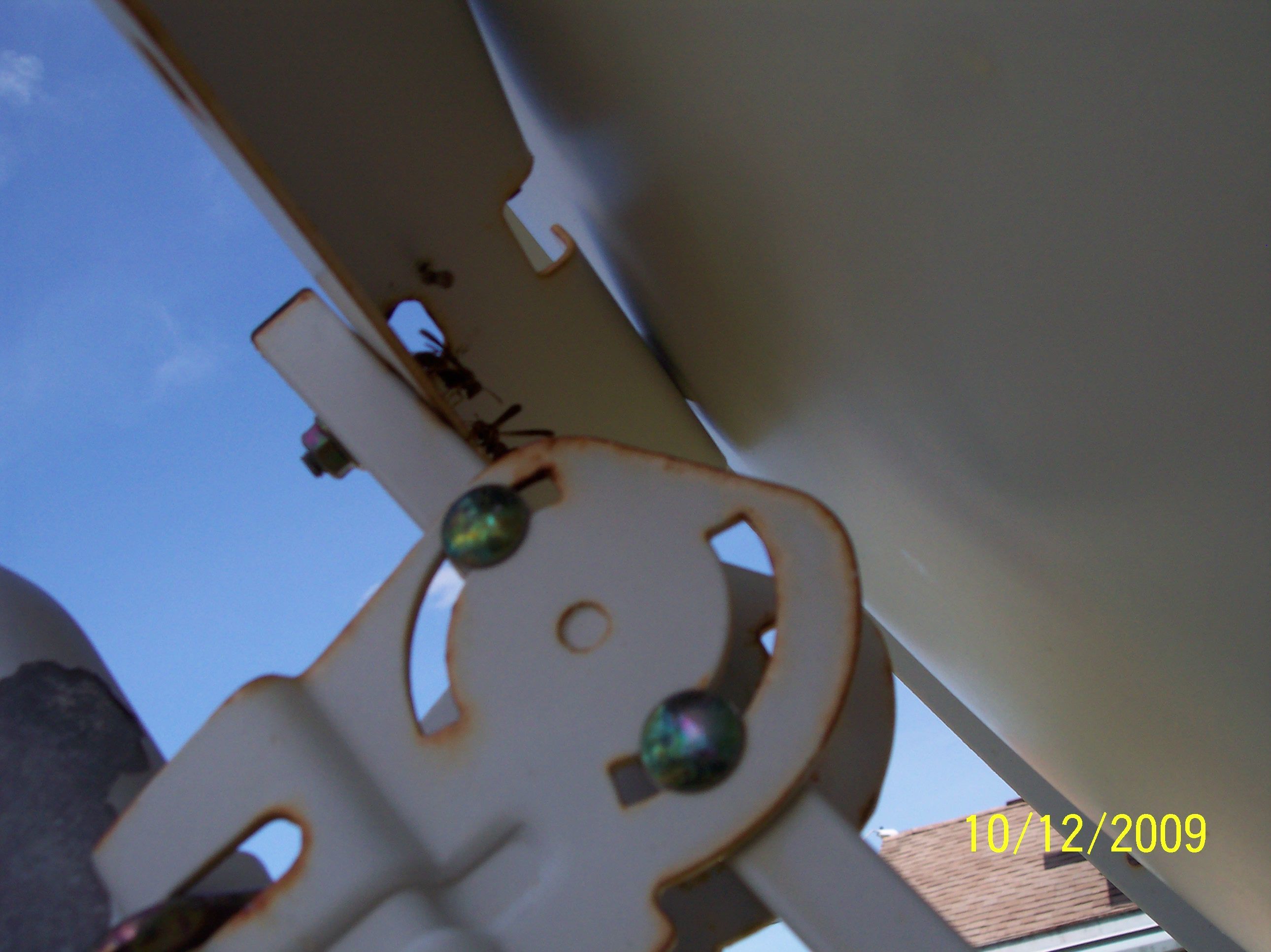

I attached a couple of pics the wasp nest I found almost right away or should I say they found me ouch! :mad:
Anyhow that is why I enjoy this hobby so much to do and play with.

Good work, nice blue sky too. The wasp nest pics didn't make it though, I haven't found many in a dish like that. Yet, lol.

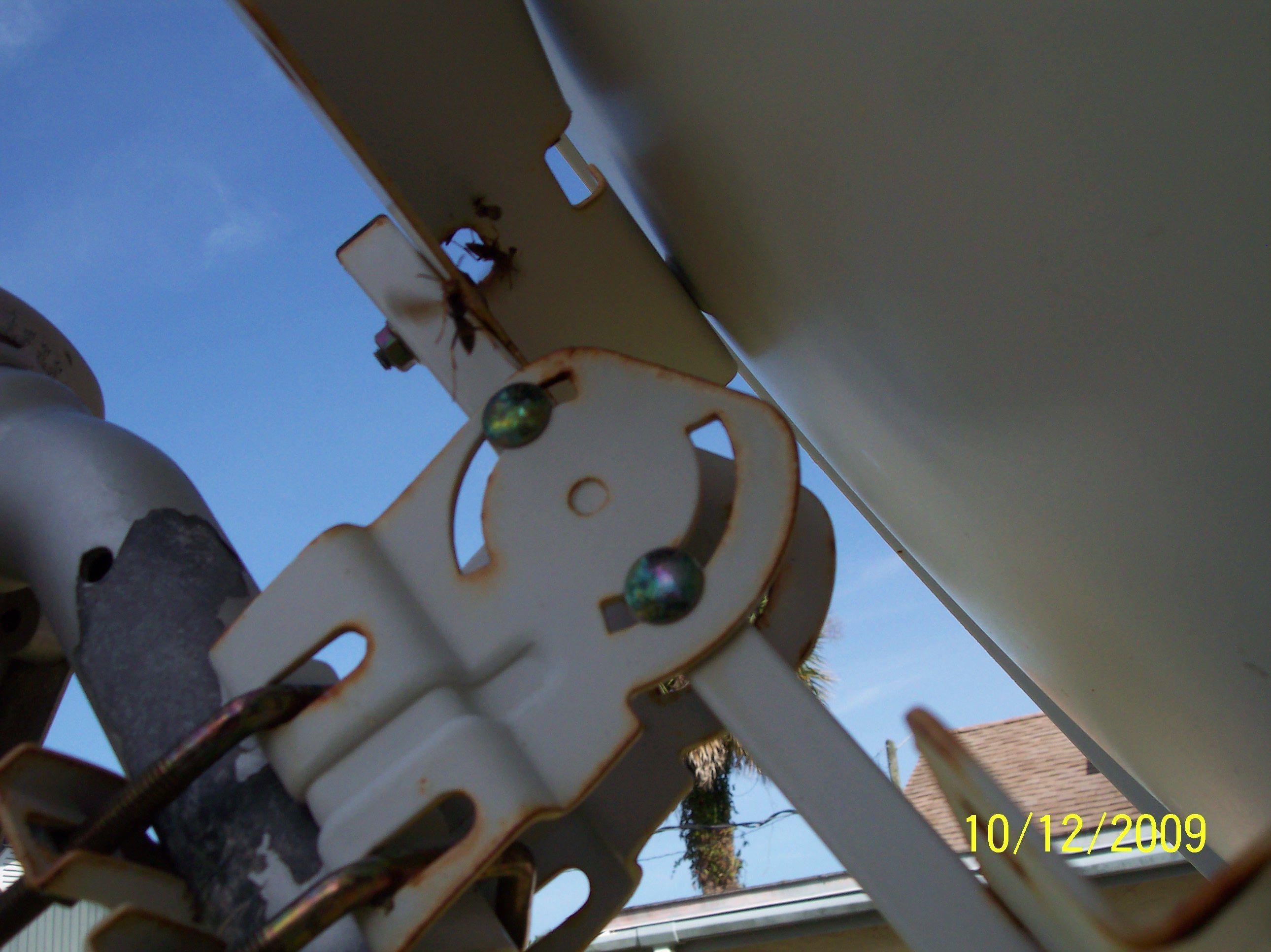

I've got the same dish as you do and I noticed the other day that wasps were inhabiting mine in the exact same place. Fortunately it's cold here right now so they weren't moving very fast. I also had some hiding in the slide down cover on my Invacom lnb. When I slid it up I could see legs sticking out around the coax connection, so I slid it up all the way until I heard a crunch and they stopped moving. I'm wondering if wasp juice will improve reception. ;)
I have to say that even though my cold weather slows the wasps down, I'd rather have palm trees behind my dish like you do. :cool:
Thanks yes is Florida and very hot and dry need rain and a cool down. If you look at the first pic right up under the arm where the universal lnbf holder and above the bolt is you can see the nest they made it square to fit the opening.
Mel, that one is well hidden, they woulda got me too! Those jet-spray cans make short work of the devils though, need to fill that up with syyrofoam or something to keep them out. Ladybugs will fill up every opening in things up here when it starts getting cold weather, thankfully the wasps can't take it.

Yes they are very crafty and also get very very upset, the the dds lnbf I found on garbage day had a cost with it, they got my hand 2 times good thing I guess I am not allergic I have evicted them for their condo at least for now:rolleyes:. I do get a lot of lizards and frogs that hang around the yard and my dish system no problem with them at all ..I do not spray everything with poisons therefore I have a lot of natural predators for the bugs but I guess the wasps are not too tasty.:D
