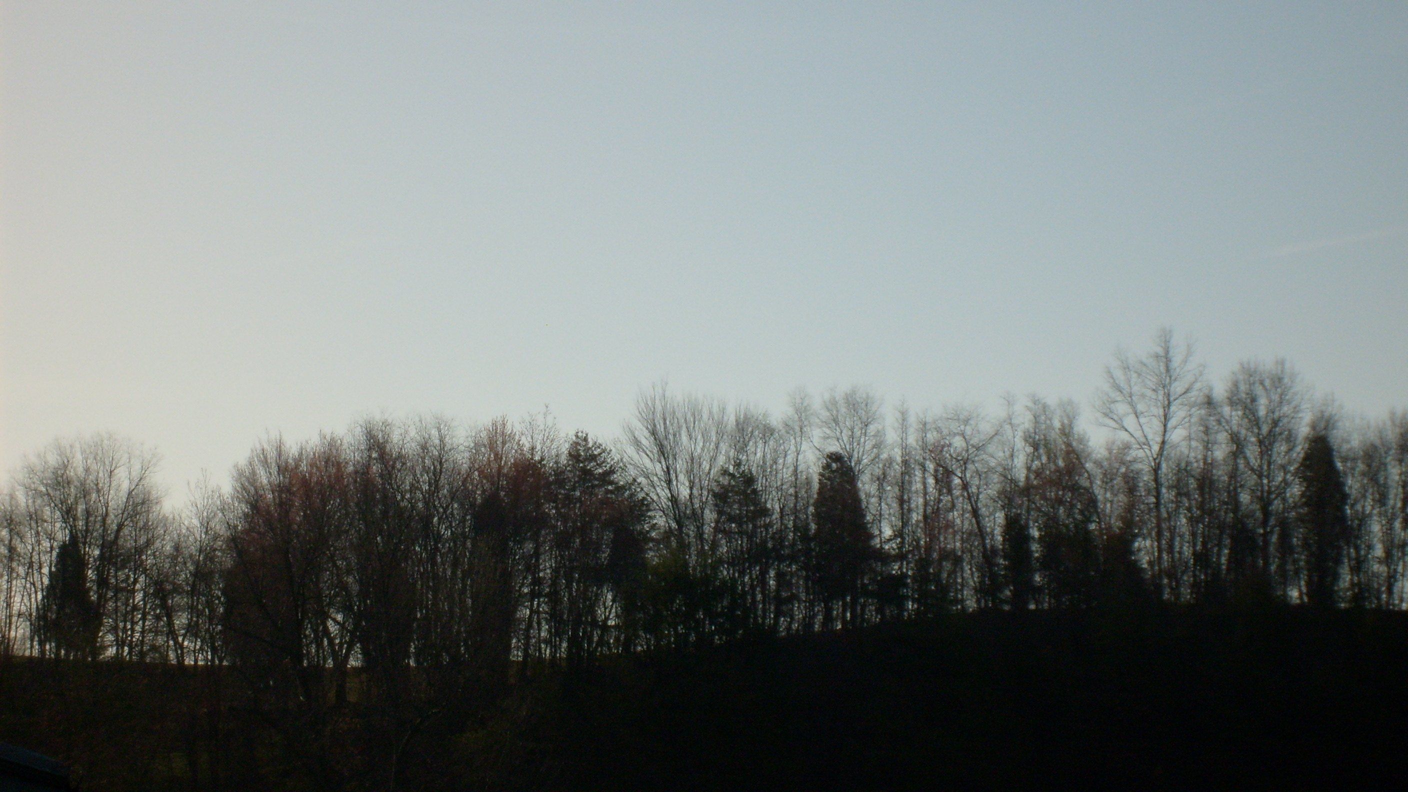

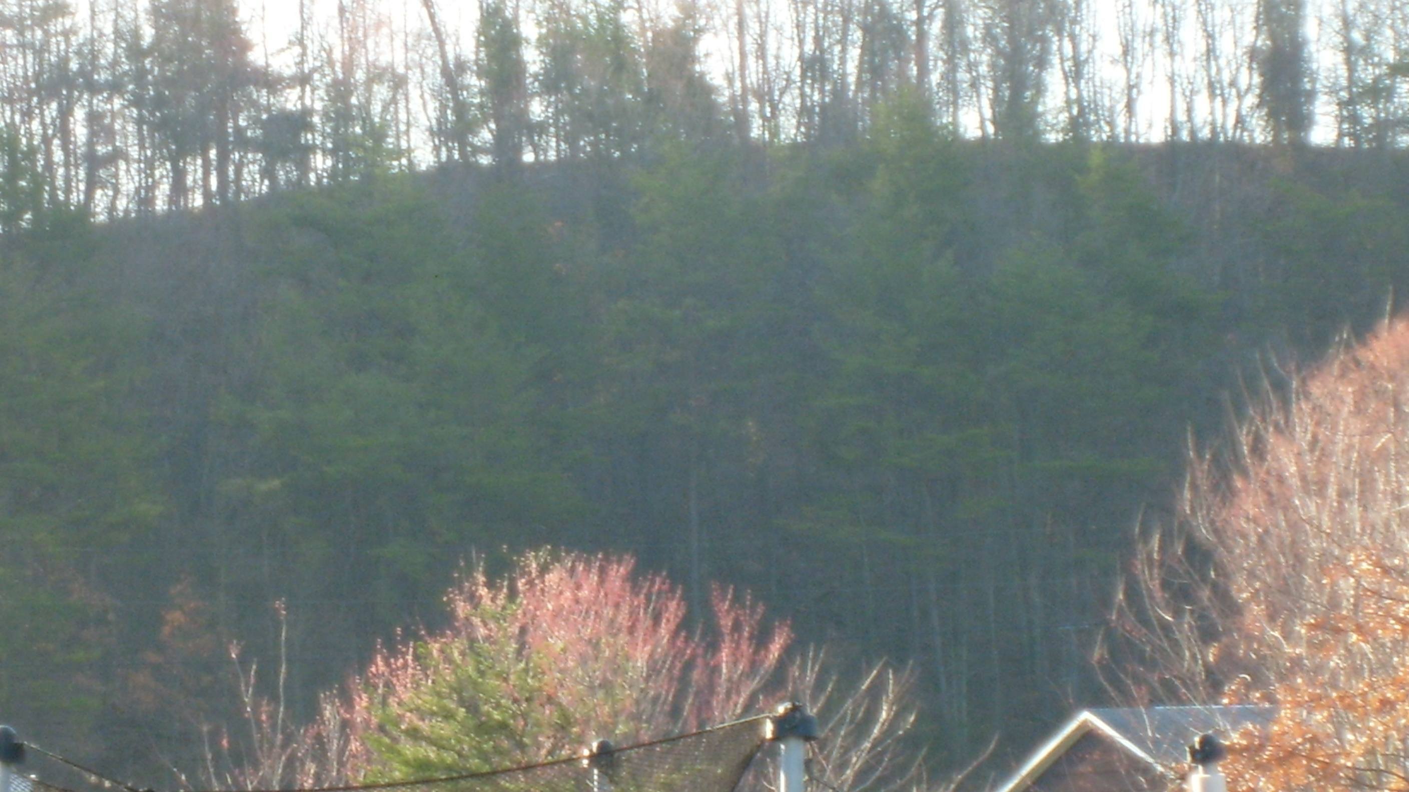

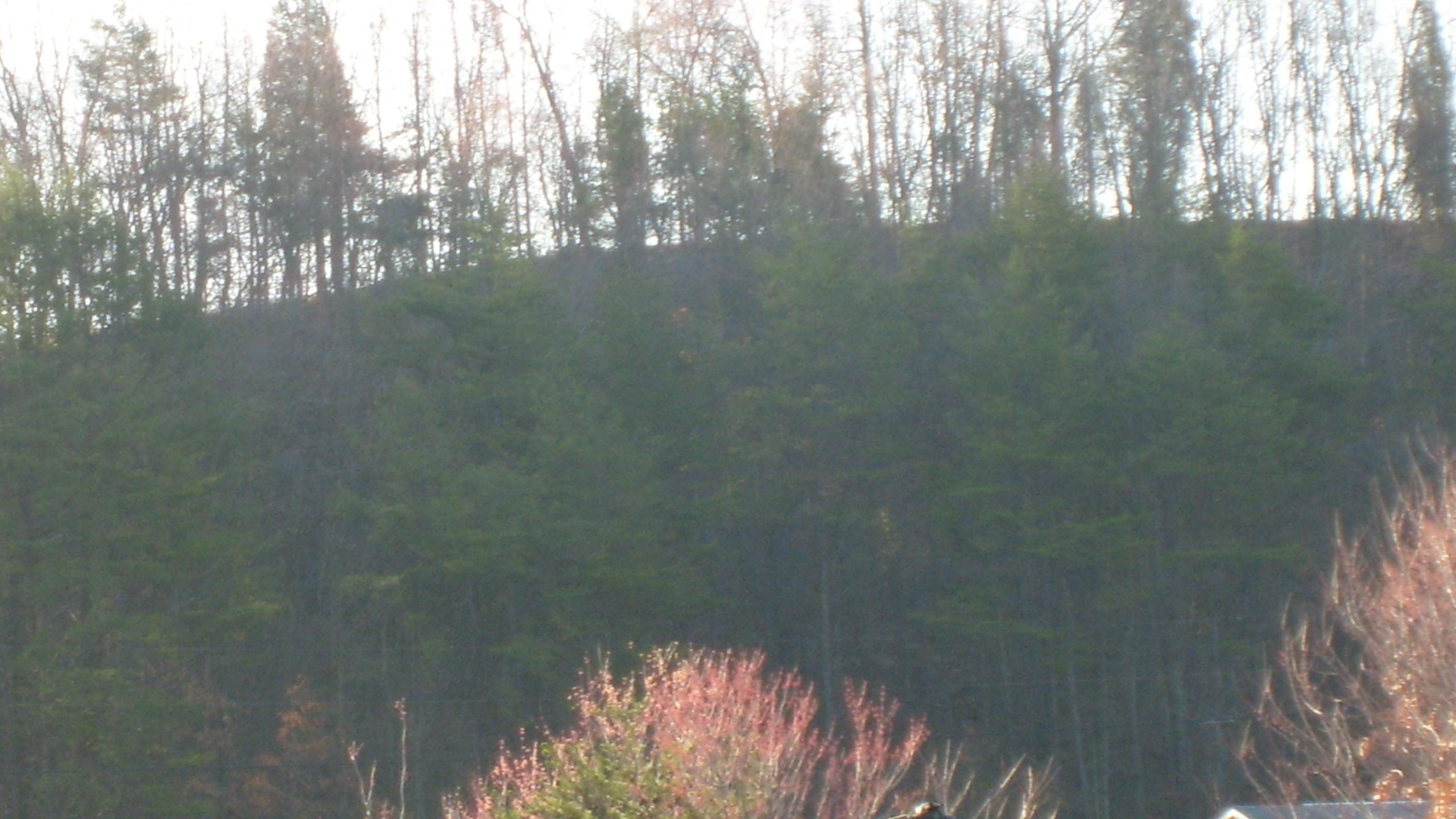

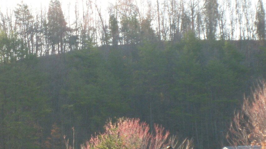

:mad: Still no signal from the Hispasat bird! I think that I have a hill blocking the signal from the satellite! I just hooked up a meter to it and nothing! It is around the arc in the right place, just no signal not even a bit!
:) I am attaching pictures of the hill in question. The second picture is what the LNB sees! The hill is not that big or tall but I guess if that bird is sitting up there father back in space it is enough for a small hill like this to block the signal!

You may have to get your shovel out and move some of that hill:D Its hard to tell from the pictures but it appears the rooftops I can see are significantly lower than the top of the hill in the background. There is a transponder or two on 43.1W can you get any of them?

Just a weird thought!!! Can you take an inclinometer and a piece of conduit, put the conduit on some kind of support (sandbags on a table or???) set up the elevation and azmuth and bore sight and see if you clear the hill? If you hit the hill, you will know how much you have to blast away to get LOS for YOUR satellite! (Well maybe not that drastic) But, at least see if the hill is really the problem. For some reason, optimism gut is saying you can see over it!

Can you take an inclinometer and a piece of conduit, put the conduit on some kind of support (sandbags on a table or???) set up the elevation and azimuth and bore sight and see if you clear the hill?

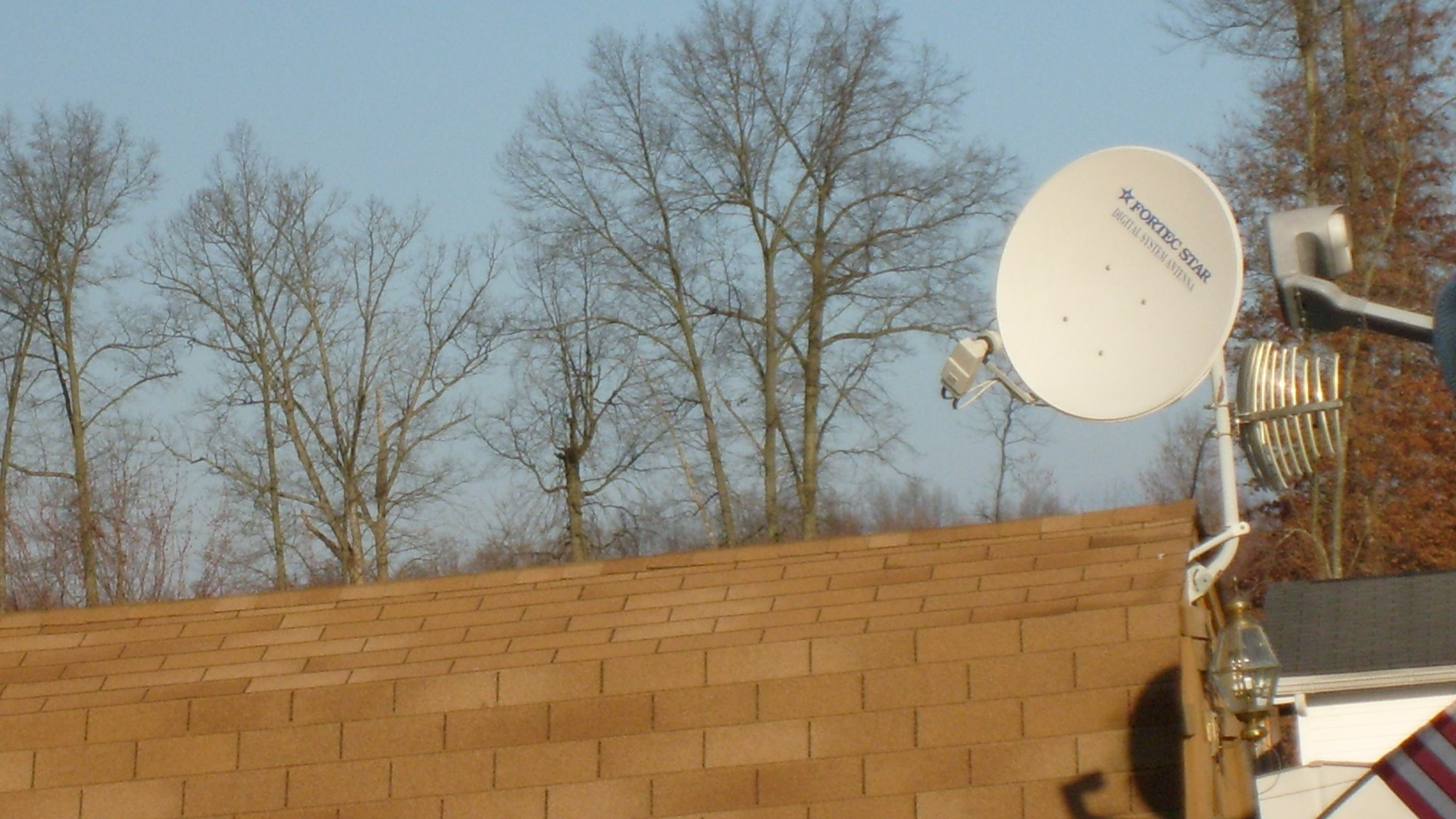

I think that I am going to try another dish on top of the house! The house is a bit taller than the pole I have mounted on my out building the dish is already on! I am looking for maybe an old Primestar dish or a Globcast World Direct style dish or maybe a DIRECTV World Direct 36" Elliptical though for the sake of neighbors! I have so far 3 dishes out back!
:yikes They will think I am scanning for aliens when I get a C band bud sometime this year!
Low profile dish and a bit taller pole is what I am hoping for! I have my motorized setup on one of those tall Skywalker brand poles already; it is about 4 inches taller that what came with the Fortec Dish! (Known as the SuperDMount Like Sadoun Sells!) It is designed to get your dish taller above the roof on your home. I think they are being sold for the D* plus or the SuperDish 121 or the SuperDish 105.
:) I bought 2 of them 3 years ago for a great price and I am glad I did! I did the Inclometer thing and I think if I move another dish closer to the front of my home, I can get a LOS for that bird over that darn hill!

any dish 76 cm or larger will work. I use to use a Starchoice 75e dish which was 37x27 and that worked fine. Due to my northern location, some of the transponders didn't come in the best (that and also being at 9 elevation for the dish which pretty much made the dish face almost level to the roof. Most of the muxes came in around 55-60 on the Pansat 9200 which the meter can read low. In the pic below you can see how low the dish looks. I had to turn the mast around 180 degrees and its not level but it worked.
I know of people who used 80cm up to Primestar dishes for that and they work fine.
