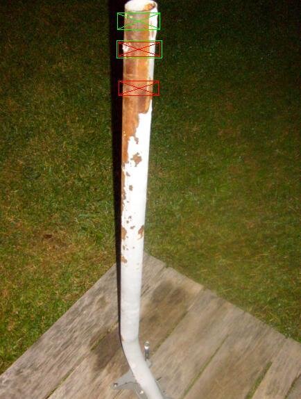

I must say fighting with the 3ABN dish did pay off in some aspect! After replacing the pole yesterday with the Skywalker twin pole I purchased three years ago (I bought two) I noticed better signal and quality bars on all birds and transponders on the Fortec Star 80 CM I put back up after taking the 3 ABN dish down tonight. Since I noticed a big change in the 61.5 bird of stronger signals I decided to spin the dish around to Hispasat and see what changed if anything. I can say the move from where the motor sat on the pole to where I put it now on the new pole made the difference! I have Hispatsat 30.0 W now! On transponder 10.883V Cuba vision I have 94 % Quality bar!
All the channels come in very strong! I was beside myself to say the least! Now, nothing here has changed, the dish is the same as I tried before, the pole is the new poles twin so height is the same, all that changed is moving the motor 3 ½ inches to the top of the pole! I guess that inches in height do matter when trying to see satellites! I done all the things in the thread before that you guys suggested and they never worked. I did do a bore site from my dish to the hill and it barely passed that test but the motor move did the trick! I want to thank all the guys who helped me on this dilemma and the fix was very simple but I never would have thought that a little over three inches would change much. Who would have thought that?
I guess if some of you guys have similar problems try going to the top of your pole mount as possible and see what that does. It worked for me! Starman, I really appreciate your input as well. You and the other guy's were a big help and I never really gave up on this one other than put it aside for awhile.

Picture:
Red where the motor was mounted three years ago to today
Green is the 3 ½ inch move to the top of the identical pole

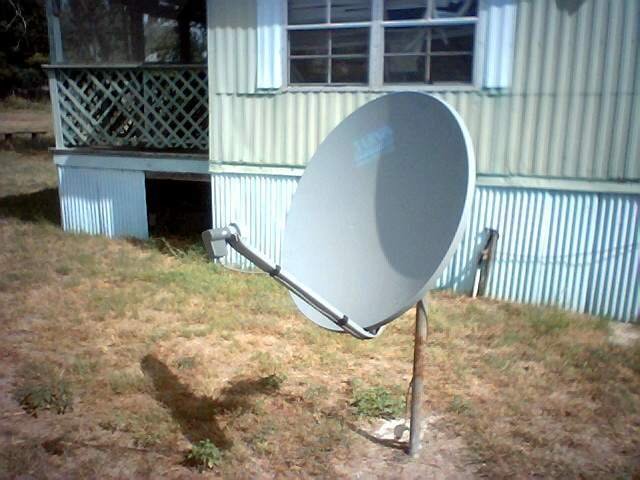

That is bad news about your 3ABN dish, here is a picture of my 3ABN dish aimed at G10R. I had the Invacom QPH-031 mounted on it, this is the one that caused the arm to sag. I wish I would have kept the Invacom and put support arms on the dish.

Gary Z, that doesn't look like the current Azure Shine dish that 3ABN ships. Did you buy it recently? The one they have been selling (they just stopped selling dishes this month) has the LNBF arm reinforcement struts, and gives me no problems with the Invacom Quad.

I bought the 3ABN Dish about 5 years ago.... that model does not have the LNBF arm reinforcement struts I wish it would have... I could have made some but didn't think about it until after I sold the Invacom
