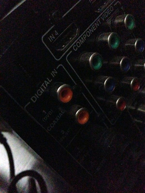

Hi guys, making this thread as I'm a little lost at how to do this. I wanted to know what my options are to hook up my HR34 to my Onkyo AVR. I had Comcast and with that I'd easily get 5.0 Dolby sound via digital optical in but these hr34's don't have that input.
Which wire(s) do I need to get surround sound? I have attached an image of the back of my receiver its up to 7.1 and HDMI.

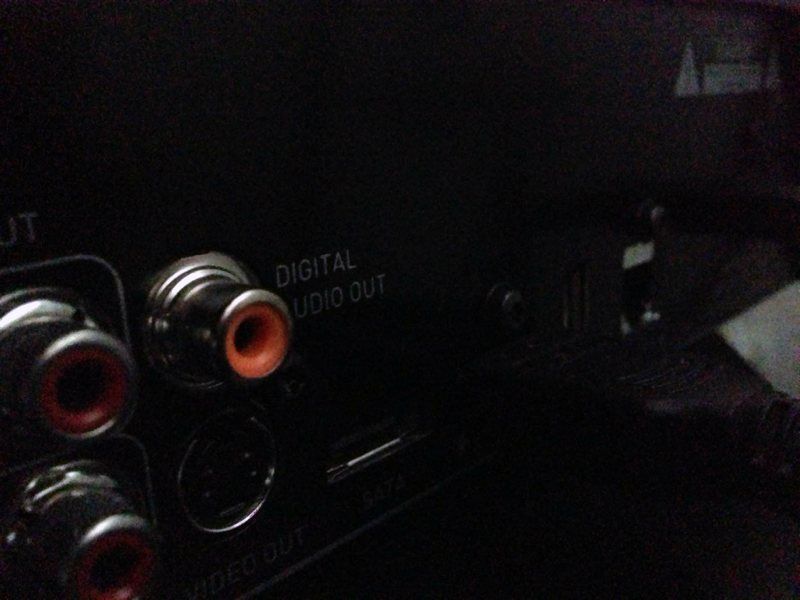

^See my post above, I wouldn't be able to watch cable/Directv without having my Onkyo AVR turned on though right? I don't want to HAVE to have my receiver powered on at all times. I dont see coax/optical on the back of my hr but do see this orange colored audio out what connection is this?
You have digital coax on the A/V receiver so why not use that? Or you can use the digital coax output from the HR34 and then a coax to optical converter, if you want to use optical input on the A/V receiver.

Hi, no unfortunately it doesn't if I have the HDMI into my receiver I'll need it powered on in order to watch TV. I want to like I said have my audio separate if possible so I can use surround sound as well as my normal TV speakers. I was looking at the connections (see pics) would it be as simple as getting a cable like this to achieve that?
http://www.monoprice.com/products/p...=10236&cs_id=1023603&p_id=2681&seq=1&format=2
The left is my receiver and right is the HR34 the connections to me look like an old RCA jack =\

IMHO you should use the optical audio connection between your HR34 and the A/V receiver (the connections you show on your pics, and the cable from monoprice). And HDMI from the HR34 to the TV.
Great, yea thought it would work just wanted to make sure. I got a bunch of Optical's lying around but never dealt with Coax.
@raoul I think I'll go this other route will deal with less wires and hopefully still achieve Dolby sound.
