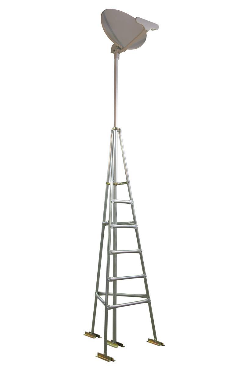

5712.jpg Kiss that LOS problem good bye! untill the trees grow taller. The distance for your drive way would cost a lot and to find the right people to do it right is going to be tuff. Your best bet is to find a location on your property that it wont be an issue like the peek of your roof or chimne or just line up the birds with dishpointer and top those trees. To split the satellite on 3 dishes is going to cost some coin and also requires the corect tech to do it. Dont think the normal direct guy would even think it could be done.

Of course, there is one other option
Erecting An Antenna Tower
Costly, but if you want HD really badly, it is an option.
Again though, do not expect your average tech to install it or ever service it, but it will less likely need servicing if properly installed.
