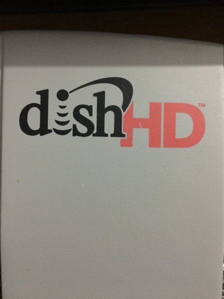

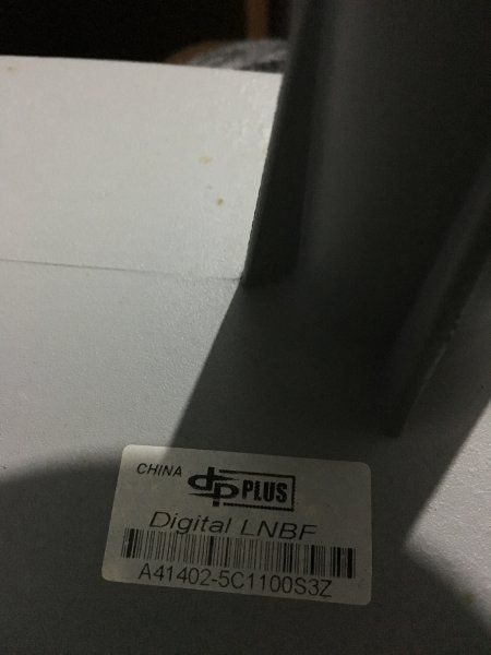

Ok did some checking and see that I must use some sort of "dph hibrid".
I'm looking to buy a 1000.2 Hybrid Triple LNBF. This mean I would not have to buy a switch but will still need the hub correct?
That's a western arc LNB in your picture. It looks like you're in the Virgin Islands so I don't think you want to point at the Western Arc. You probably want to point at 61.5 and 72 so you will need an Eastern Arc Hybrid LNB and a single hub or a hybrid tap to connect the Joey.
Thanks! Yes I'm in the Virgin Islands. I am looking for information to setup a satlink ws-6933. I'm doing this for myself and can't afford one of those expensive units.
Sorry, don't know about the satlink. Hopefully somebody else will chime in. Good Luck.
I have checked and I'm getting 110 and 119 echostar 14 west as the the sat to use. Which is what I used with my 722dvr. So why would I need an eastern arc lnb? The line is getting a bit blurry.
