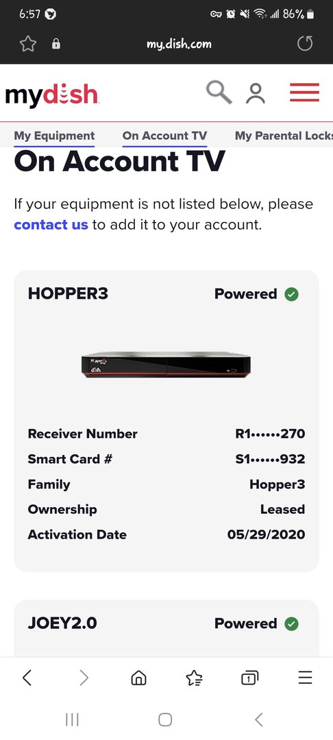

This Hopper 3 worked for 4 years almost to the day.
Called support,
Replacement H3 on the way.
We awoke Monday to hardrive failure.
Thankfully, the current software sllows tuners to function without harddrive. At least for the H3 itself, all joeys show menus, guides, ets, but no channels video/audio.
So, H3 works as tuner for 'live' mode only.
No dvr functions. No rewind. No skip commercials. No timer list of programs we regullarly watch. So, we have to try to remember 'what do we usually watch the next couple days and either watch live or wait until stream avail via network app.
