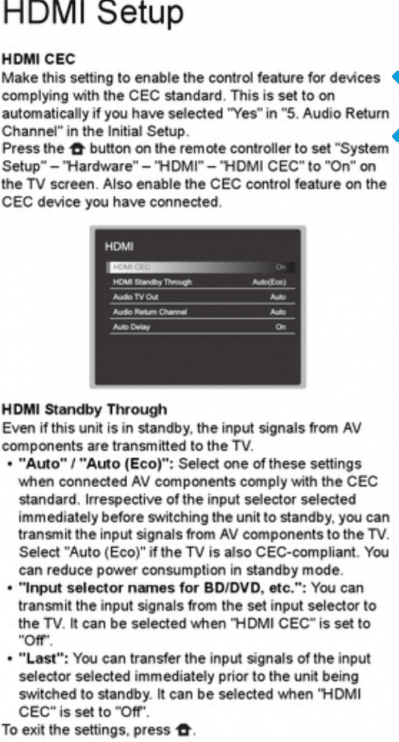

In the meantime, your manual talks about "HDMI Standby Through" which, if turned on, sounds like it could cause the Hopper standby screen to appear on the TV even after you think you've powered things including the Pioneer receiver off.

"HDMI Standby Through" actually allows signal throughput to the display when the AV reciever is in standby. I really don't see the point of it either as I use my AV Receiver all the time with my main system in the living room. I certainly wouldn't want my display to be on and showing the Dish standby screen when everything else was off.
