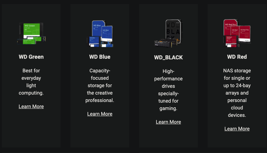

I learned to hate Seagate ages ago. Major failure rate. It cost me a fortune to replace all the drives in all the Apple gear who used them exclusively back then. Now I only use Western Digital and have a "Black" ready for my owned H3 since it's been whining and making noise since I got it. This being the second one, since the first H3 made the same noises and it was exchanged. It's only a matter of time. . . . .
Thanks for the reply. So when you say "Black" you're saying a WD20EURX? That seems to be the only other drive model than the Seagate that I've seen (in the forums) as supported by the H3. Or do you have more current info that you're willing to share?

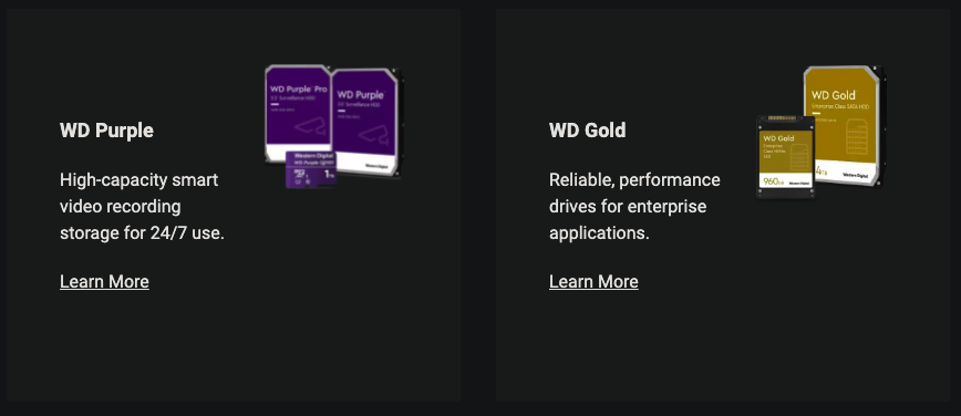

WD Black drives are designed for video gaming, perhaps the WD Purple Surveillance drives would be better for DVR purposes.
IIRC the drives in the Hopper 3 are not limited to certain model numbers as they were on earlier machines, they are more plug and play.
What Color do I need?
