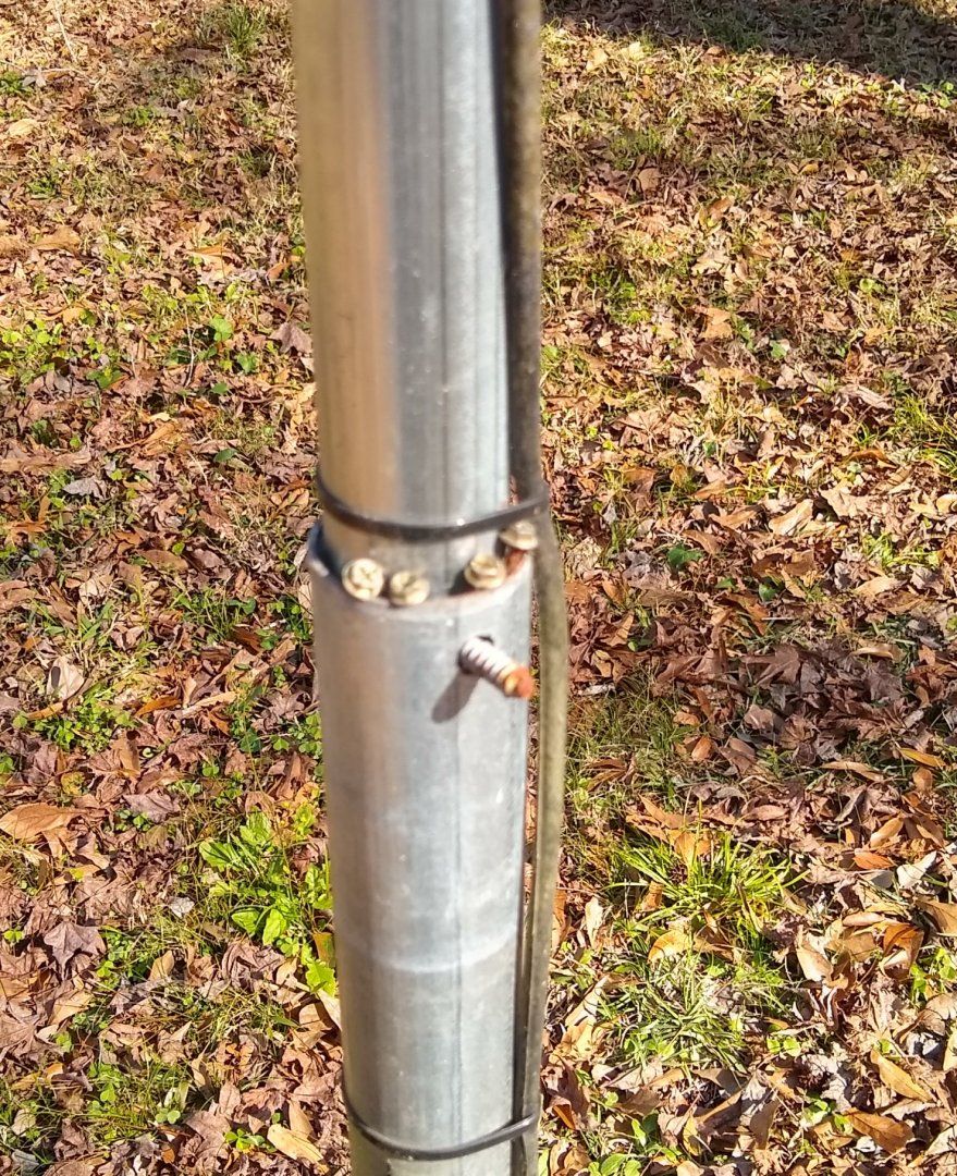

A little more info. I went to check the dish, the installer a year ago used an existing pole from an old DTV install, pretty tacky install.
I do have LNB drift detected, 0x49, 0x164, 119 (e0) (o0) and same for 110. My Dish angles according to Dish should be Elev 48 Skew 58 Azimuth 140

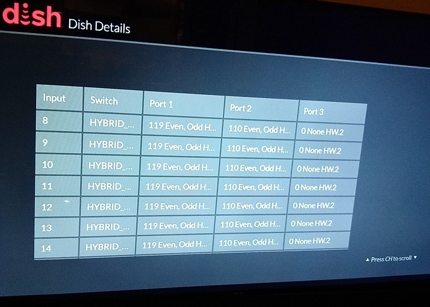

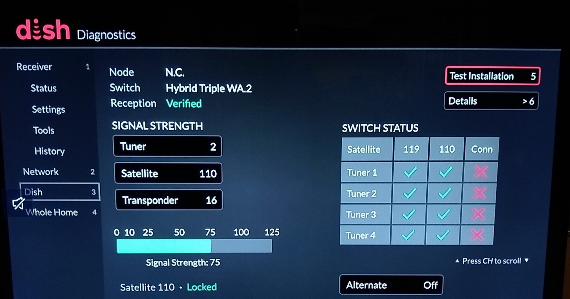

In the Dish signal strength, I get 78 on 129, 78 on 119 and 75 on 110. In the switch status on the right see pic. I've gone out to the pole, pulled the carriage bolt and self tapping screws, put a 5/16 bolt through it and tightened it down until it didn't twist. I did minor adjustment to the azimuth since it went off a bit. The current signal strength of 77ish is better than it was, IIRC it was 50ish.
Now since I've done the adjustments and restarted I've lost the SD channels in the 804x range and still don't see any HD channels in the 524x range. So no locals at all from Dish, I've reinstalled the AirTV adapter, then added our locals. At least I'm getting true HD signal from those. Tech is coming Friday if I can't get this resolved by myself.
The subs they use (both DTV and Dish) don't seem to want to fool much with good solid mounting options. When we moved out here 10 years, we got a free new install from DTV. Maybe a year later I went through the same thing as now, losing signal a bit. I pulled his pole out and mounted it in concrete. Now Dish comes over and uses my old pole but rigs it so it lasts 1 year.

Looking at your picture, you are not receiving 129 at all and that is why you are not getting your HD local channels which reside on 129 or 61.5 if you had an Eastern arc dish.
That strength of 78 on 129 is a false reading. It is picking up the signal from 119 instead, when it is looking for 129. (The signal strength from 129 always tends to be quite a bit lower than the other satellites. A signal strength of around 50 from the 129 satellite would be quite good and usable.)
On the screen in your picture, select that Test Installation button. Since you have readjusted the dish, you need to do the Test Installation, to get your receiver to actually update properly with the satellites you are actually aimed at. I am guessing that the last time the Test Installation was done, you had completely lost signal from 129. (Or possibly, the signal was there, but the strength was so low that the Test Installation did not find it.) Now that you have peaked the dish, the Test Installation should find 129 again. If it does not find 129 after doing the Test Installation, then it is possible that you moved the dish too far, and you are picking up the 110 and 119 satellites from the wrong individual LNB's (eyes) on your Hybrid LNB.

That's the tip I needed. But the tech is scheduled to be here any time now, and I got stuck drilling through both pipes to add another bolt to the bottom, I dulled my last 5/16 bit, have to root around for another.
