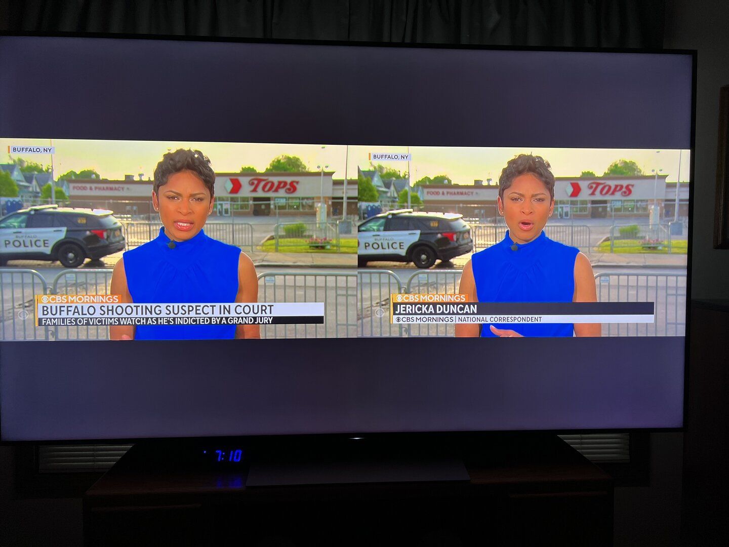

Here is a side-by-side I just took. The left is OTA.
OK. You are watching Dish satellite on a 75" TV. It's 2K resolution- because Dish has historically not used 1920X1080 for its HD, it probably is 1440X1080 so it might be a little softer than a 1920X1080 picture. If your OTA station is not bitstarving their picture, it is not uncommon for OTA to be sharper than Dish locals via satellite. The larger your screen is the more apt you are to notice small resolution differences.
