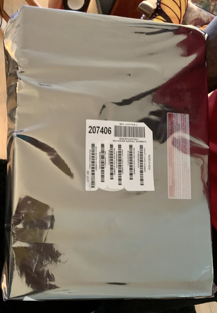

Ok so apparently I had them send me a new hopper - it wasn't new it was a refurbished..imagin that. Well I said ohh well and installed it anyway last night. It has been taking all day to recover recordings from the other one to this one. Just about 30minutes ago while it was on live TV the new one restarted. Now at this juncture there has to be a software issue and I can't be the only one having this issue.
I'm unsure what to do now other than watch it a few days see what happens once the recordings are finished recovering and if it continues call them up and demand a new one.
Very strange regardless.
