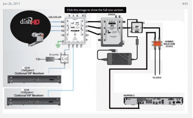

Well the installer is here and has to put up another dish. No way to do the H3 and my neighbor's 722 on the same dish. He said they can put in a switch for multiple H3's but not older receivers.
If he connects the dish to a DPP44 and then chains that to a DPH42 it will work.
2 dishes is usually better when practical but the above 2 switches will work, I've done it. :)
It might even work with just a DPH42.
You may be right, but he says it is impossible
He needs to study up:
I hate to say it, but most of the people on this forum are probably more knowledgeable than this guy. And this guy works for Dish corporate, he's not a sub. It probably involves more work than he feels like doing.
