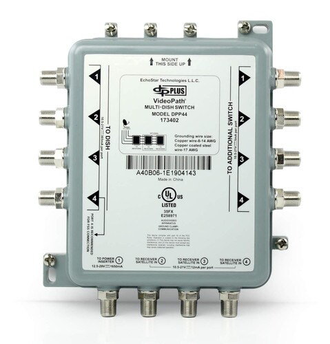

Would a DPP44 work?

There are only 2 outputs on a Hybrid LNBF. Port 1 goes to the Solo Hub or directly to the Hopper, if no Joeys. A Hopper 3 (And a Hopper Duo), when plugged in, "kill" the port 2 output. The Hopper 3 cannot run off of DPP Technology, which is what the 44 switch is.
Your best bet is put up another Dish with a DPP LNBF, or if you want to get exotic, switch your dish back to a DPP LNB (Which I assume you had previously since there are 3 cables) and run the 3 outputs (2 for Eastern Arc) to a 44 switch. Outputs 1-3 on the 44 switch to a 42 switch and connect the Hopper to that. the 4th Output on the 44 switch to the 211. It's an exotic setup. The new Dish would be less expensive. Also, on your diagram, the power inserter on a 44 switch can only go on port 1

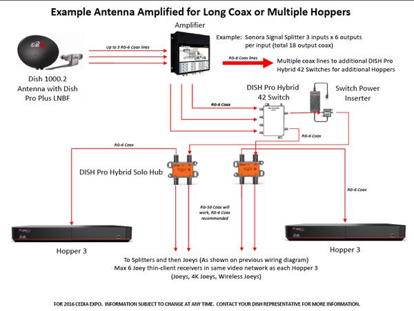

No, it wouldn't work. The way you're trying to do it is mixing 2 different technologies. It would be like trying to fit a Chevy motor on Ford Motor mounts..Now, just a hypothesis, but I wonder if using a Wally off the 2nd port of the 42 switch would work. You'd have to swap the 211 for the Wally, but that might work and yes, power inserter on both switches. This image for a 2 Hopper install, which is why it shows the extra Solo Hub
Funny you should post that pic. Just the other day I found the 2016 CEDIAv2 Hopper Wiring Diagram. Not sure where I got it and totally forgot about it when I did my dual H3 install. The only change, for me, is I changed the Two Solo Hubs to a Duo and no Amplifier.
