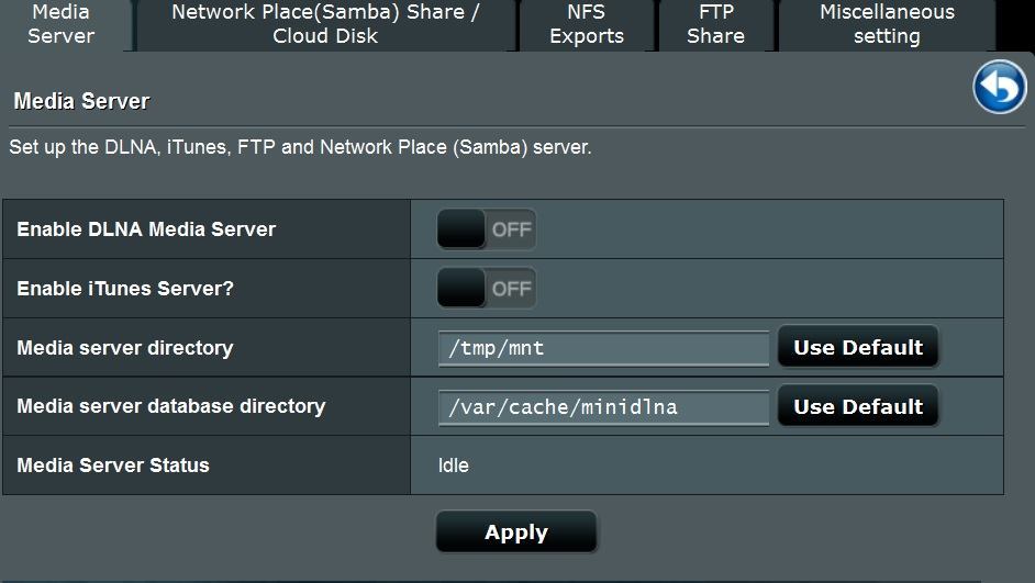

I'm pretty sure you can do it with the RT-N66u. I'm not sure if it's included in the original firmware, but if it isn't, it's included in the Merlin build. (I'm using version 3.0.0.4.374.32 but I don't use the DLNA feature.) You can get Merlin here: http://www.mediafire.com/asuswrt-merlin/#2324w3jh7e4q4
