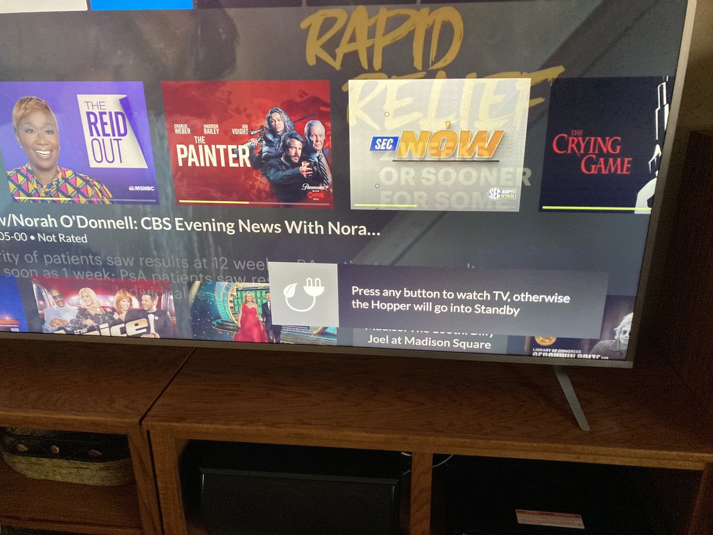

Just started using 54 remote after I broke my Harmony. It's set to turn on my soundbar, as well. Problem is, when the Hopper sarts, there is no sound from soundbar. Then, a graphic like a power plug comes on bottom right saying to press any button to watch TV or Hopper will go into standby. When I press the button, the sound comes on. How do I stop this? I have yet to find anything in settings, tried the obvious power and remote choices. At a loss. Gonna have to fix my Harmony!!!

Well either your Hopper isn't powering down or you hitting power Twice or it's sending two signals because that is definitely the popup for waiting to go into Standby mode

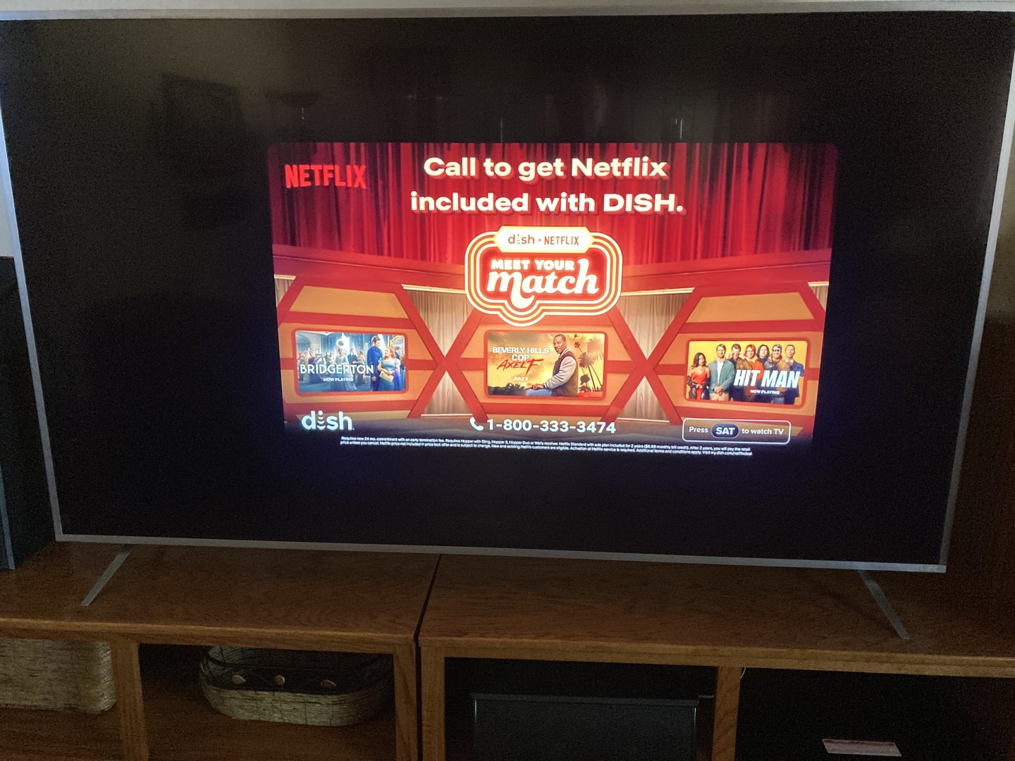

This is the normal slate when in standby:
This is what KAB is seeing:
