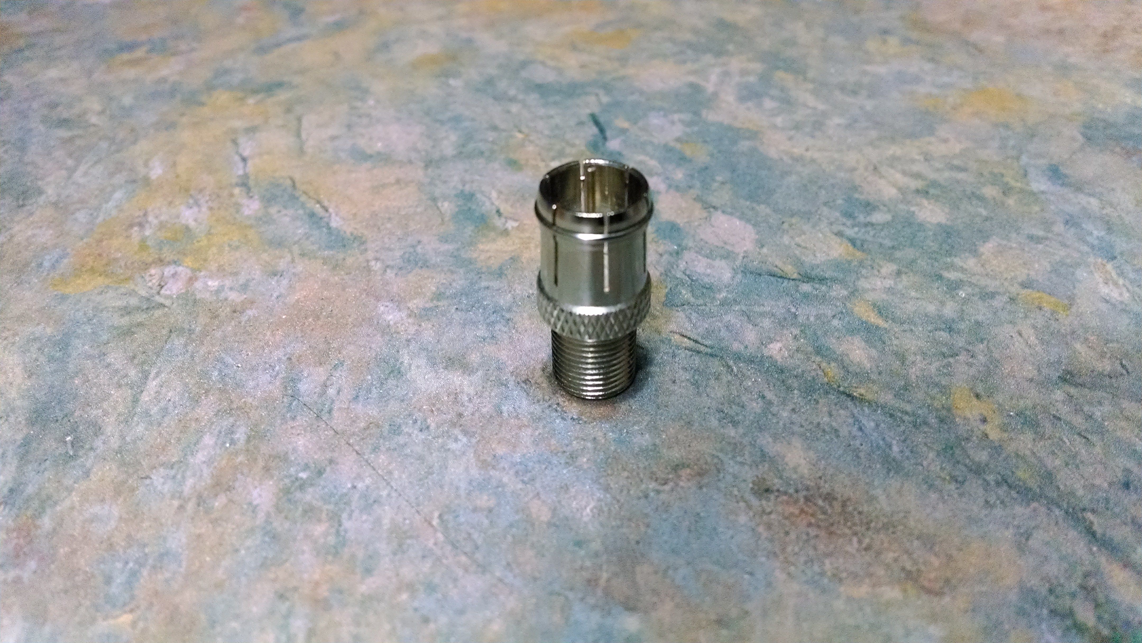

The Hopper remote antenna uses an M10 connector. There are M10 extension kits but I haven't found anything that converts the standard F-connector to M10 yet. The UHF 2G uses 2.4GHz ZigBee technology. So the ideal antenna length would be 1.23 inches, 2.46 inches, 3.07 inches or 4.92 inches. Longer is better, but they need to be those exact lengths for optimal performance. You could buy Dish's extender (P/N 169178, ~$10 I believe,) cut off the other end and attach a standard F-connector. Then you can extend the antenna in the same manner as the 722.

I am going to try out powered rabbit ears with a slip on F-connector like in the pic. The connector is a little hard to press on the Hopper M10 male treads but I was able to get it on, fits nice and tight. When tired a-- kid gets up sometime today I will get my rabbit ears from his Hopper and try it out. When I had powered rabbit ears on my VIP722, it worked great. I could control the DVR way outside in the yard. I need better remote control coverage for a remote TV in my man cage (garage) to my Hopper in Great Room that has RF modulator. I have to find sweet spots in man cave to get it to work to the Great Room Hopper that already has an attached UHF extension antenna. The part number for the UHF antenna extension kit that I have is 169178. Still have two new ones in the bag that I didn't use. The extended antenna just improved things a little better. I am hoping that the rabbit ears like Hall installed provides better results. Will post back how goes it, hopefully today.
