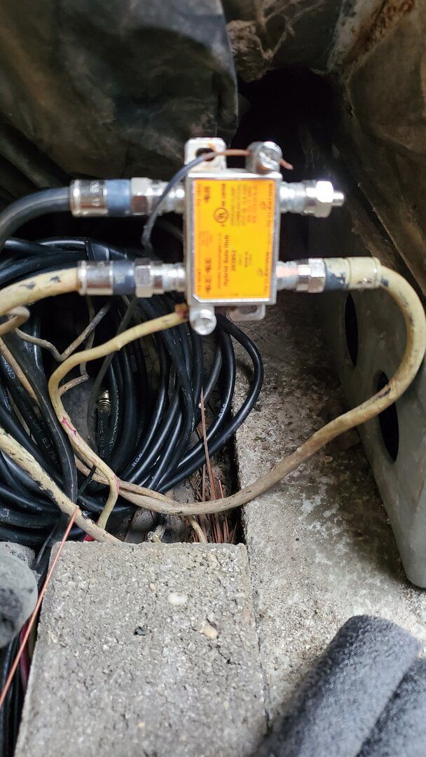

Separately, which node do you have? Depending on the answer, are you sure you put the cables in the right place? Maybe share pictures?

This is what I'm calling a "node" and I'm swapping the coax cables labeled "Client" with the one labeled "host".
Again, I apologize for another dumb question but I'm a newbie and haven't quite mastered the search function.
