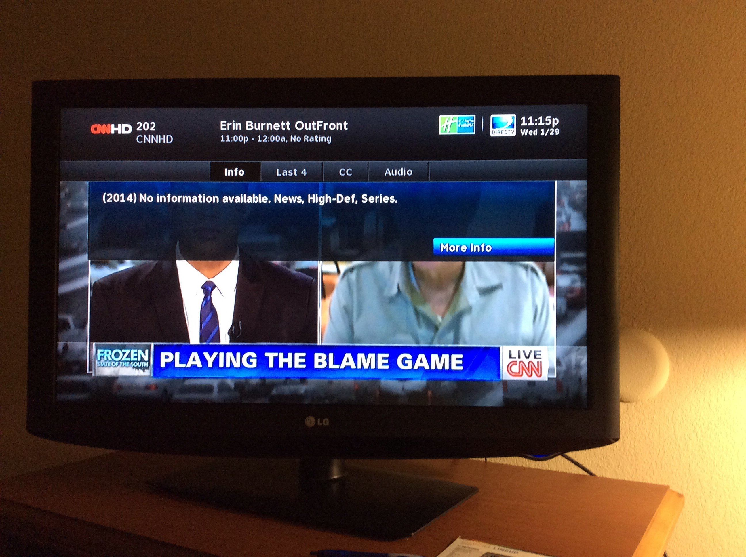

It's interesting that a lot of channels show up in the guide but some are missing like BTN and FS1. But if I tune to those channel numbers directly it works.

There's also a Holiday Inn logo next to the channel logo:
