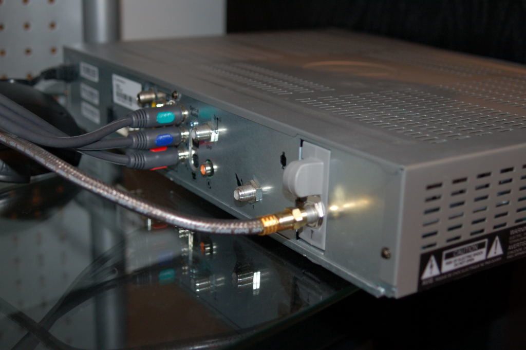

Airwaves, what kind of software is your voom box running? I think 6.20 was the last version they sent us. I would also remove the diplexer and wire it directly into the antenna input. I'm guessing yours is an activated box since you have gotten to the scan for channels menu. Have you tried adjusting your antenna? If so have your numbers improved any? One last thing, when you put in your stations rf # be sure to hit ok on the remote.
Here's a picture of the back hookup.

2. Make sure you are connecting to the right-most connector (looking from the back), exactly as shown in the snaggerbob's picture above, not to the UHF remote antenna connector, which can be easily confused for the OTA antenna connector.
