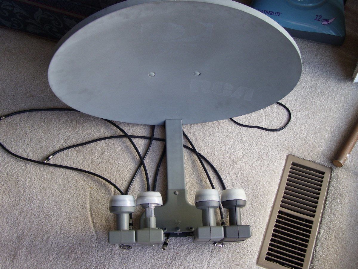

You can also get an eleptical dish to his 110-148, I saw a picture of someone who did this once, but they basically used cable ties to keep the LNB's in place, so if you got a huge dish like Iceberg's, you could probably get that going and would probably get better strength... 148 and 61 are mirrored for int'l stations, but not HD... Still, D500+ or D1000+ is probably a better bet...
yep. Just did that yesterday. Took an old Phase II dish (that the LNB's can be removed) and put 4 LNB's on it
148 was off the "w" adapter
dummy one at 139 (basically there to hold the 148 LNB)
middle was empty
119 to the right slot of the "W"
110 off the "w"
got decent results on all satellites :)
The dish got taken back down yesterday because I couldn't get it to work properly with the switches. Since it is just 3 duals I tried a SW21x/Sw21 combo (which didnt work) and a SW42/SW21 combo (which the SW42 is bad).
When I hooked it up to the FTA box to see what signals I would get
all 119 TP's (spotbeams excluded) were between 90-99 on the Pansat 1500
on 110 it ranged from 66 (TP3) up to 99 (not including spotbeams)
148 TP's were around 75
I even threw one in the middle for 129 and got between 60-75 on the active TP's ;)
