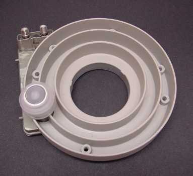

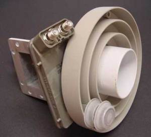

Ive seen references to modifications of scalar rings for C/Ku that have holes cut in them for adding additional LNBs beside the traditional Co rotor.
I really dont want to hack up my new scalar ring to experiment but wondering how well it works.
Im sure its not as good as mounting directly on center but since I have such a good signal with the 10 ft dish I could probably lose some and still be OK.

Has anyone tried this with success?
It basically shows that RHCP AND LHCP can be tuned in thru Skew.
and also that the additional LNBs for Ku can be added to scalar ring
but must be perpendicular to polar axis.
I don't recall where I found these pictures, but I think there's a commercial product like this.
Looks like a stock DBS (circular) LNB with its plastic case removed.
Note that it would still require you to move your dish a few degrees to bring the circular LNB to bear on a bird.
How far, depends on the spacing.
And I still favor the stand-alone 18" dish... :)

The co rotor2 wideband will do it has a Teflon block kinda like the pic I posted.
I dont have the nerve to cut into my new scalar ring but if anyone has one for a co rotor or anything else that will work LMK Id like to get a cheap one and try it.
