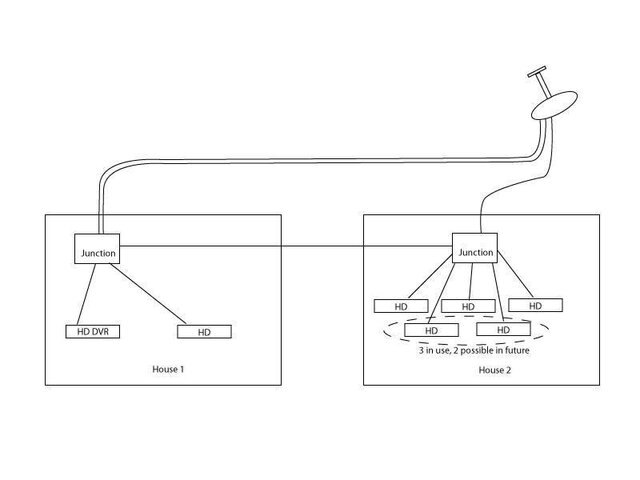

I've attached a diagram of what I need to do. I've never done such a large install and not sure what I need or if it's even possible without running new wires.
Currently there is a slimline dish mounted on a pole in the back yard. There are 2 lines going to house 1 where there is a HDDVR receiver. In house 2 there is a standard receiver on one line from dish. There is also a line connecting the two houses.
Property was sold and new owner wants two receivers in house 1 and three in house 2, with the option of a fourth and fifth in house 2.

SWim dish, two way splitter, one line to house one, one line to house two. (Sounds like it's two houses on one piece of property). Another splitter at house one, splitting again, twice, one line to DVR, one to HD receiver. (3 tuners total). House two, another splitter, one line to each receiver. (3 tuners now, +2, 5 tuners total) So that will max out the SWiM LNB with 8 tuners. If you need to go above that in the future you would need to go back to a standard slimline LNB, run four lines from the LNB to a SWiM 16 or 32 multiswitch. Then reinstall the single lines to each house. You could put additional splitters on at each house as necessary.
Joe does have a point about the electrical systems. If they are not on the same drop from the street, you could have some ground issues. Not likely but possible. I would not worry about it, just put the power inserter for the SWiM on the same house as the bond you ground your system to. If you run into ground hum or signal issues, you will need to add some ground rods along the run to the second house. Should solve the problem. You could also put a dish on each house and solve the problem completely.
By the way, unless you install a band stop filter at the entrance leg to each house, if you have MRV (whole house DVR service) both residences will be able to share recorded programs.
First off house one will not work if setup like graphic shows. At least 3 lines are needed for 3 tuners (dvr2,other box1) KAKU IRD. Only way to use just one dish (besides SWM) is to run 6x8 with 4 lines coming from ODU to switch and 3 lines available for house 1 and 5 for house 2. Is this for a camp or rental property?

All you need at the dish is a two way splitter, one of these will do:
Notice one side of the splitter is DC passing. Make sure that side goes to the house with the power inserter. The power inserter powers the LNB on the dish, so yes it will power the whole system. Make sure all your splitters are green labeled in case you want MRV. SWim is easy, plus it has the added benefit of a single line to every receiver including DVR's. Make sure all the receivers are SWim compatible.
